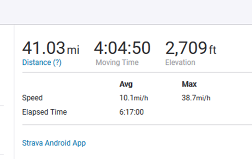

Maybe in your experience - but not in mine ( only 320 miles so far) - I carry a 400wh spare battery and my last 2 rides were IRO 40 miles on the same terrain, but the first ride was at 12.4Avg MPH and the second was 8MPH average. and on both rides the 500wh battery lasted 31 and 32 miles, respectivly.

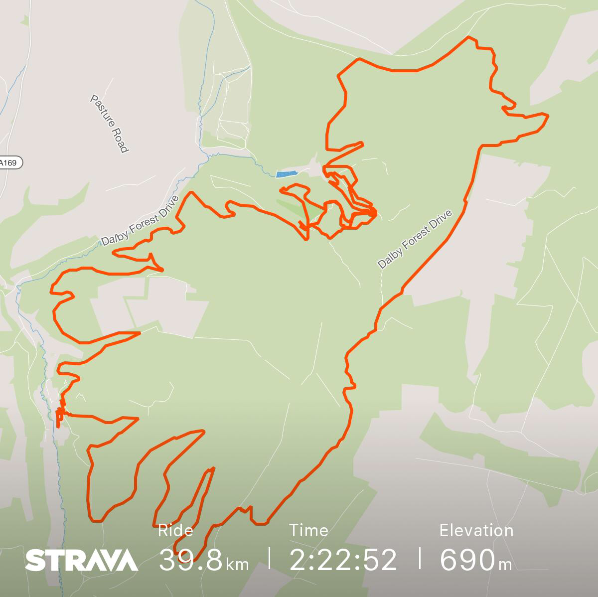

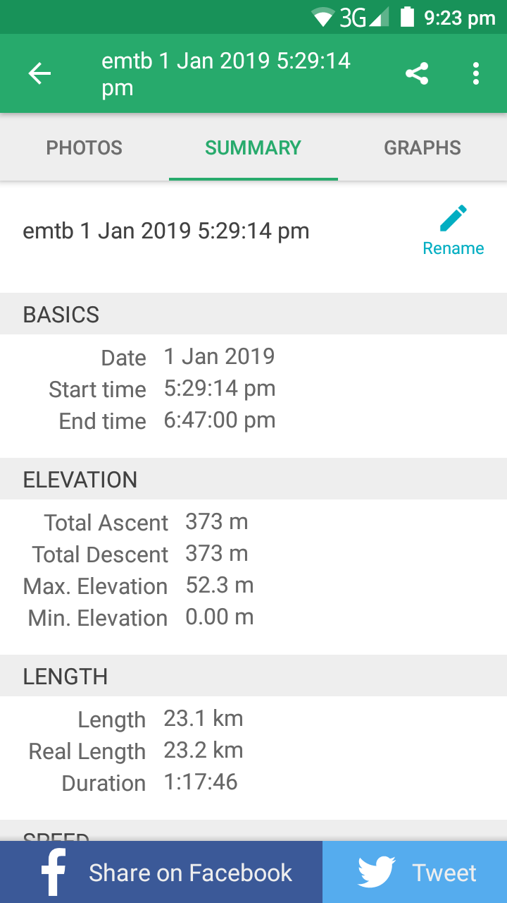

Daley forests Full red and black just went onto last bar when I got back using eco for forest track climbs and EMTB for the single track

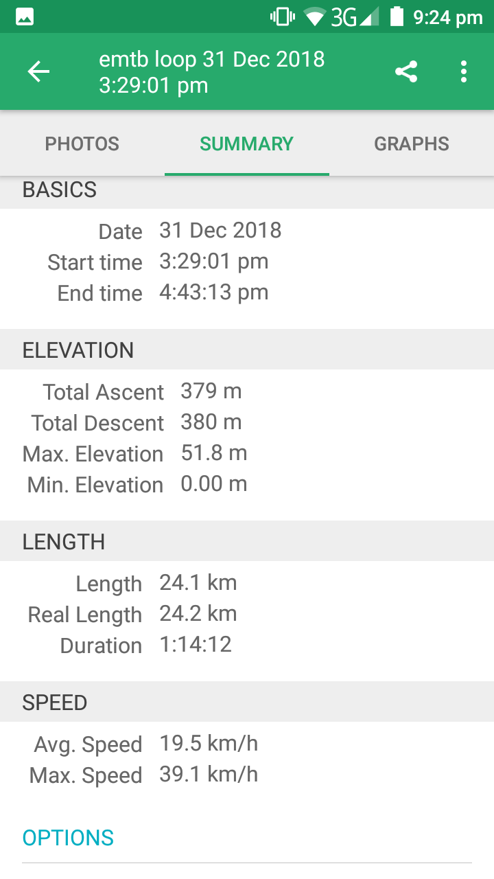

Im a newbie with this so be kind, happy to provide any info to help compare! the link takes you to the wikiloc of my latest ride... Around Tebar, my local area

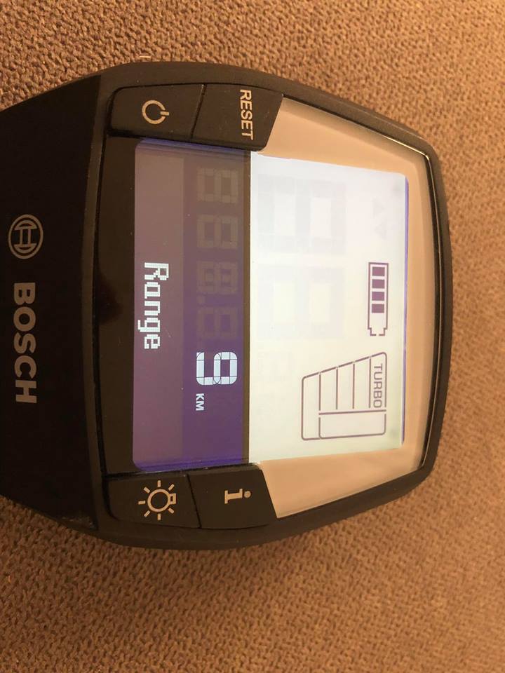

Started out with a full charge and the image shows remaining distance and charge....
It doesnt seem to tally, just a few Km available but 3/4 charge!
Im confused...
The remaining range is based on how you have been riding the bike. If you've been blasting up hills in Turbo it will show the range as if you continue to do so.

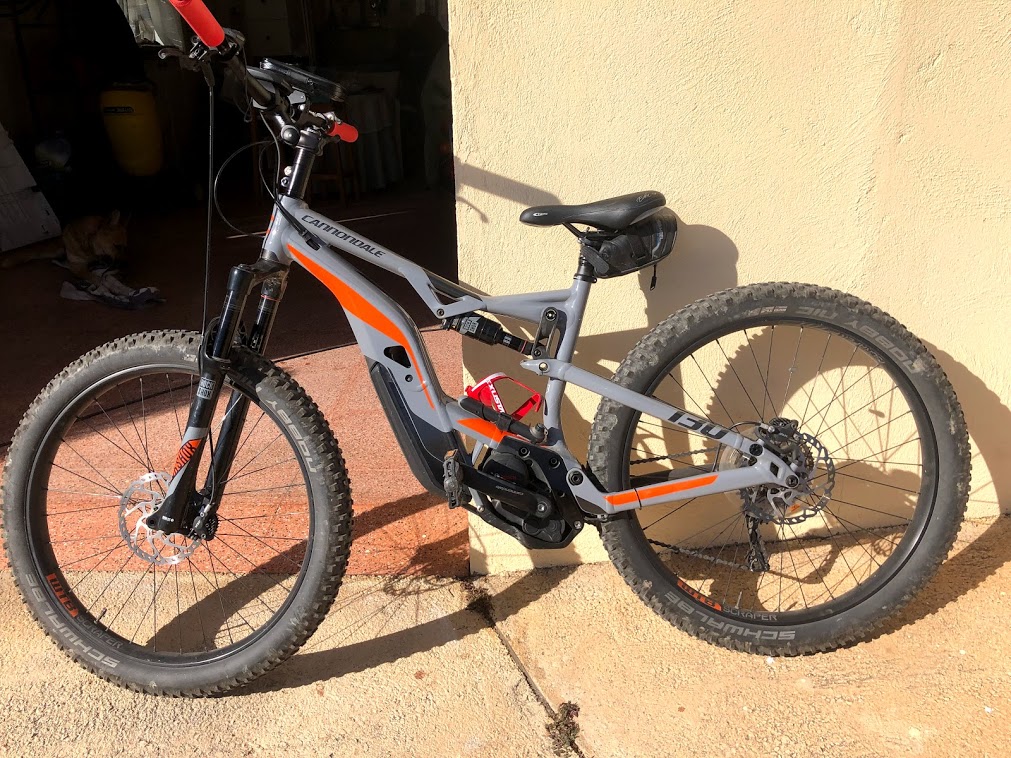

This surprised me it was a back to back ride with a 2019 fsr carbon levo and both our batteries died within a few hundred yards of each other, we both did a fair few miles with the power off to get this milesage though, there is nothing like being 10 miles from home and only having 3 miles range to get you saving the power for the hills.
