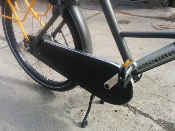

According to Quantum Bike Chain Mechanics, you need a fully covered chain. Then your chain will exist in the superposed states of rusty and not rusty at the same time (no reference intended to @RustyMTB or @RustyIron or @RustyMojo- though arguably they should be the experts on this kind of thing) and it's no longer a thing to worry about.
