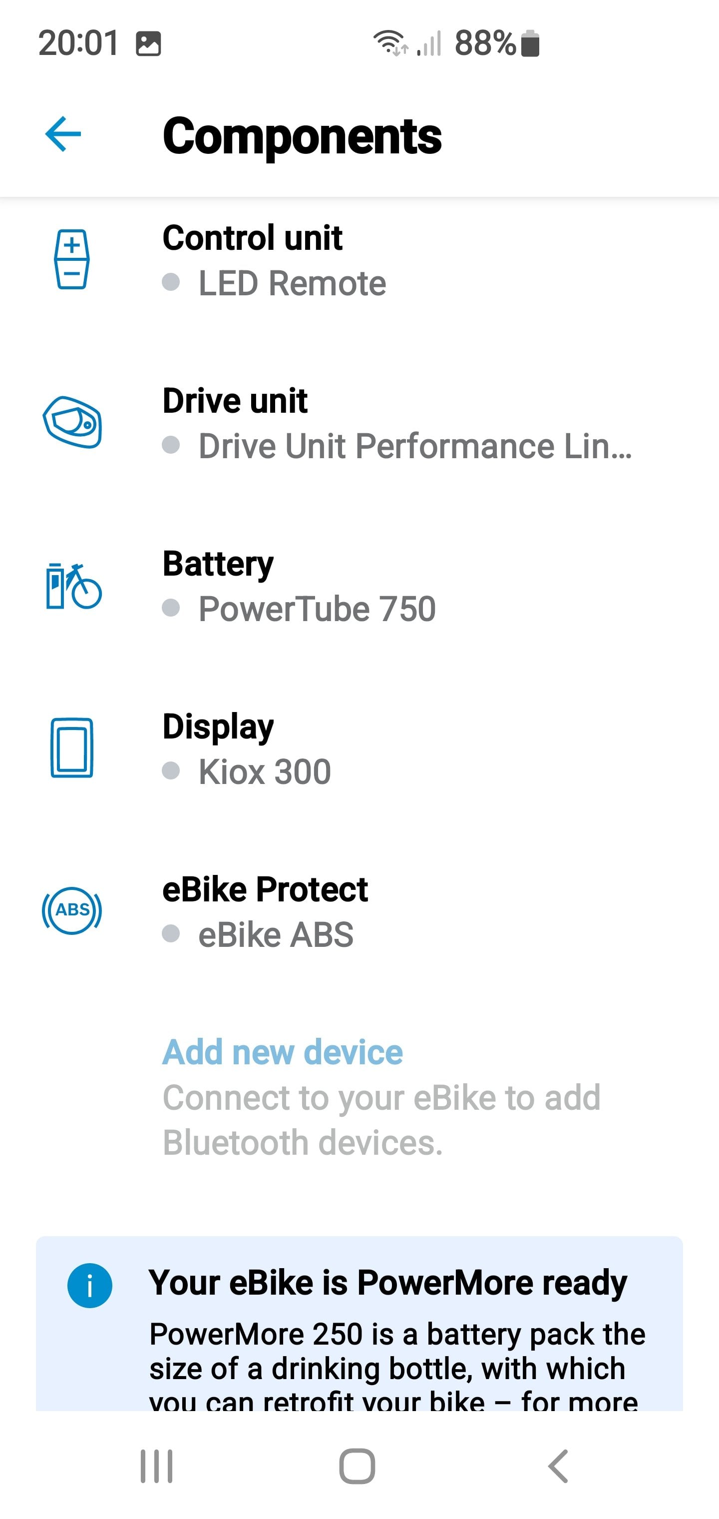

It is a Kiox 300.

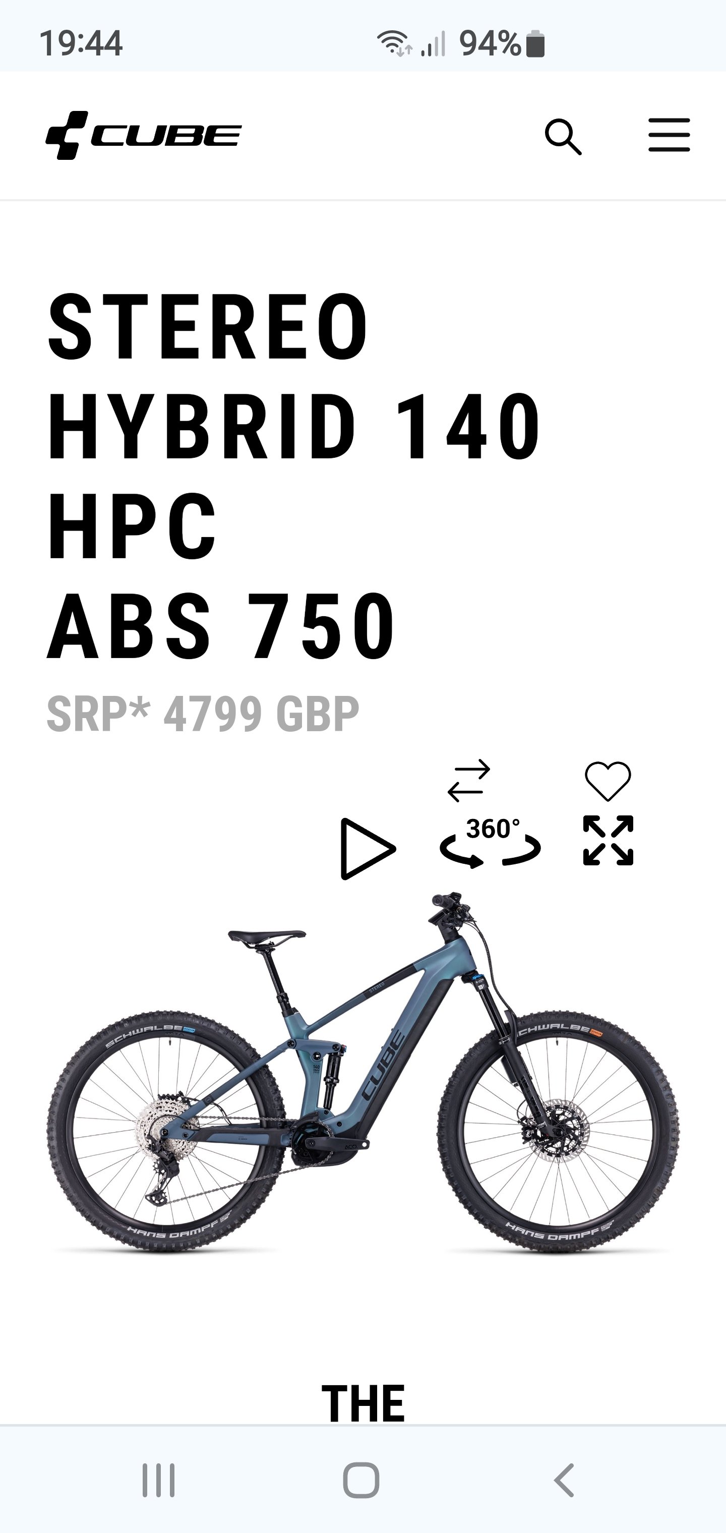

This is my bike on the current Cube website.
That is a smart system bike.
In this case you can use all bt heart rate monitors that use the basic technology described in this Bosch FAQ: Which heart rate monitors can I connect to my eBike?
Most heart rate straps sold and many smart watches should work.
For the smart system you will need to connect the hr monitor through the Flow app to your bike. You will have to be next to your bike, the bike turned on, Flow app on the smartphone open and connected to the bike. In Flow app go to „Settings > My eBike > eBike Pass > Components > Add new device > Other“. After the initial pairing the hr monitor will automatically connect to your bike. To actually show the heart rate on your Kiox 300 you need to add a heart rate screen to the display configuration which is also done through the Flow app.
Hope this helps.
P.S. The Kiox 300/500 for the smart system bikes have no buttons and are dumb displays without any computing capability or sensors. The Kiox for the older BES2 bikes has two buttons, is about the size of the Kiox 300 and has built in computing capability, bluetooth connectivity and local storage.
