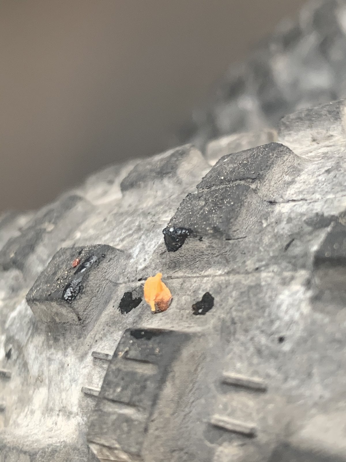

from the back tyre. the thorns and glass would have been punctures without the Tannus. 1100 miles in and nothing. you truly can forget about punctures. Easy to fit as well with 2.6 wide tyre and 2.5 tannus

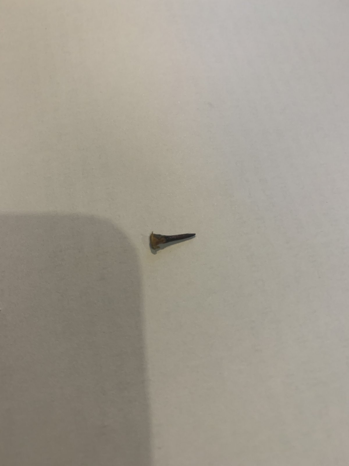

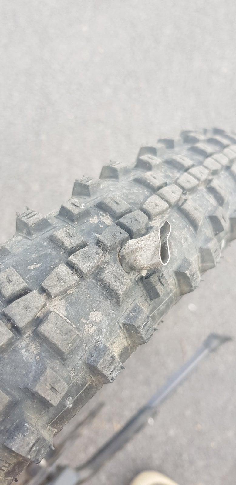

My tannus failed after 1300 miles but looking at what caused the puncture, nothing would have stopped it. Goes to show what the tyres have to put up with when commuting on roads

Mr Tuffy tire liner failed after about 50 miles. The thorn in the picture went right through it and left a nice little hole in both Tuffy and Tube
