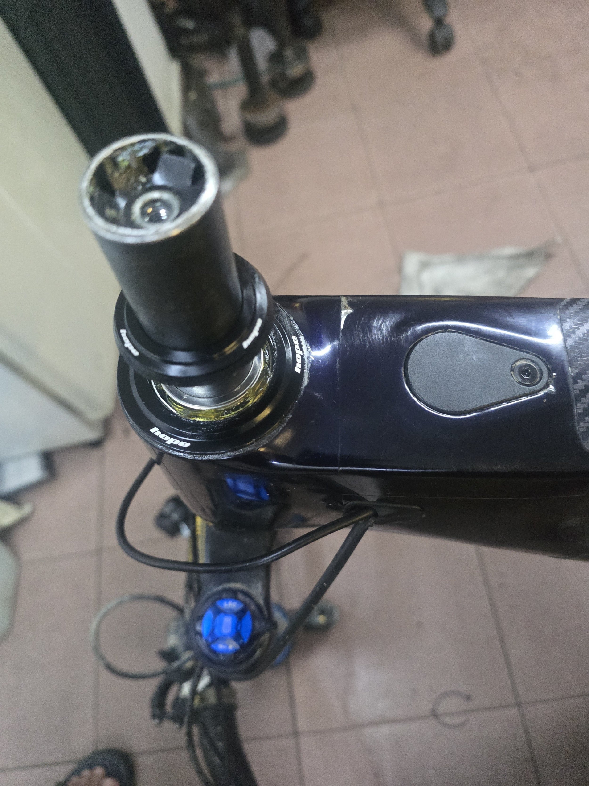

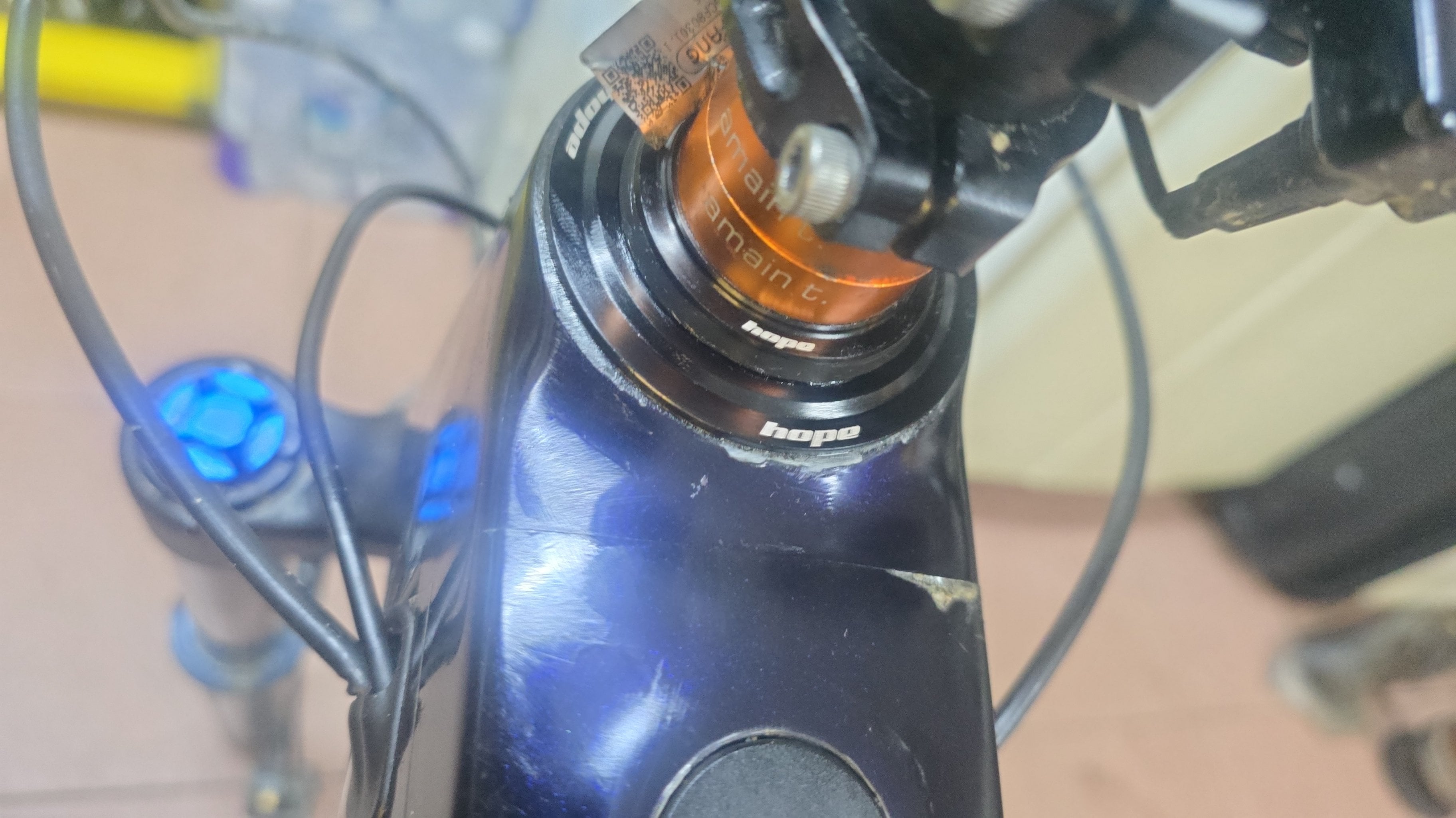

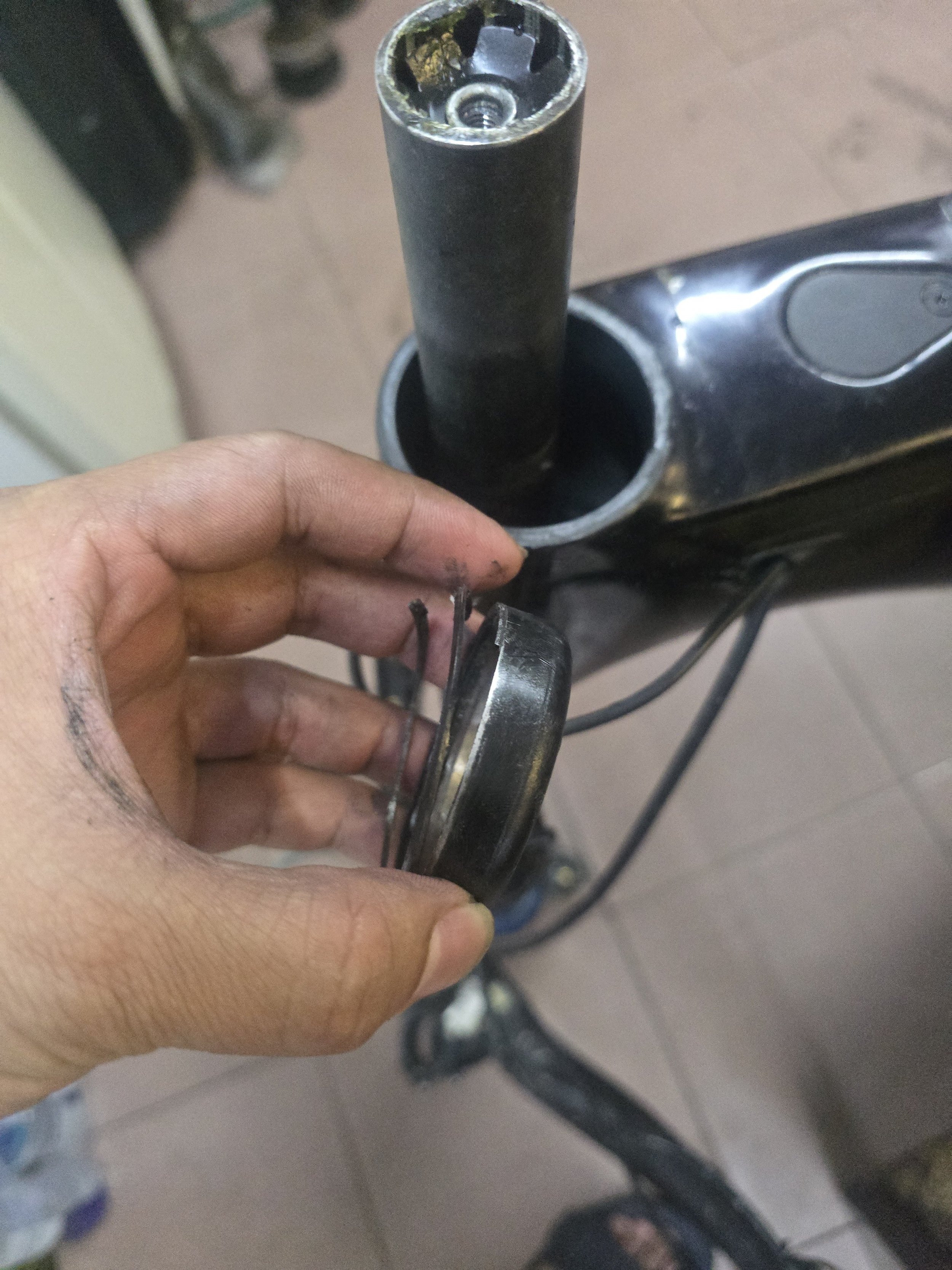

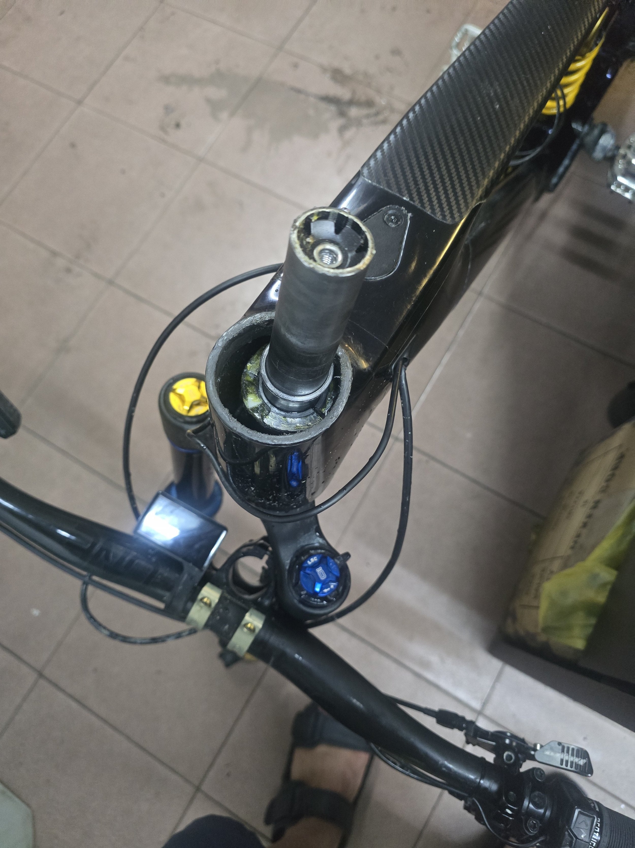

It's happen yesterday on a small drop. I finally break my bike but this time it's only my headset cup. Lucky I have a spare Hope headset. My headset cup but my carbon frame has no damage. Can I say SZZS does make some quality carbon.

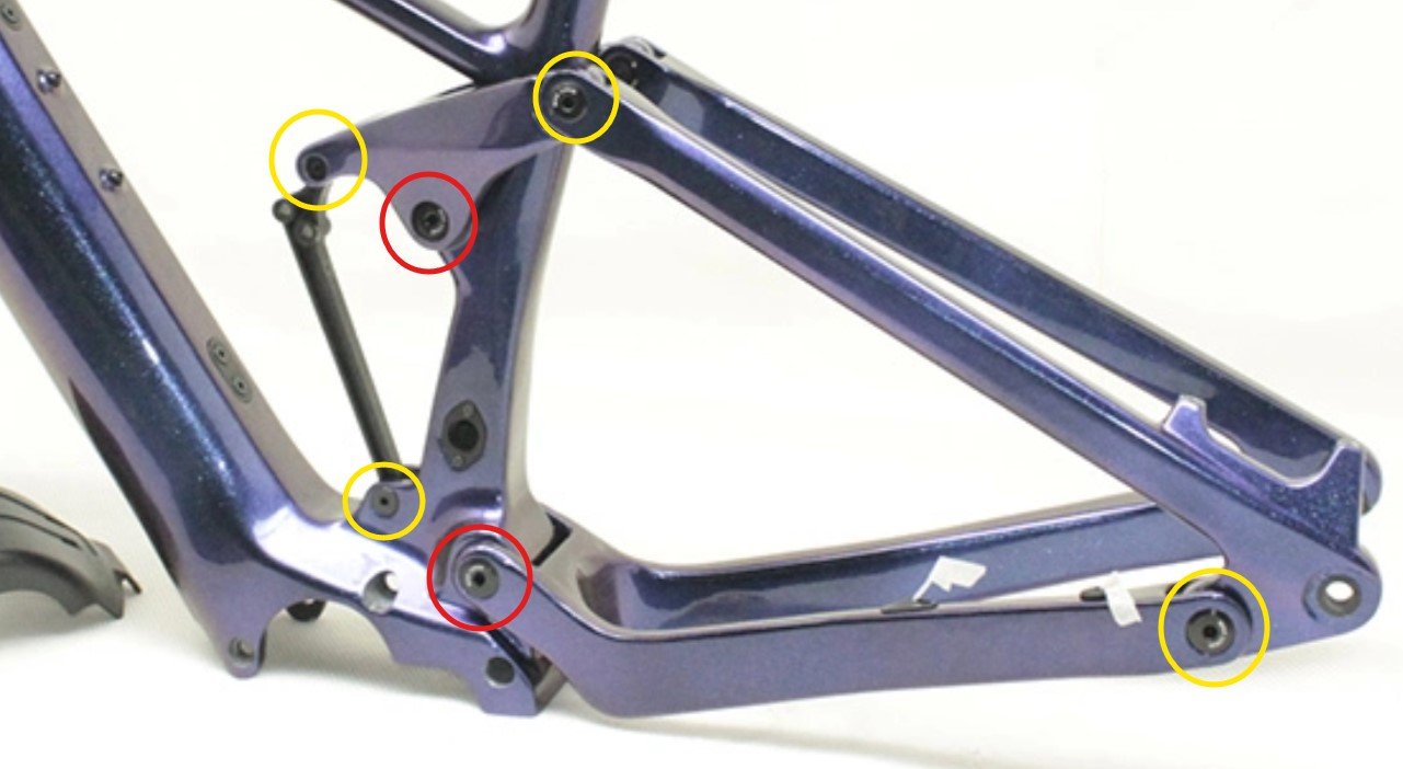

Hey folks, while I wait for my frame to ship, I want to do all I can to be fully prepared to build when this sucker finally shows up. First off, I've seen the issues some have had with their linkage fasteners. Over the last week I've read through this entire thread, but I don't recall anyone stating the actual sizes so that I can source them. I'm looking at Ti, but will consider a more robust Al or even steel options. I certainly want to replace the fasteners circled in red below, but I am also interested in upgrading the ones in yellow. Does anyone know the full specs of these fasteners so I can get some on order? Thanks!
What's the lower cup look like? If it punched the upper like that, I can only assume it hurt the lower. I can't imagine how the upper would move if the lower didn't?
