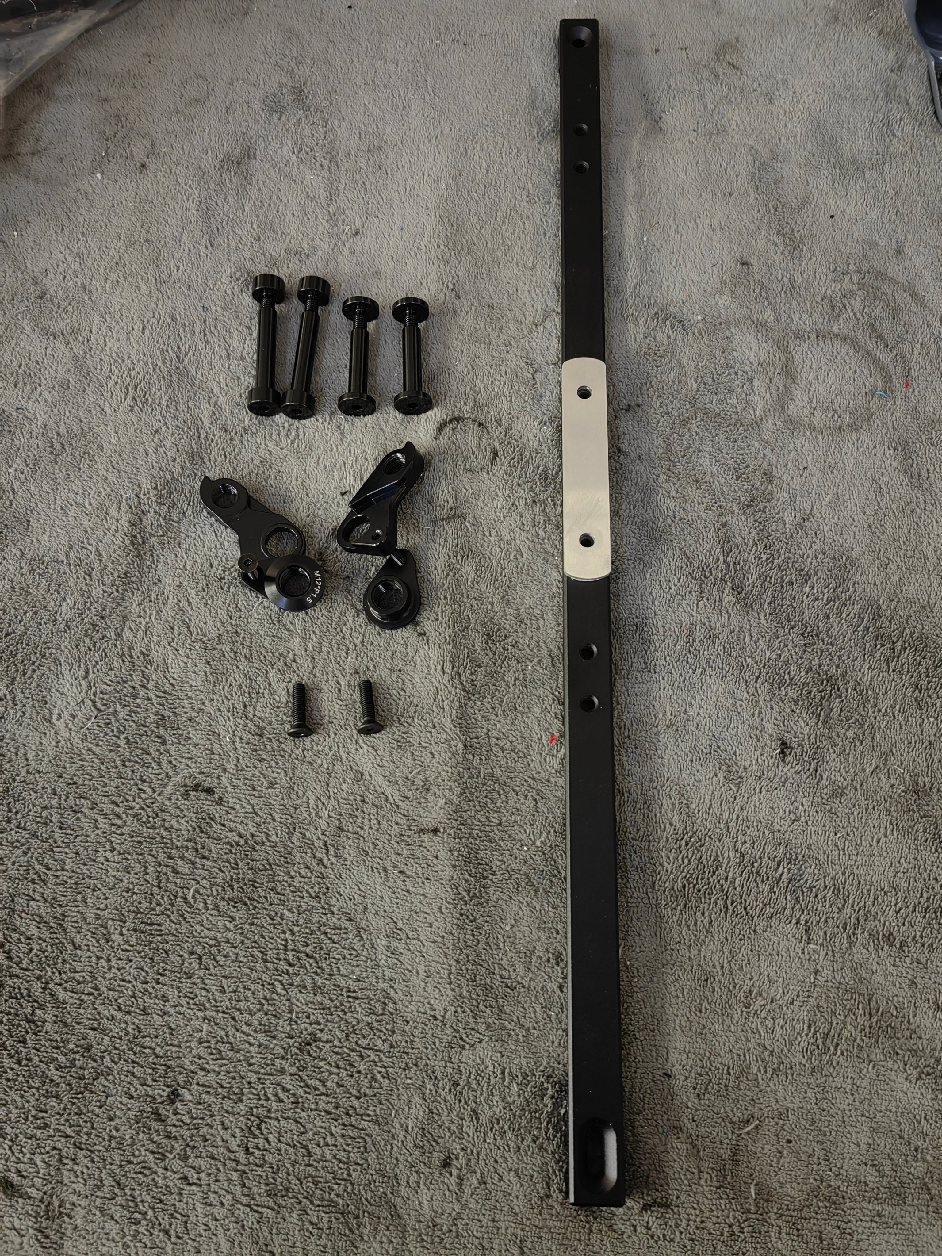

Has anyone experimented with either swapping out the battery mount for something else or using different hardware bolts on the CEF50?
Ignore the shock bolts and mech hangers on the left hand side, this picture was taken for an article I'm writing. Moreso, the battery mount on the right. Is it still required with a custom battery or have others simply implemented a hack/bodge to keep the battery from rattling within the downtube?
Has anyone experimented with either swapping out the battery mount for something else or using different hardware bolts on the CEF50?View attachment 128230
You are very lucky, you have such a wonderful bar on the right. I had to make such a bar. I installed the battery without the case. I taped the bar to the battery with reinforced tape. I screwed it to the regular place and added foam between the frame and the battery. The battery holds very tightly and the bike has become 900g lighter.
