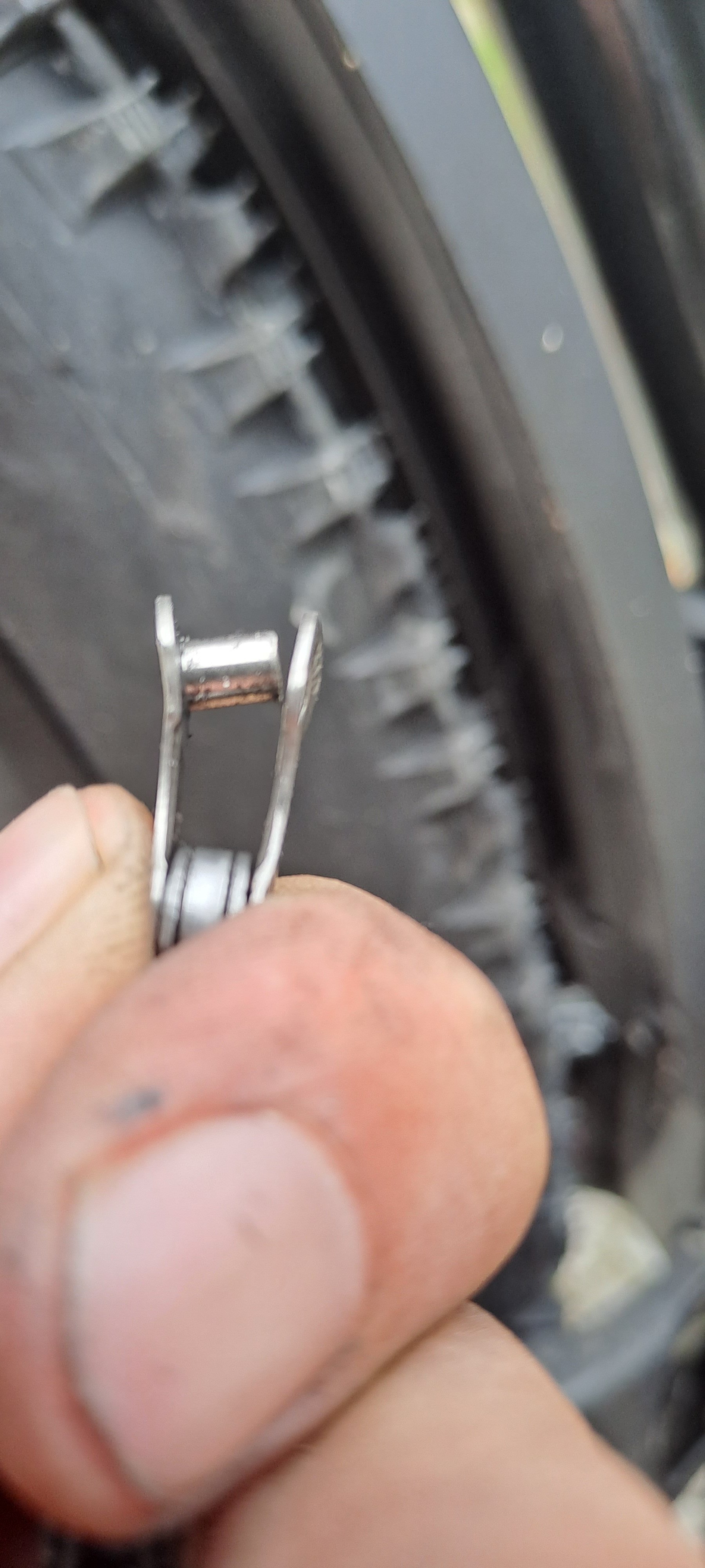

Having today managed to break the chain on my new bike 5km from civilisation (spare tube: yes, spare chain: no. One lives and learns 😀 ), I'm looking for a durable 10 speed chain and came across KMC's DLC series.

Pic of buggered chain:

It wouldn't have helped in this specific case however (see pic, maybe it's not clear enough though) - I'd have had to remove the damaged link first, which would require the chain-tool I didn't have with me.
I had my mini bike multitool with as always. It wasn't much use in this case - I couldn't lever the side of the damaged link sufficiently to connect to the other end to make an improvised pedal-very-slowly-home repair. It wouldn't have helped removing the damaged link either if I'd had a spare quick-link.
