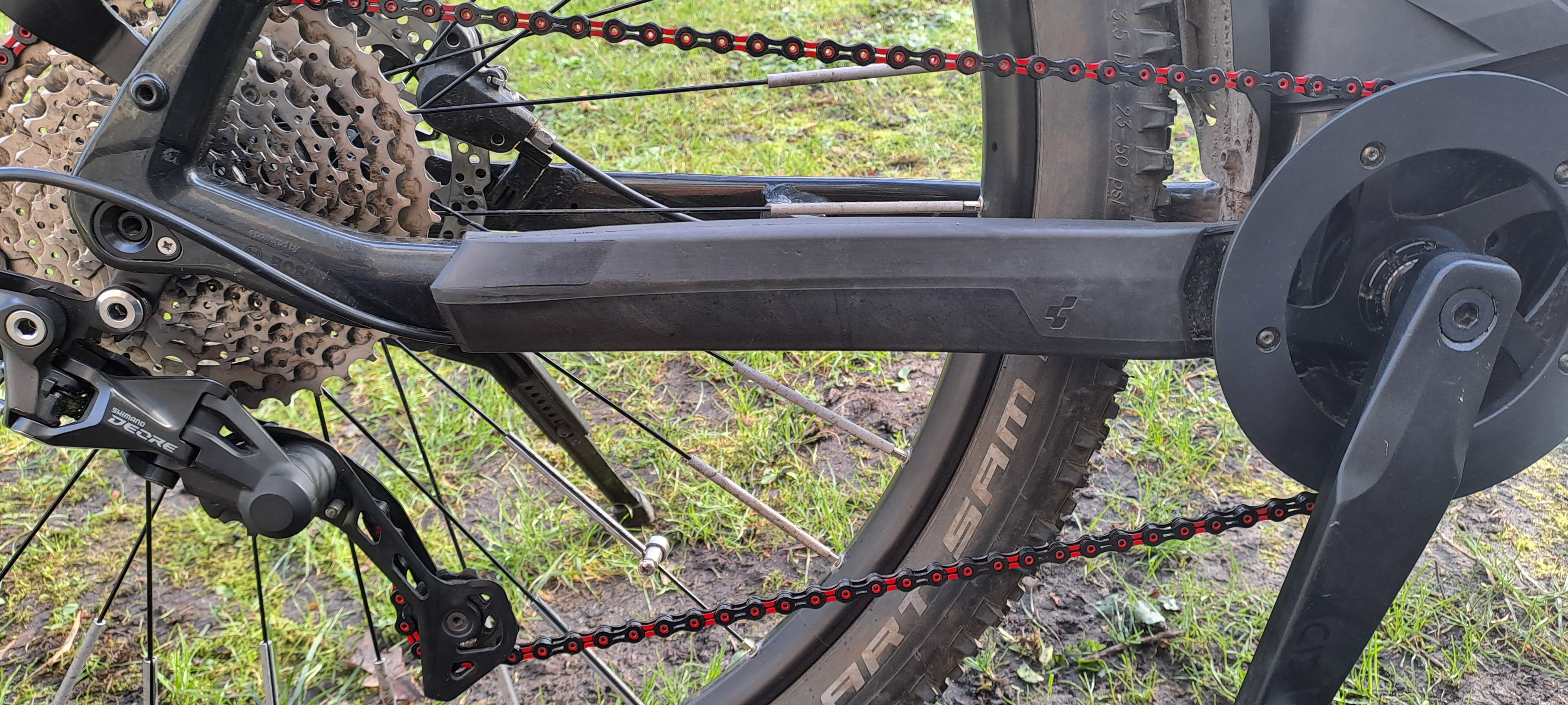

Having today managed to break the chain on my new bike 5km from civilisation (spare tube: yes, spare chain: no. One lives and learns 😀 ), I'm looking for a durable 10 speed chain and came across KMC's DLC series.

KMC do do an e10 explicitly for ebikes. However, it seems surprisingly to come only with 122 or 138 links. The X10 has 116, as does the Shimano HG. I want to avoid having to trim the chain, it's a PITA.
Pic of buggered chain:

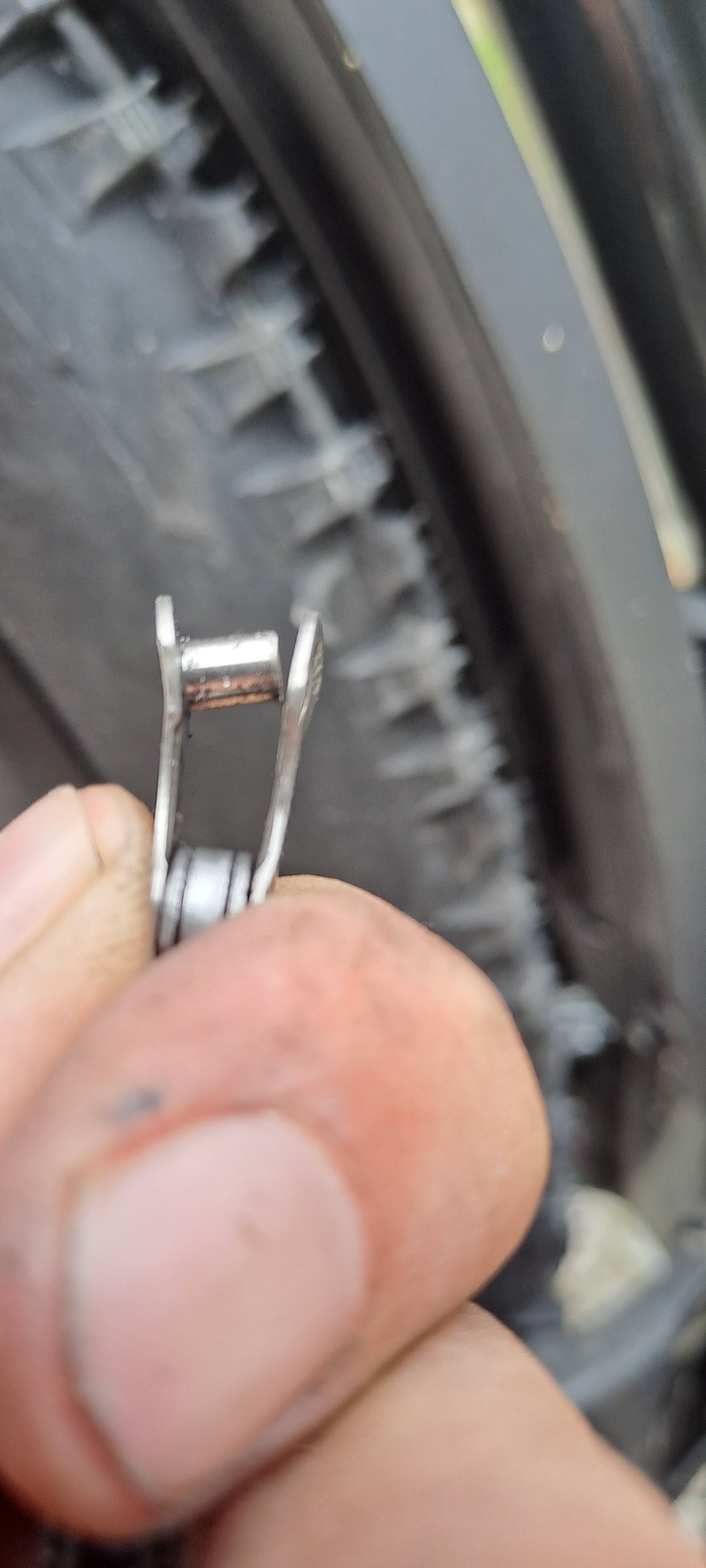

I usually have a spare quick link with me too - I didn't in this case as new bike with different chain size to the old one.
It wouldn't have helped in this specific case however (see pic, maybe it's not clear enough though) - I'd have had to remove the damaged link first, which would require the chain-tool I didn't have with me.
I had my mini bike multitool with as always. It wasn't much use in this case - I couldn't lever the side of the damaged link sufficiently to connect to the other end to make an improvised pedal-very-slowly-home repair. It wouldn't have helped removing the damaged link either if I'd had a spare quick-link.
