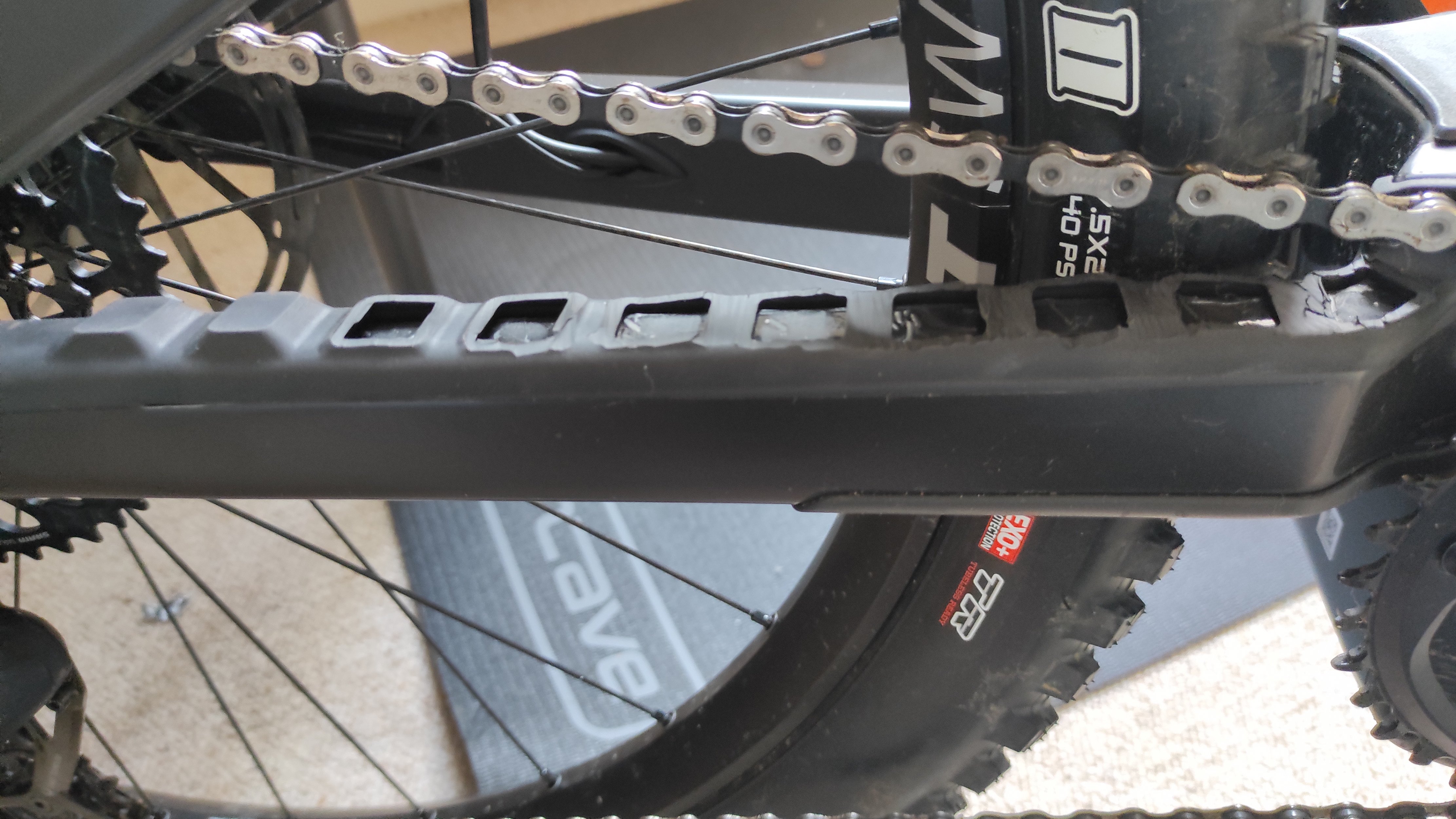

passage of the chain, in the first 4/5 sprockets (!!!) it touches the chain guard with evident wear of the same
I was wondering the same but I was just going to get a nice sharp knife and cut off a couple of knobs in the hope that works
The chainstay position isn't a great design. I'd contact Canyon with pics of the damage and ask them to send out spares since you will be going through these quite often. The only other thing you can do is use an inner tube and wrap it round the chainstay.
i did it, I think I'm probably just gonna remove the top part and replace it with inner tube or smth

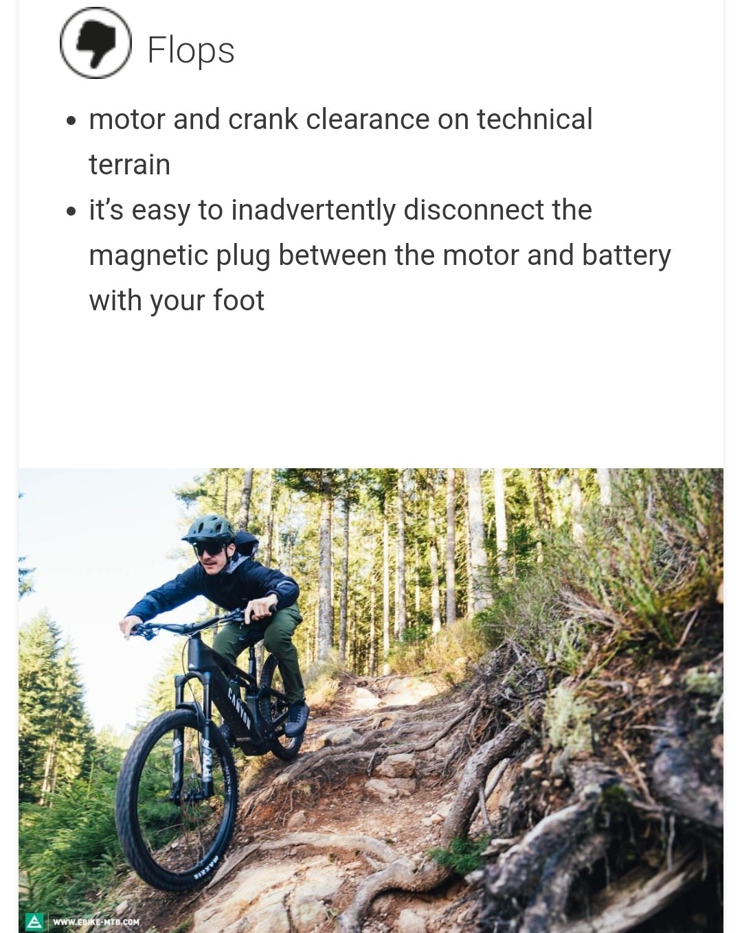

You can find several professional reviews online discussing these issues. Dozens of posts in online forums.
Is it an profesional review? They also reviewed Canyon Torque with 2mm higher bb and it has enough clearance. Maybe they forgot to pump suspension in Spectral?:)
Crank clerance - yes it's not the biggest - you can read it in the specs before you buy bike if it's very important for you (bb drop). This parameter impacts handling and some bikes have bb higher and some lower. I have scratches from rocks on the cranks but I also have on my analog bike cranks.
Motor clearance - The motor from the bottom does not protrude beyond the cog, so I do not see a problem here. You probably mean the front, but it looks like most e-bikes. Yes, you will hit motor cover when you'll try ride throgh a drop too slow. But would be the same even on analogue bike. Did you broke your cover?
Plug - Disconnect It by foot? I wouldn't even be able to do that on purpose. How many times it happend to you and how many km you did?

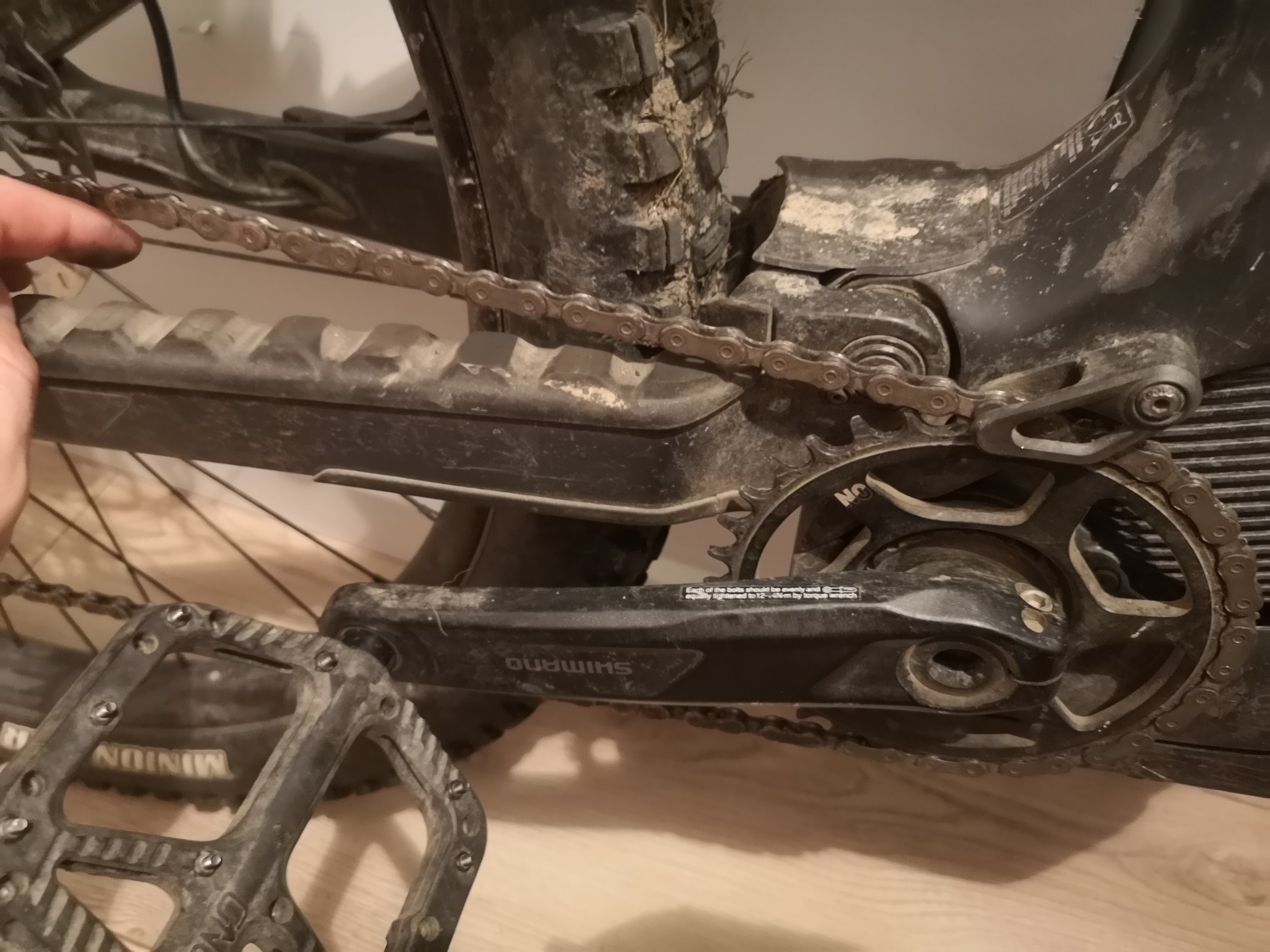

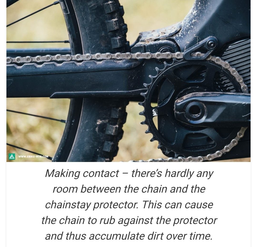

Chain - Yes, chain touches this rubber and it changes nothing. No noise, no wear. Dirt? My bike is dirty after every ride. When its wet it's all in mud, and when dry in dust.
I attached photo after 1500 km in mud and dust.

Chain - Yes, chain touches the rubber sometimes. I do not see the problem. I see no wear on the rubber or chains ;-)

Agree on the rubbing chain being a non-issue though I stressed about it in the beginning. I believe the sag takes it off the rubber anyways?!? 800+ miles on the bike and no wear on that rubber piece.
