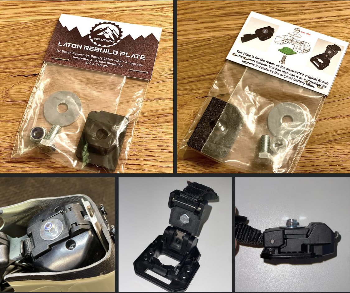

A guy on the strive on owners Facebook page (ran by rob rides emtb) has developed a new latch support and is selling them
I have ordered one myself so will see if it does the trick

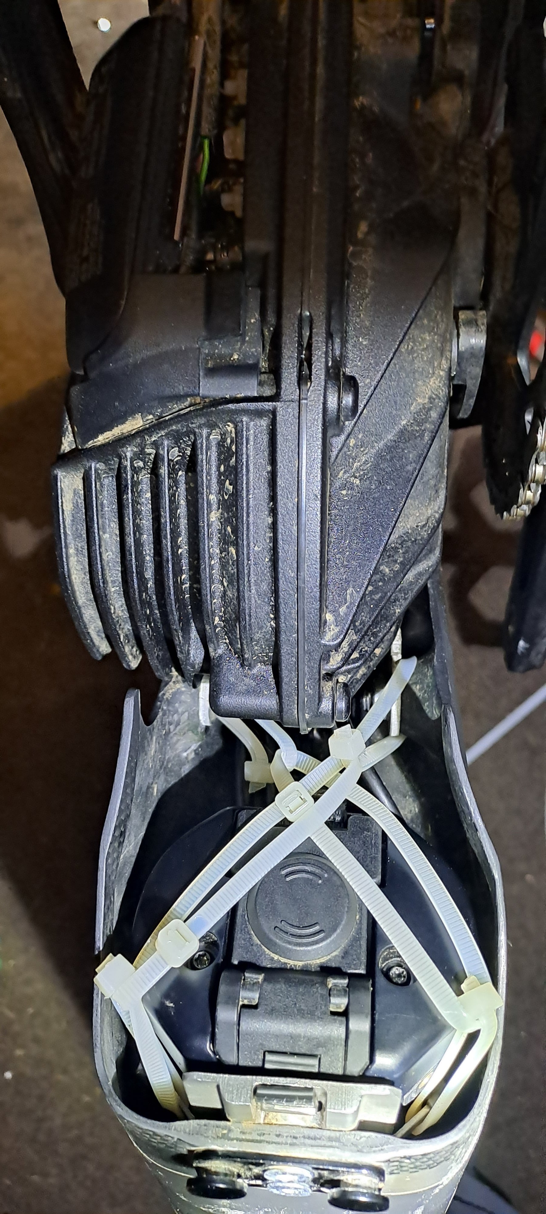

I’ve ordered one too. I’ll run it alongside the zip ties until the official Canyon solution is released

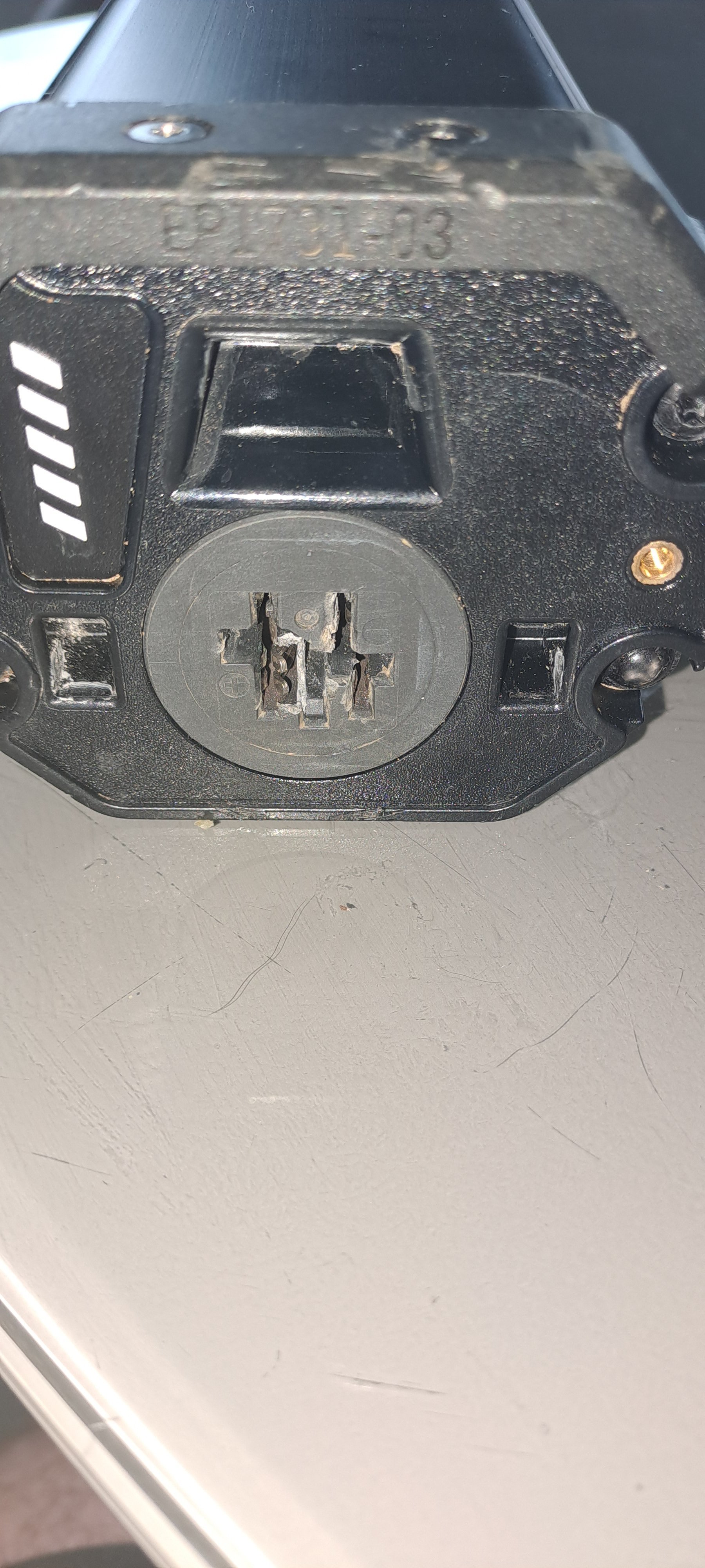

I´m not so sure this fix will work in the long run. It might keep the latch alive for longer but it does not adress the small movements of the battery. My biggest worry would not be the latch breaking but the wear and tear on the battery and connector terminals in the future, which will be a lot harder and more costly to fix.

Link? And how much are they?
Shame it comes to this though. Canyon should be funding this at the least.
I think with shipping it was about £13 so not exactly breaking the bank. I am looking at it as a put me on until canyon and Bosch bring out their update
This is how I've fixed my battery in place for now as I'm currently waiting on a warranty replacement battery arriving from Germany due to the terminal damage....far from ideal but seems to be holding up so far with no more cutting out or orange lights on the display 🤞

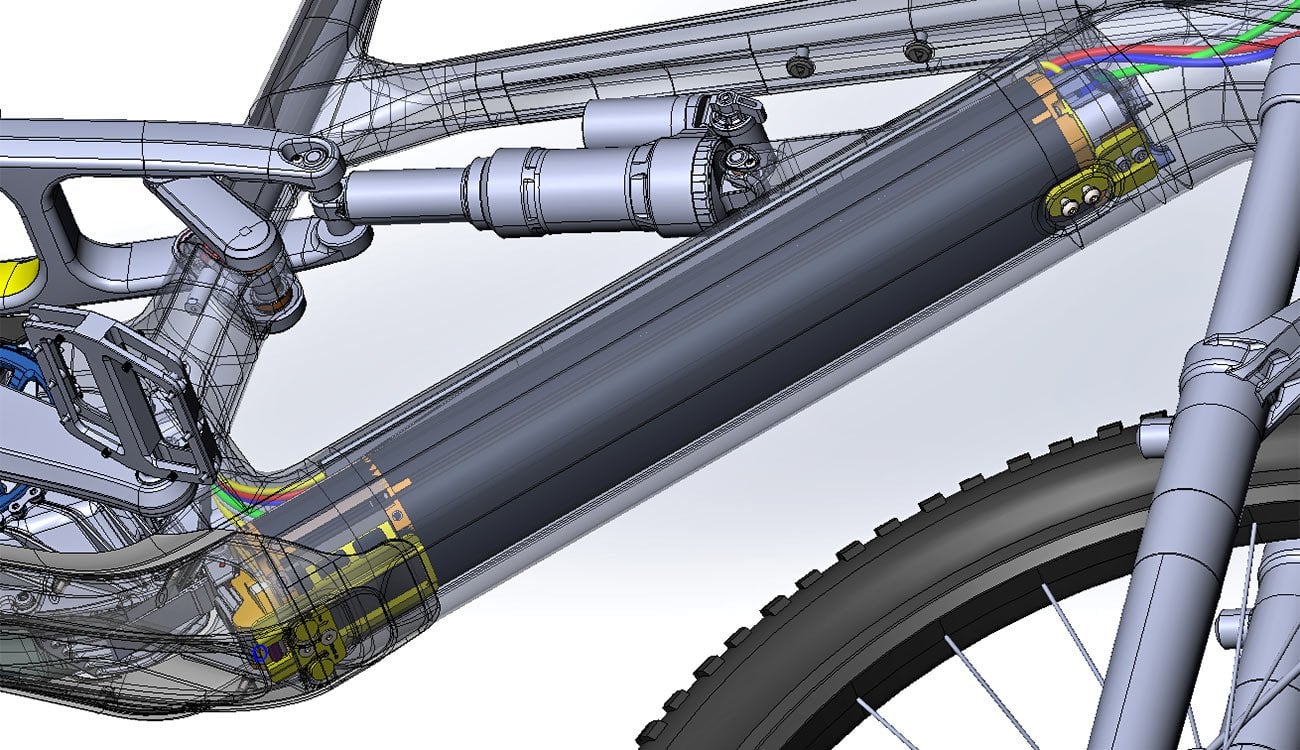

Hello Mario Antony!
I'm new to the Forum so there is no private messaging yet, but i still have a kind of time sensitive question:
Is this 3D-CAD-file shown in the picture a cutout from a complete drawing?
Because i would be very interested in accessing it for my project work where i upcycle a bosch bes2 system to fit into the Strive:On cfr frame, in order to pass my Meistertitel. I would be really excited to hear from you because it could save me some hours and the technical difficulty is still high without having to draw the frame.
