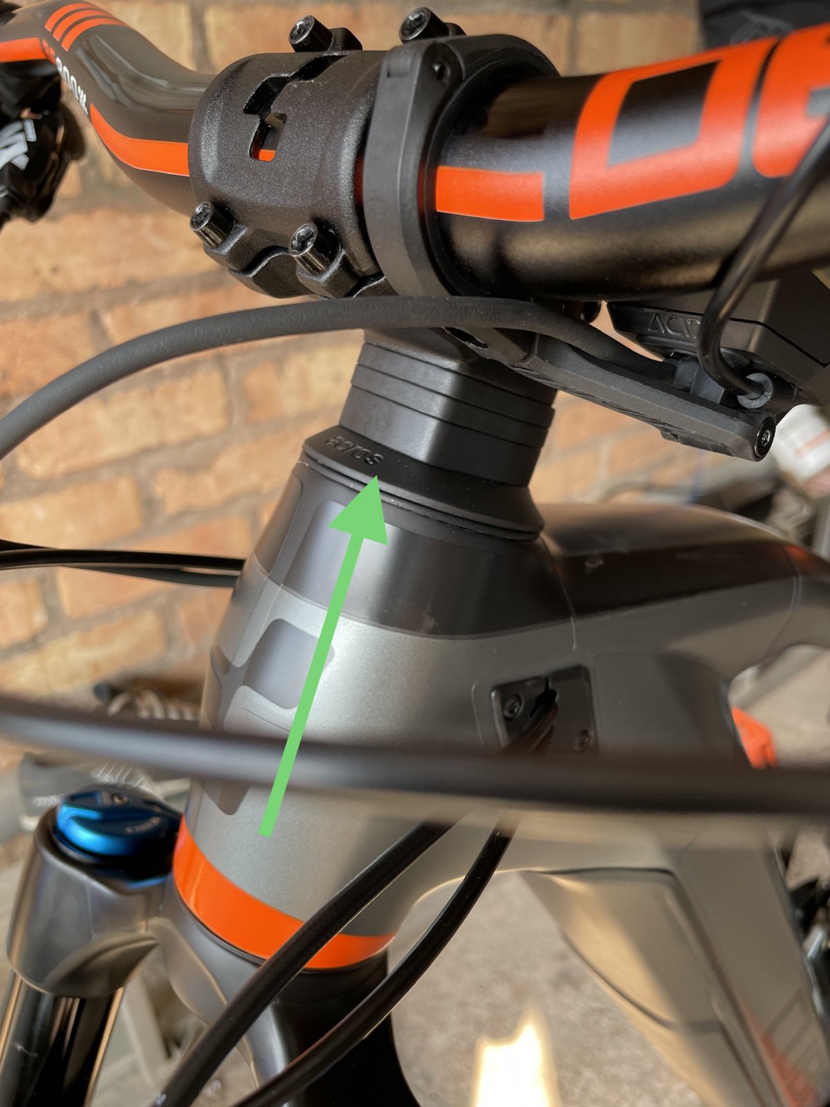

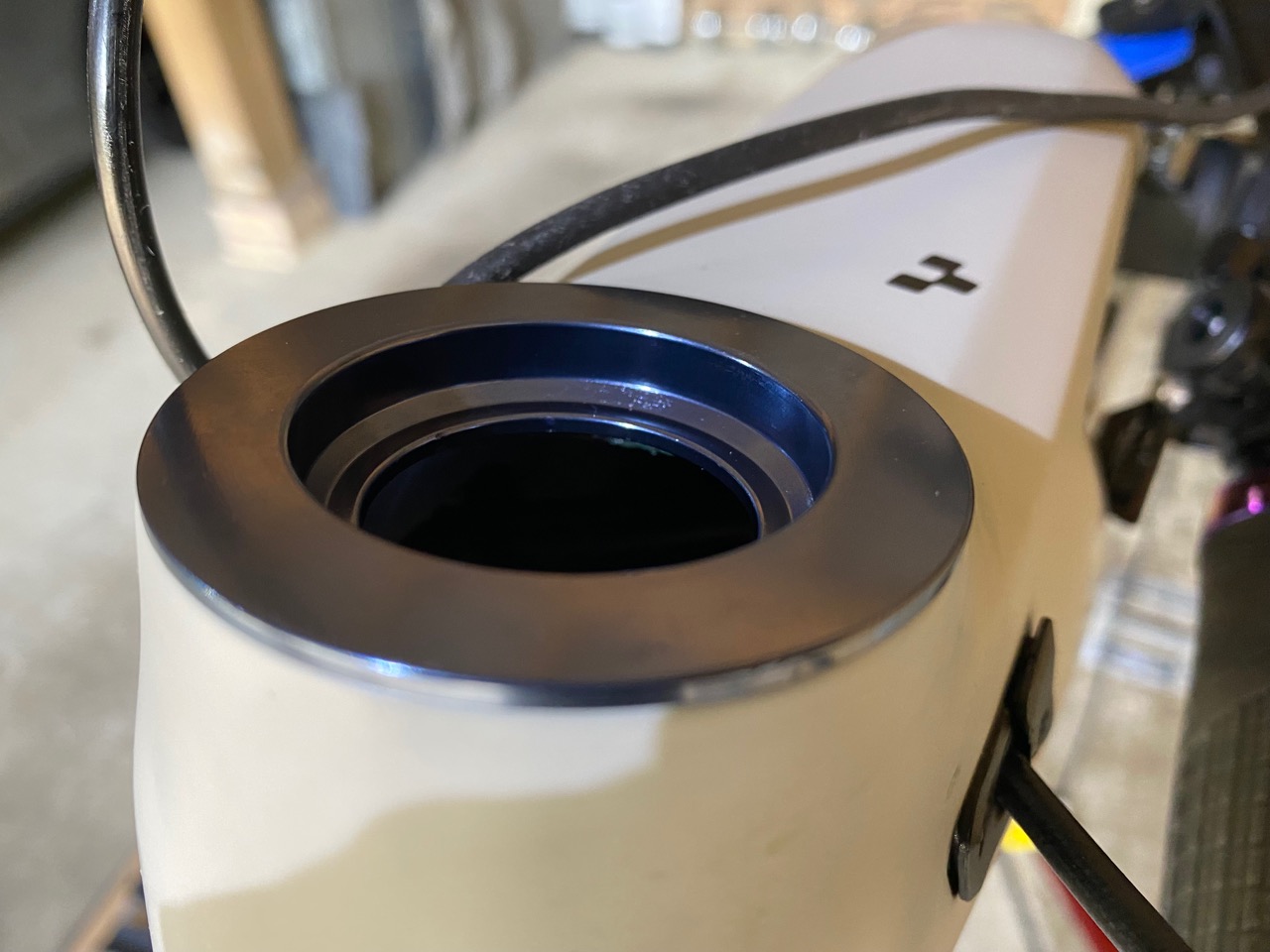

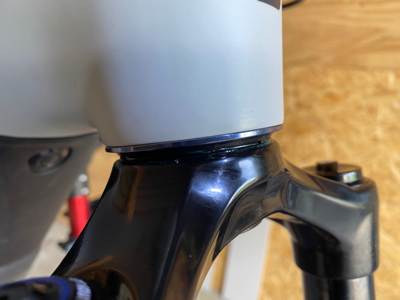

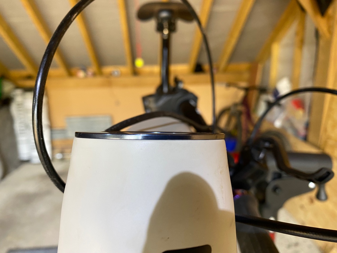

So over the weekend i cleaned my bike and as i was rolling my bike in the garage on the back wheel my dad decided to hold my fork and wiggle it back and forth and i have so my pay in my headset! I didn’t even realise or feel this issue so glad he randomly did it…
But here comes my question… see the first image with the red arrow i dont like the look of this headset as its just flat looking. i like the more “dome” original look rather than it just being flat. Could someone provide me with some links that would fit the cube that have a more dome shape?
I know nothing about headsets etc so, sorry if im being thick or to picky?
Think the closest you'll get is the Cane Creek 40 series headset like this
@Oldrider has one fitted to his and it looks like this
Its a hell of a lot better than the standard ACROS one fitted, but isn't as 'domed'. The Cane Creek is a shed load more money as well costing at least double what you'd pay for the Superstar one and doubtful if it would be any better performance wise.
Thanks for replying. Yeah that would be alright better than looking flat. However canecreek dont ship outside of US/canada by the looks of it. :(

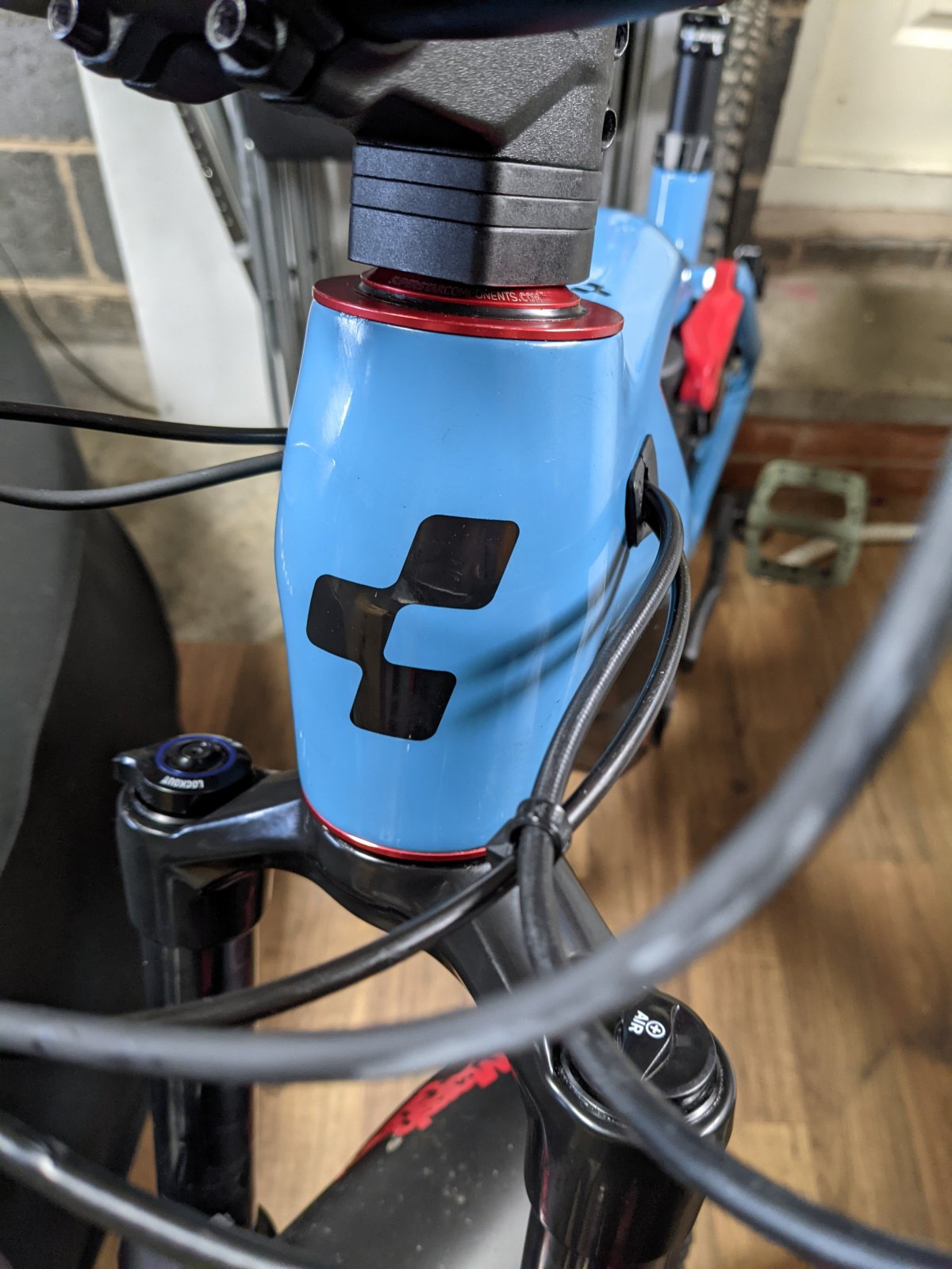

Had to send my fork in to the SRAM Tech Centre for a new valve and seal - so took the opportunity to pop in the new headset of my 140 Race. The old bearings were shot, just fell apart when I removed them this time, the plastic cups popped out really easily with a gentle tap. Clean it all up, lightly grease and the new Superstar cups went it with a rubber hammer and 2 gentle taps.
Fantastic engineering and a huge upgrade with the built in seal on the crown race. Well worth the upgrade for anyone thinking about it. Some pics which may help others.... (colour is gunmetal)!

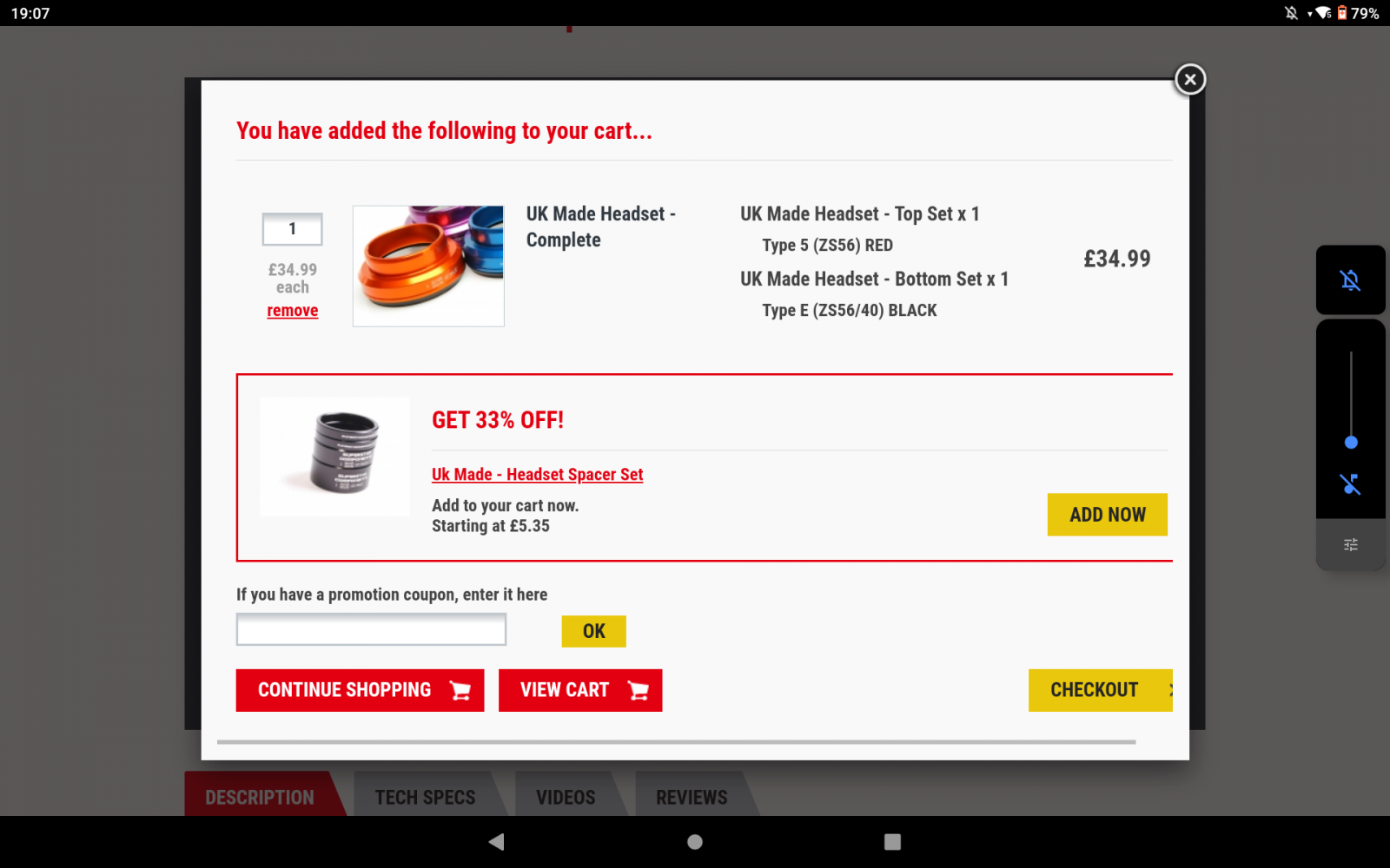

Being a complete and utter newbie, just before i press Buy, is the following correct for my Hybrid Stereo Race 160 which is creaking badly after 150miles??
Do i need spacers and if so how many?
Does the kit come with a Topcap (i like the UK flag effect i have seen on here)?

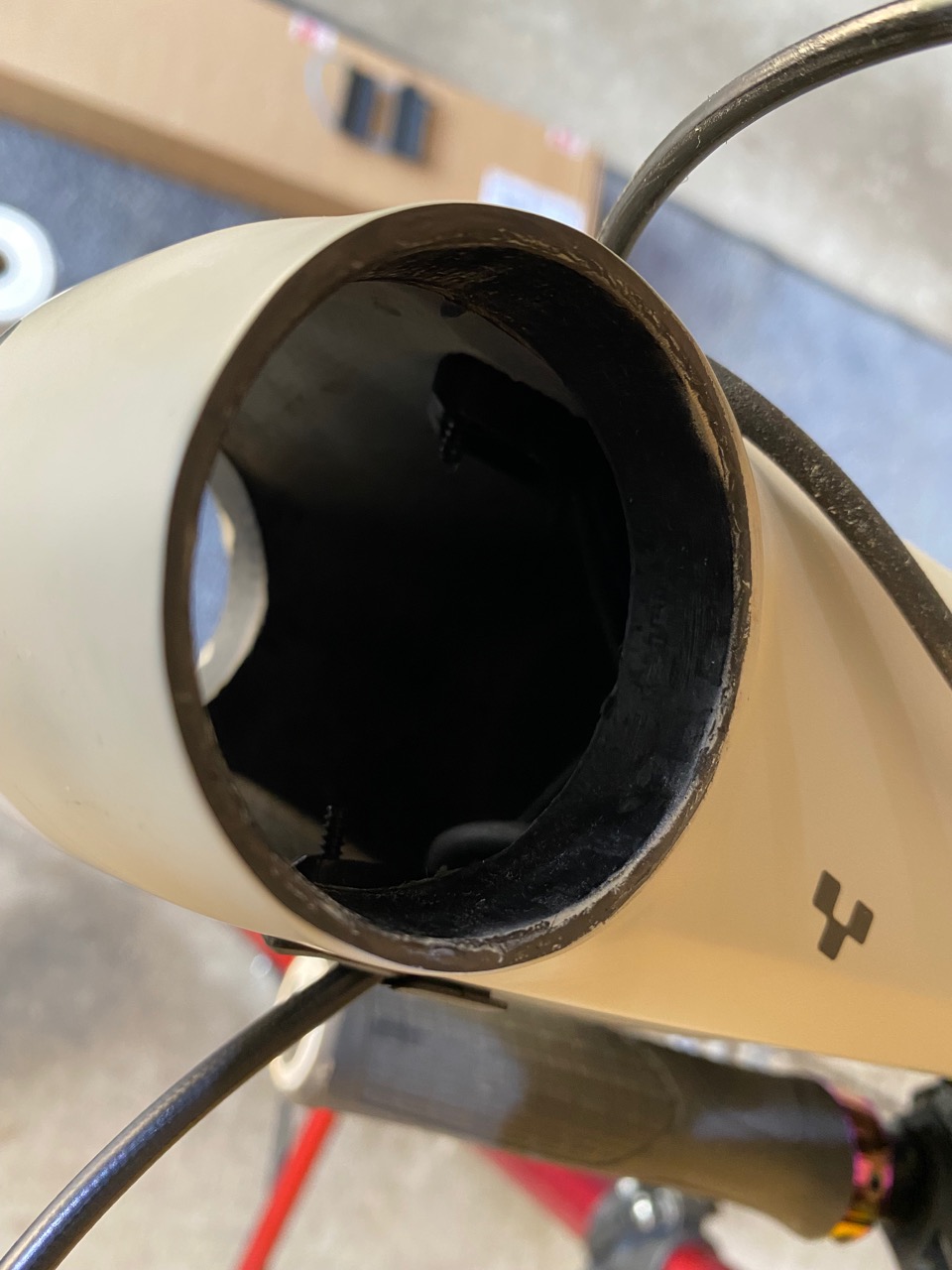

Ordered as above and started to fit.

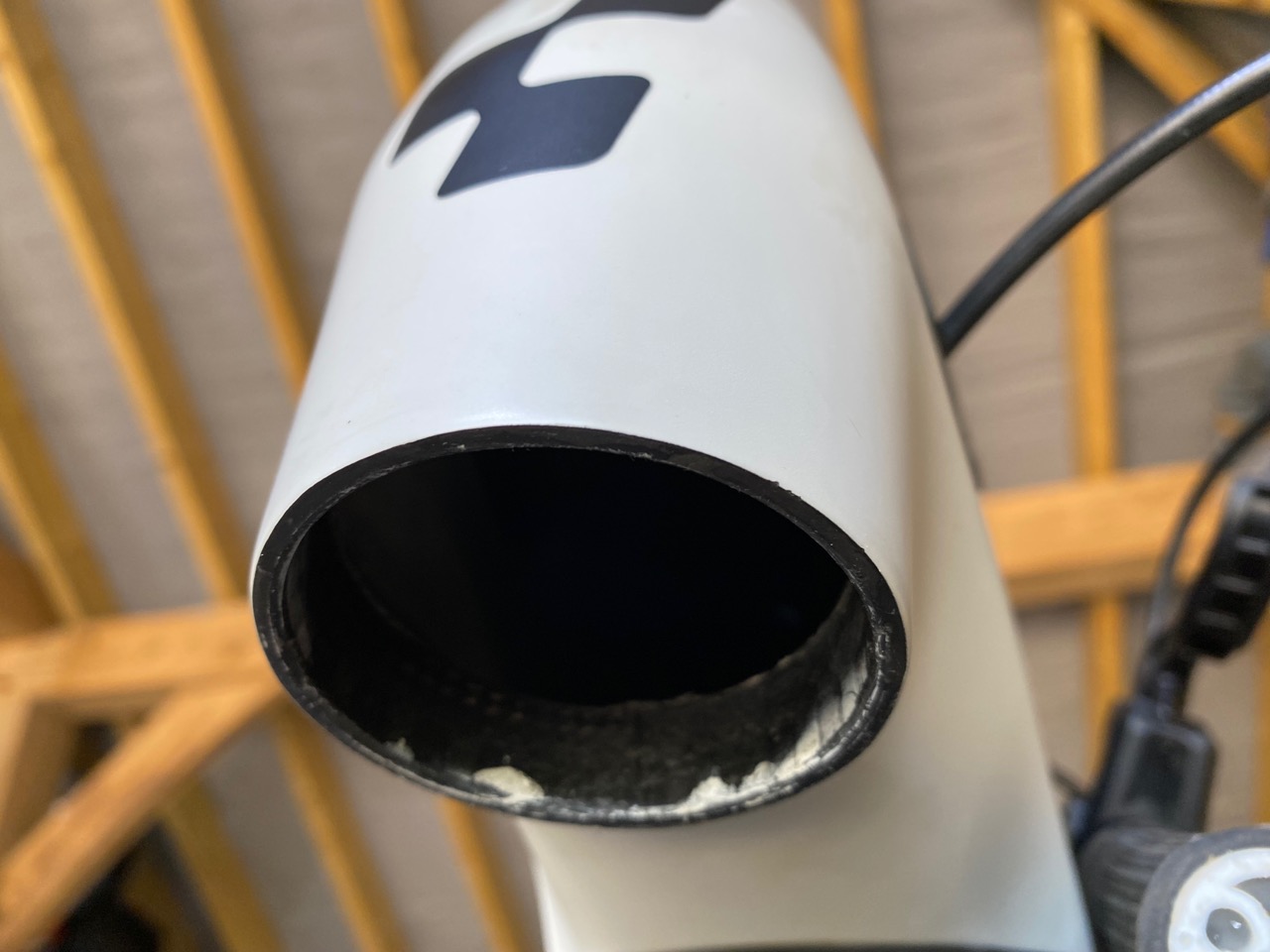

Old bits came out really easy. Top set fitted into the frame with light tapping.

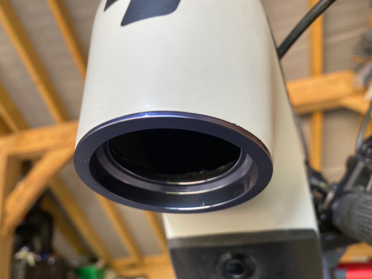

I cannot get the bottom set in. I have tried gently tapping with a wooden mallet but with it being a carbon frame I am concerned! Any advice please??
Scrap that. Put everything in the freezer then used a larger wooden hammer.

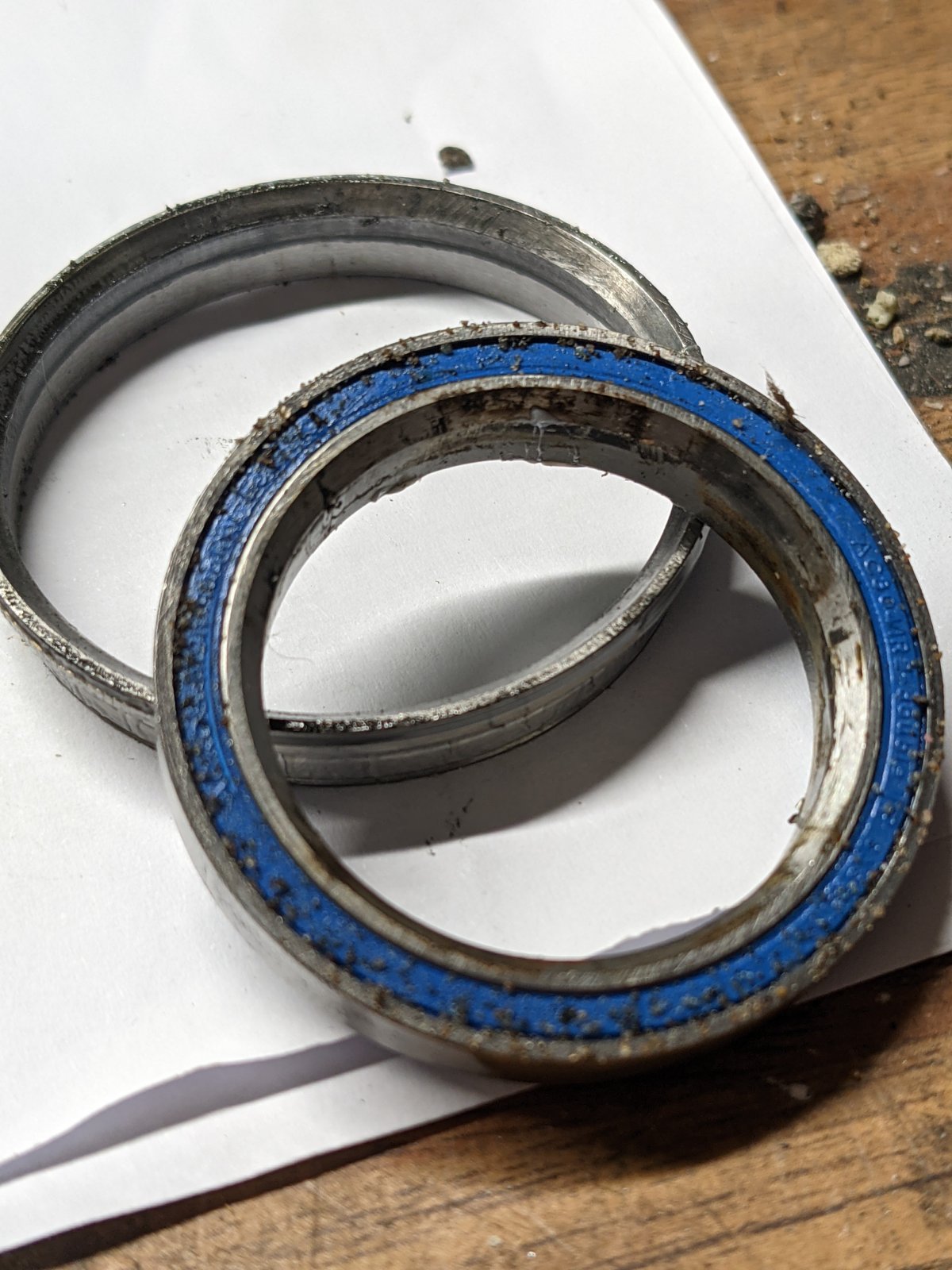

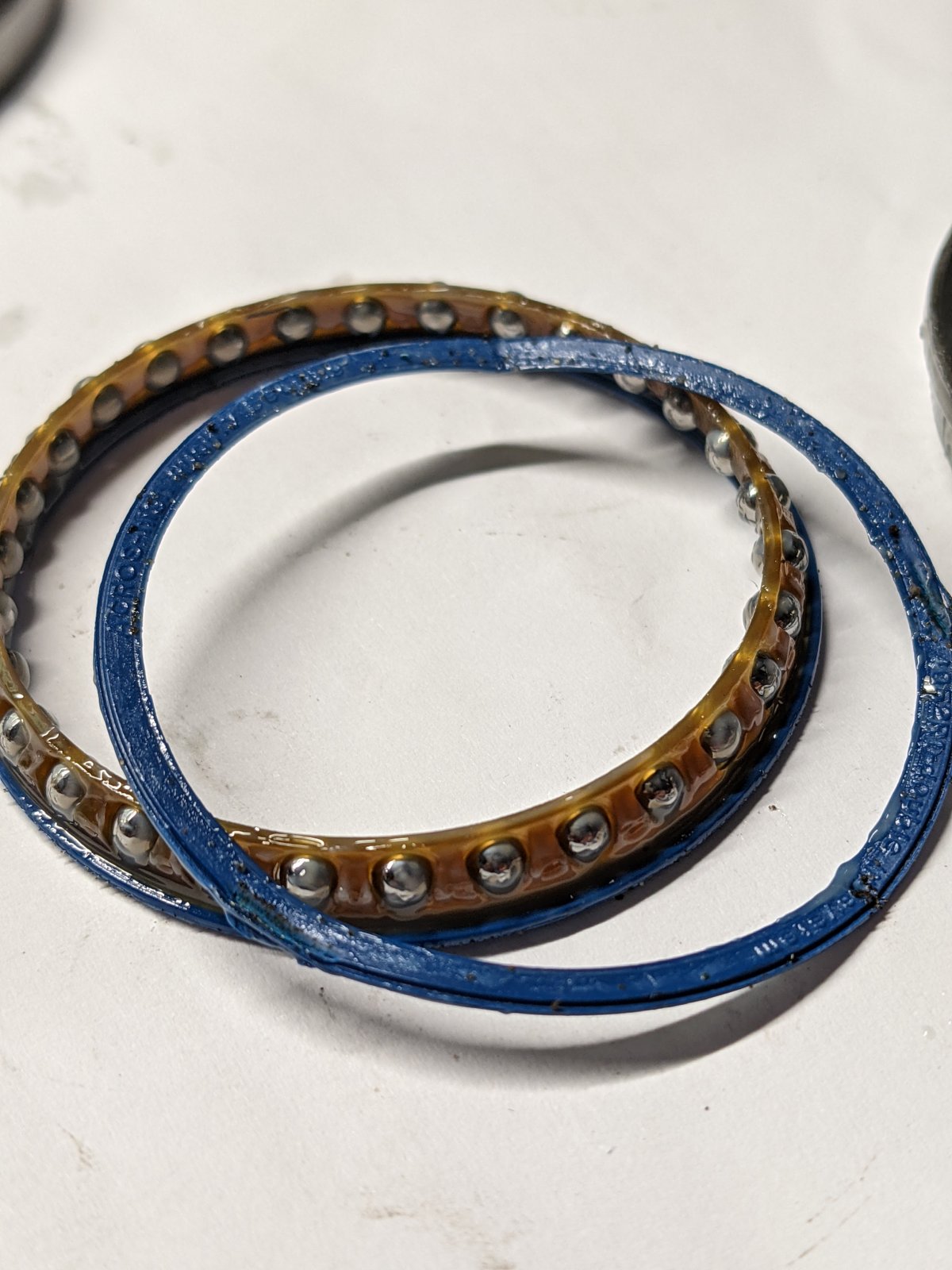

The condition of the Cube bearing was terrible after just 200miles.

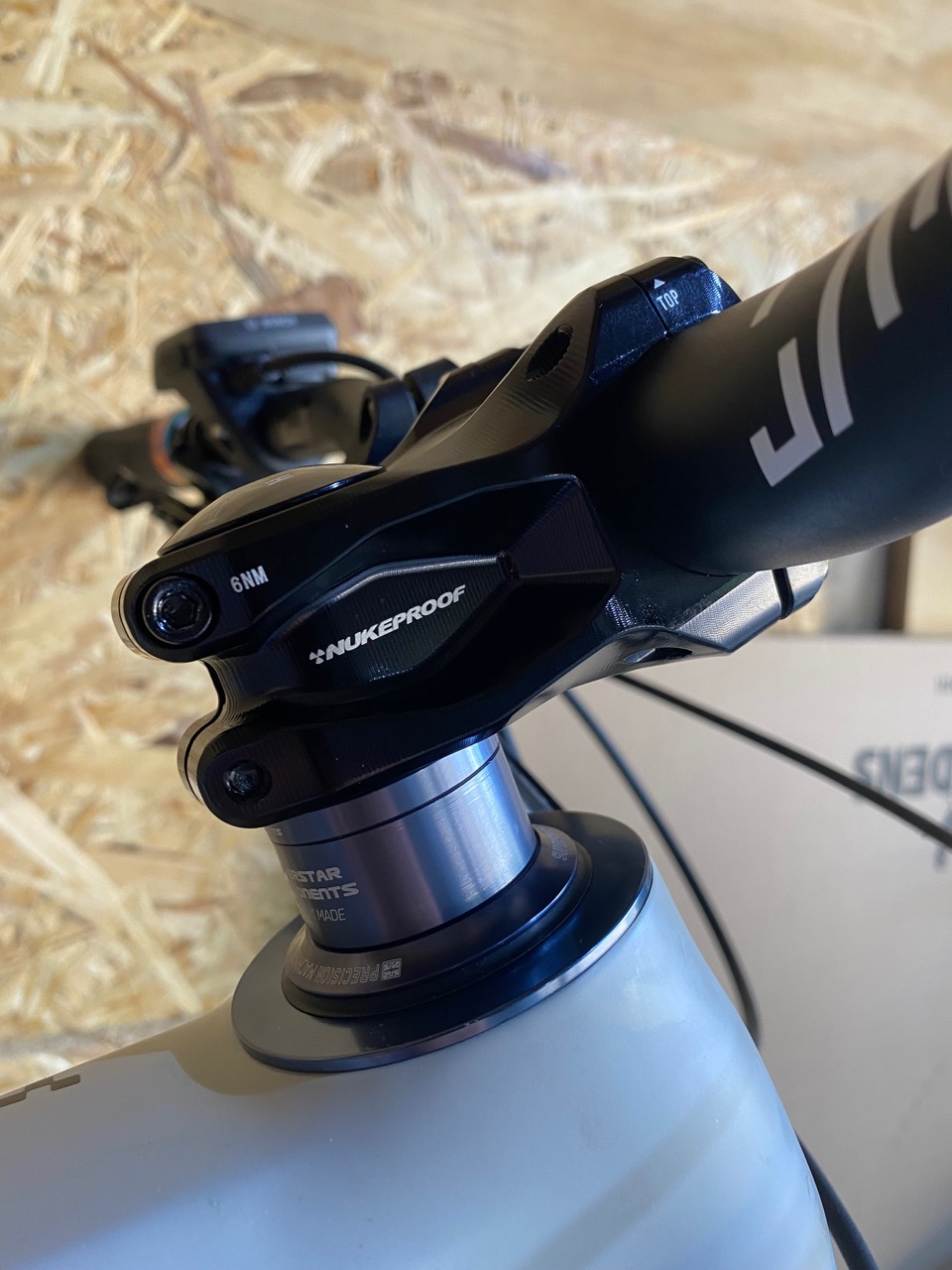

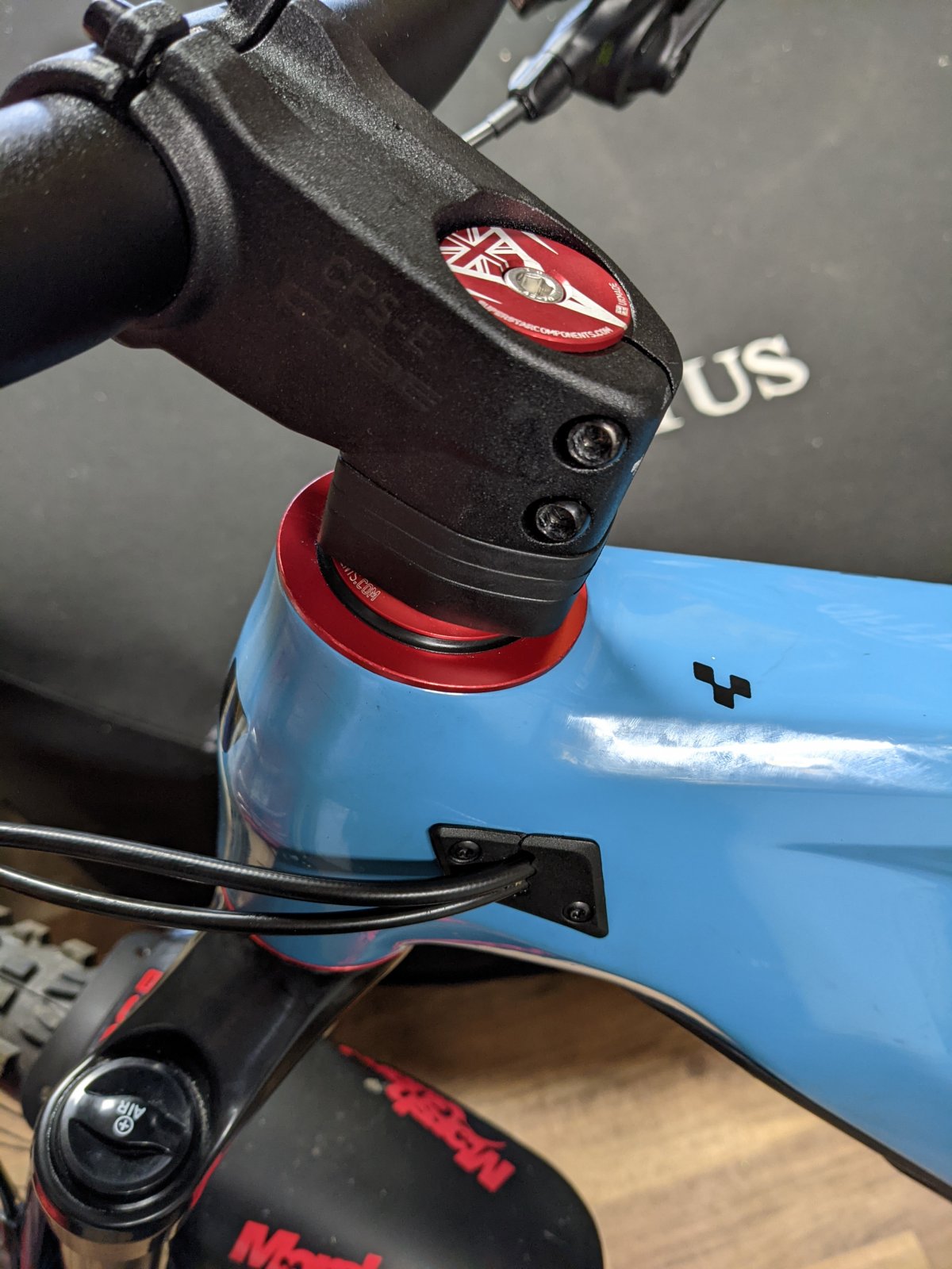

New Superstar Components fitted. Will get some matching spacers as well.

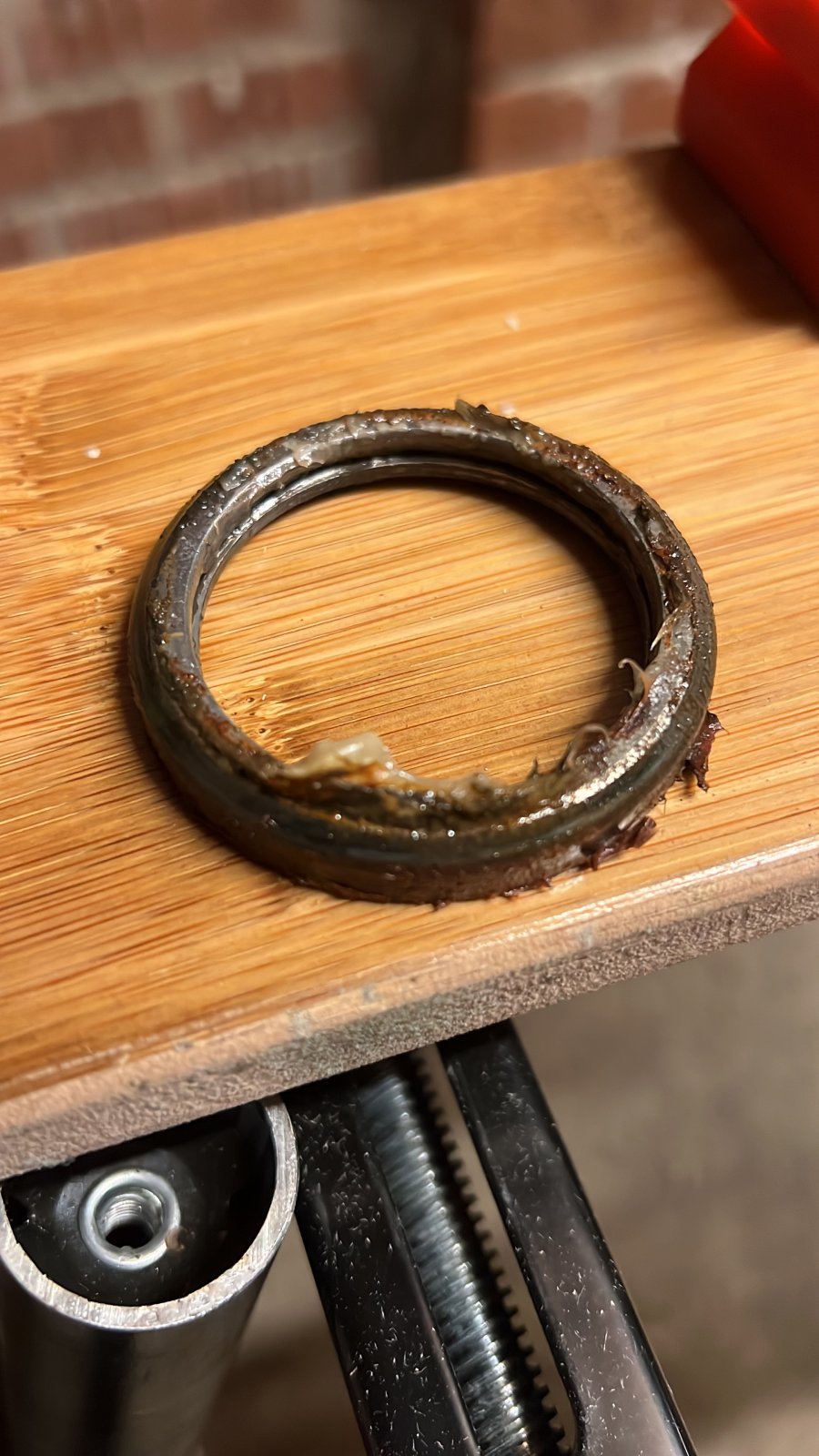

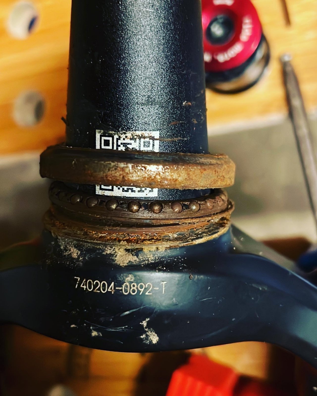

But more amusingly..... my FSA bearings fell off and look like this....
can anyone say fubar?
I spent 30 minutes trying to work out from the FSA codes what I needed to order. Then found this.

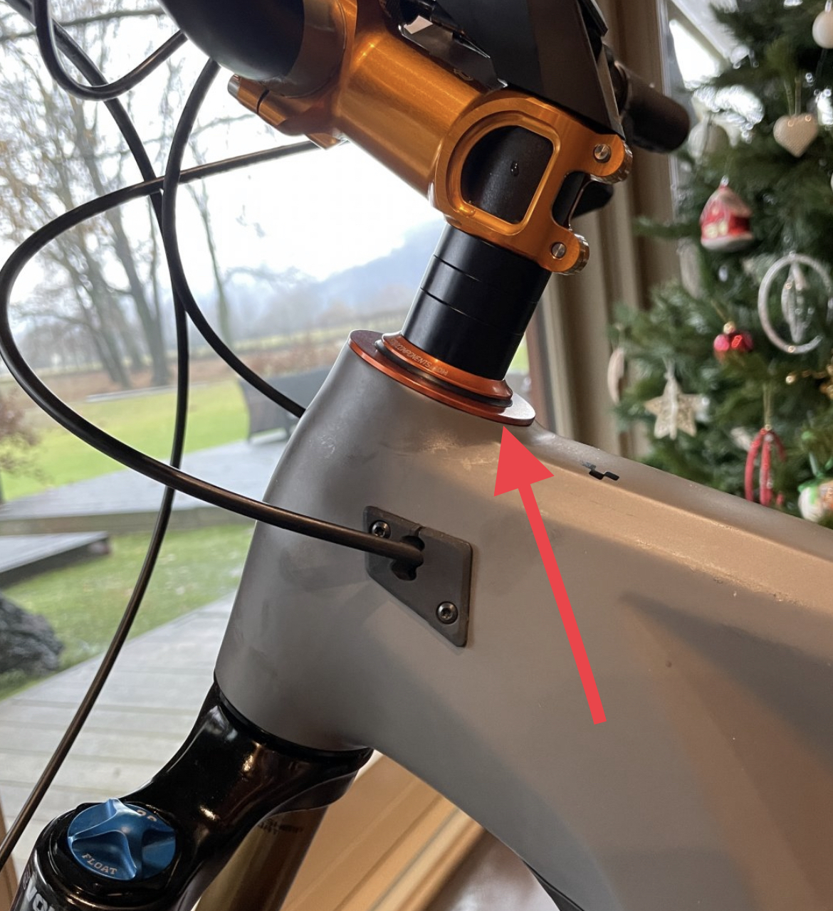

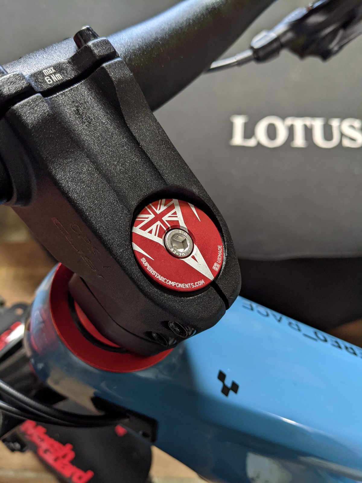

Got mine all fitted today. Definitely not a fan of the flat style - makes the stem look kinda fragile poking out of a big sturdy frame lol
BUT quality is soooo nice, fit was perfect, bearings look a lot better quality than the FSA ones. So I'm happy :)
