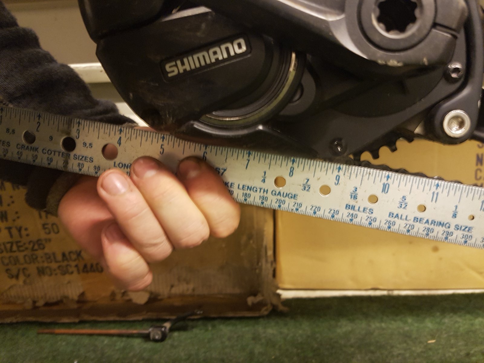

This is a well known issue, poor walk assist on Steps8000. The problem is the motor angle, programed in by the manufactur of the bike.
Go to your bike shop, and let them check, that the mounting angle of the motor, is the same as programed by manufactor.
Use an angle app on you phone, and measure on the flat spot under the motor.
Mine was 10, programmed in 17, when changed, i had Turbo walk assist :)
Almost every Merida i have sold, had this problem.
I've noticed mine is set to 15 degrees from memory. There is no way to change this is there?
Only Shimano tech guys, or the brands representative, have privileges to enter those settjngs, not bike shops. They can see what angle is programmed, in diagnose, but not change it.
This is where you measure the angle.
