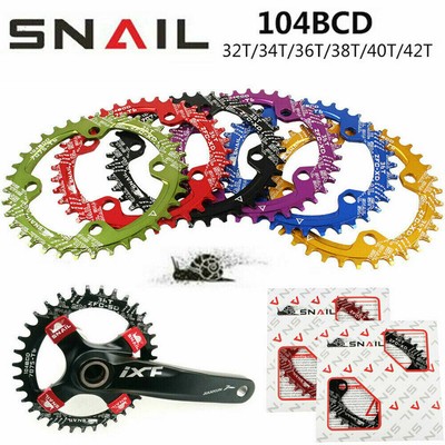

I just put an inexpensive 32t chainring on and it worked perfectly. I bought 2 extra ones too at the $9. price. Very quiet and no issues. I tried this once with a few other brands and had some shifting issue but this one worked. Price just went up by a $1.
