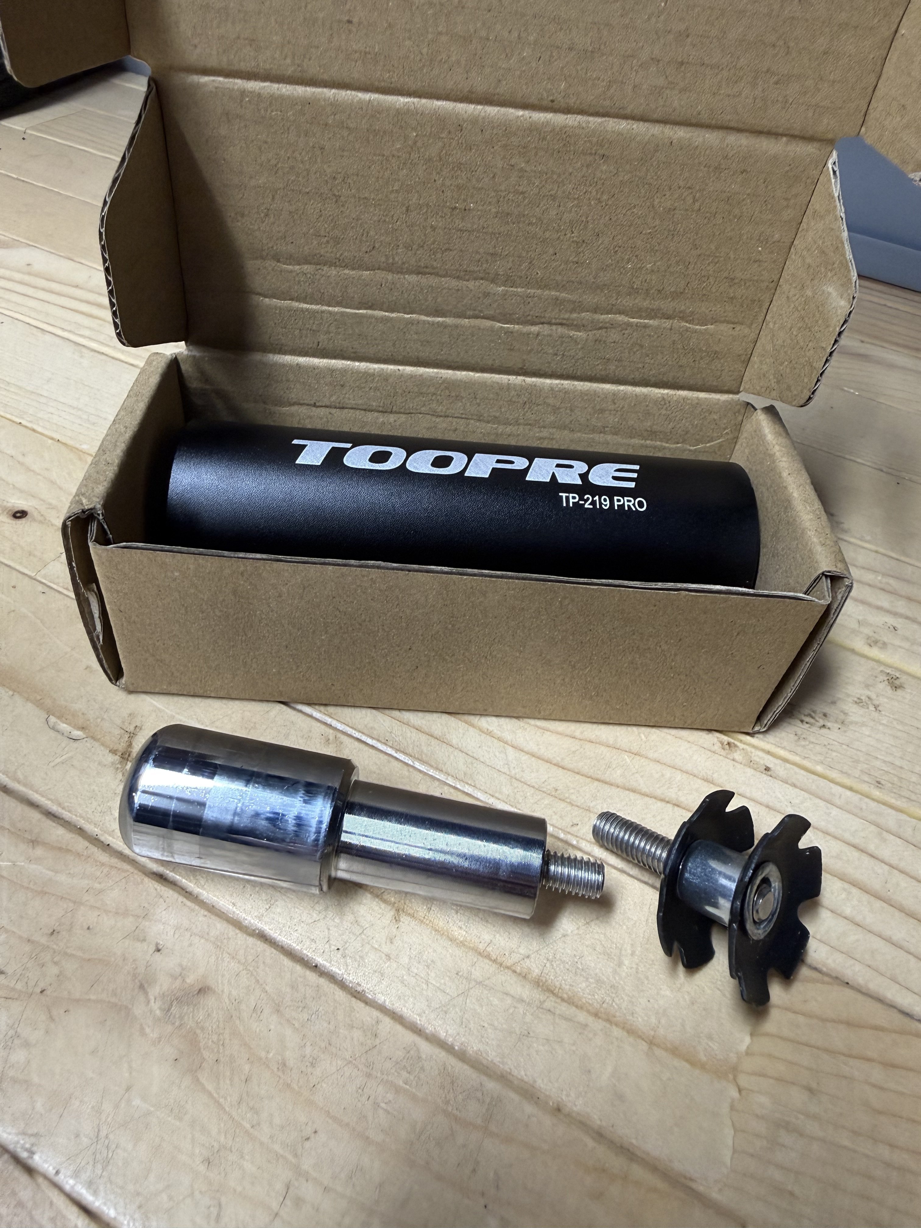

If it would make you happier, just do it. Amazon has eight star nut's for $5.99. If you're not sure if you can drive it in straight with conventional tools, you can get a star nut with the installer tool for $5.24. For the price of your morning Weetabix, you can solve your dilemma and live happily ever after.

…a star nut setting tool is worth it - cheap and you'll get it centered and at the proper depth every time.

I ordered new nuts with the tool. Drilling the old nut out and inserting a new one should be pretty straightforward :D
