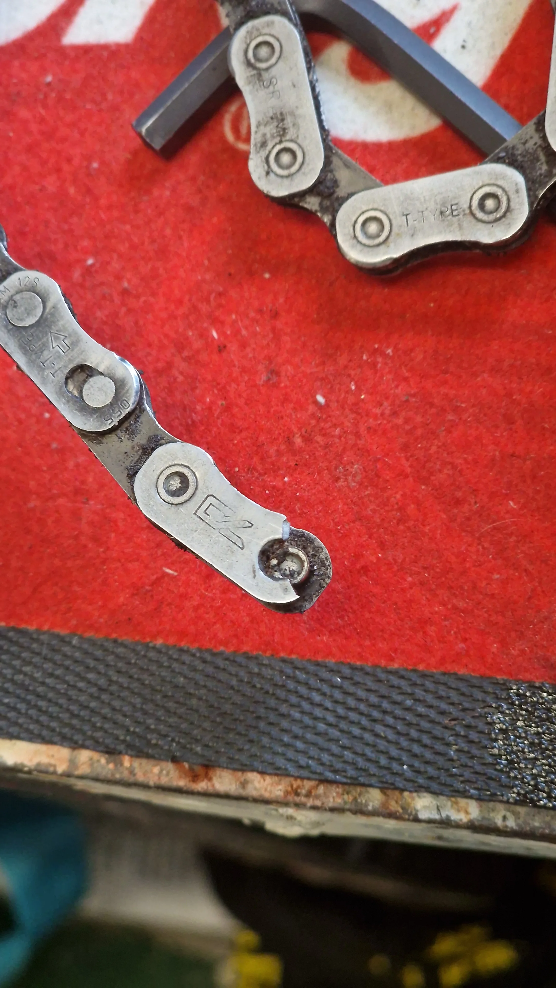

Well after my last post my Eagle 70 T Type chain snapped at 399km. GX replacement from tredz now on the bike.
Time will tell how this one faires, what from what I an ascertain I should not be degreasing after every ride but the failure looks more mechanical to me. If the new gives out sub 500km I'll be swapping to KMC I reckon.
Time will tell how this one faires, what from what I an ascertain I should not be degreasing after every ride but the failure looks more mechanical to me. If the new gives out sub 500km I'll be swapping to KMC I reckon. View attachment 183341
Yes your failure looks the same as mine.
The side plates breaking.
Don't think it's a wear issue, just not strong enough.
