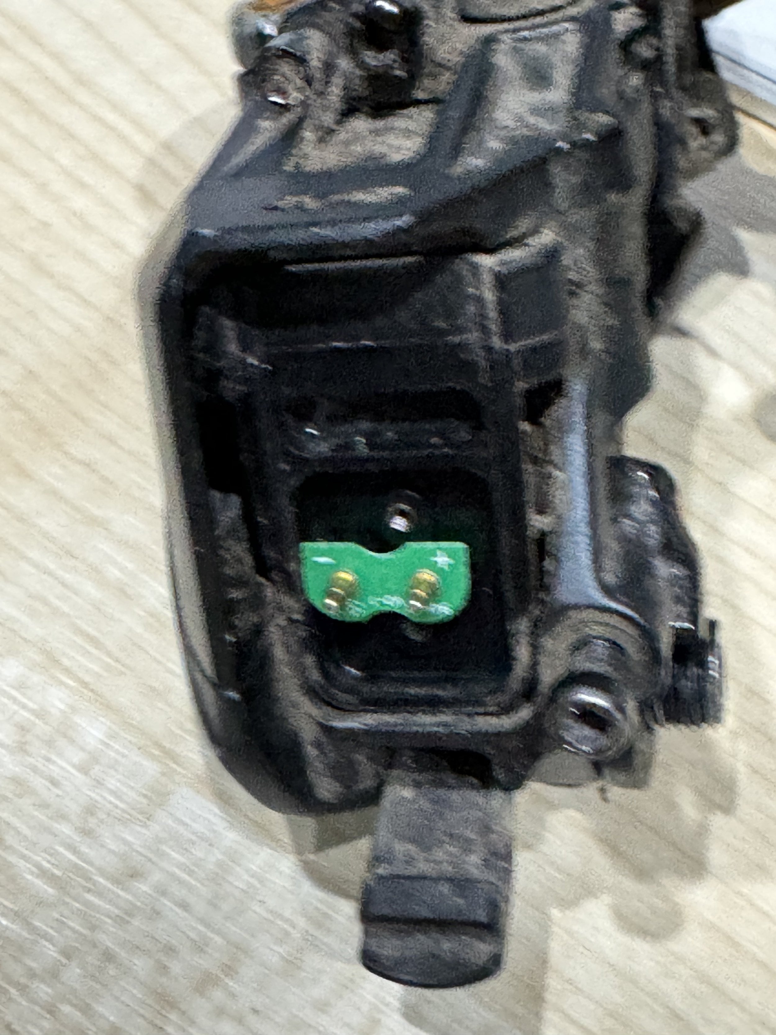

I bought a second hand SRAM AXS derailleur from eBay some months back, very quickly I noticed there was intermittent power issues. Eventually it stopped connecting and it appeared to be the little pins (pogo pins) not moving free enough.
I stripped it down and ordered 100 pins from Amazon, a friend who has the skills soldered the new pins (very tricky due to size) and it’s now working like new.
If anyone needs to do this fix please contact me and will happily post some pogo pins for the cost of a stamp.
Mine failed in the same way, I did the same fix, but my soldering skills were not quite up to scratch, and the first attempt failed after a few rides. I've resoldered them and hopefully this fix will last.
Can you link to the pogo pins you bought?
Hopefully this link works:
Mxfans 100x Gold-plated 6mm Copper Probes Spring Pogo Pin Connector https://amzn.eu/d/1ZtRbwI
If you need some spares just IM me, I have 98 left!
I am wondering if a bit of grease would help them, I suspect they got damp and the spring has corroded inside.

I have had this happen on a GX AXS and a newer T type GX AXS. Mine were both replaced under warranty but
SRAM diagnosed the problem instantly so I think it is a known design fault. Seems like a lot of people with the same issue.

I took mine to e-bike motor repair and they put in replacement pins.

I don't think it's caused by water, mud etc, I just think it's down to crappy component choice by sram.
I've just had my t type derailleur fail in exactly the same way as my old gx axs derailleur, one of the pogo pins fails and stops contacting the battery. It's really unacceptable that this happens and means I could not recommend axs to anyone after my experiences. If you Google people are getting this fault with all srams wireless components, road bike stuff, seat posts etc.anything from sram using the pogo pins can fail like this.
Anyway, I have currently fixed mine by soldering a small blob of solder on top of each pin, it's now working, but who knows for how long.

Interestingly the pins (part number P70-2100045R) are not something I have seen failure reports when on the Reverb dropper seatpost. And they fail on the derailleur more often than on the charger. It could even be because of the vibration cracking the components. I will appreciate it if you do not make a straw man argument. Thanks.

But on to your statement about the pogo pins. I think you might be on to something about the vibration at the derailleur vs the vibration at the seatpost. Or maybe the environment is a factor. The derailleur gets more water and dirt than does the seatpost. But I don't have enough data to reach any conclusions. I put over 3000 miles on my AXS, and over 1700 on my Tranny without any hiccups. The only guy I know who has had a problem had less than 1000 miles on his. But he's the guy who washes his bike and shows up at the trailhead like he's trying to win Best of Show at the Concours d'Elegance. Like I said, insufficient data. But just to be safe, every once in a while I get a little silicone grease on my finger and wipe the rubber seal on the battery. I've thought about giving the pins a little squirt of electrical contact cleaner/lubricant, but worried that it might actually create problems where none previously existed.
To my knowledge it is the environment non the pin themselves nor vibration. The wear occur to due to dirt/grease/water/moisture etc, like I said this is a common problem on similar product with pins where they are in contact with skin/moisture/dust etc.
Charger is totally clean and do not walk in mud, I hope as I do, people clean their battery and dry them if they are kind of wet before charging. So this is not relevant at all to compare it to the pin on the derailleur.
Honestly this is not something new or proper to mtb, depending on environment "hazard", the pin collect whatever micro debris/water/moisture and die, note that there is no way to fix them without breaking them - at least I have never found anyone succeeding when they do not expand as they should.

I found some small o-rings which go around the perimeter of each pin. It provides a secondary seal and also limits the amount of compression on the pins. I implemented this idea when I first bought my gravel bike about 6 months ago. No issues yet but we shall see. Even though SRAM doesn't see this as a significant issue, hopefully they one day will change the contact design. I also see challenges with their seal design which has a industry standard ceiling capability. This was another reason why I put the o-rings in play.
Clean my bike today and got that pin down and stuck ... God dammit! I ride at the moment in a very dusty condition so definitely something got into it. Obvisouly nothing worked to put it back extended.
I made a very dummy solution: some alloy foil fold and some adhesive to stick it to the battery.
Seems to works, not sure for how long but I guess a little ball of tin might be a superior fix :D
