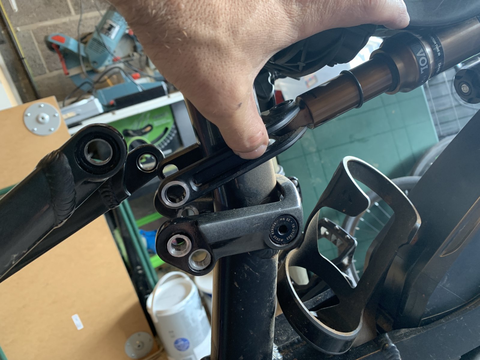

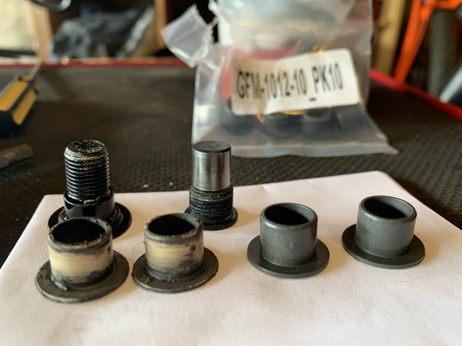

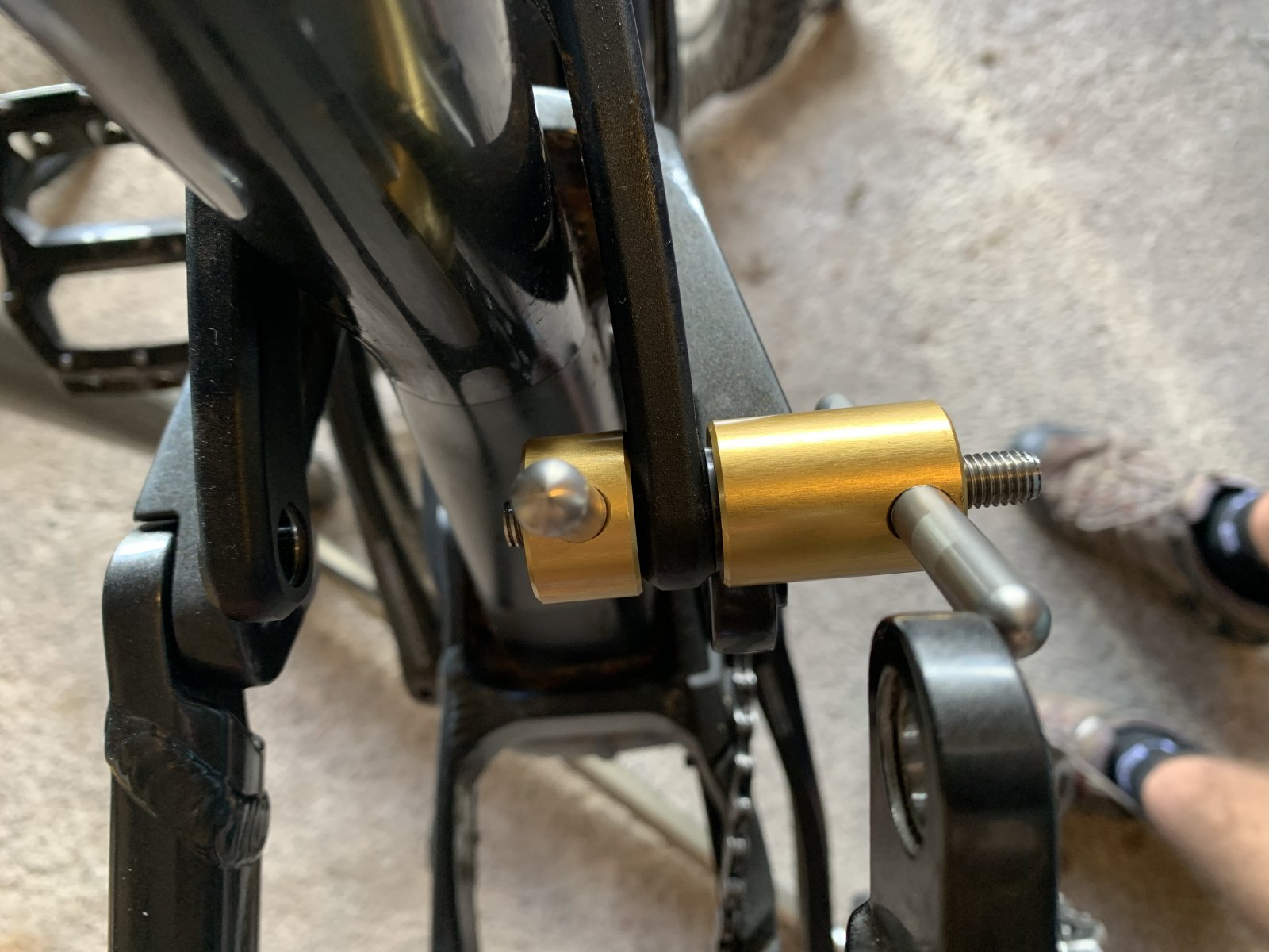

I noticed some play when lifting the rear of the bike, so decided to check the bushings. Took 20 mins going slow and steady to replace them and play is now gone. Just in case anyone is interested, this is what I did:
Tools:
20Nm torque wrench with 5mm and 6mm allens (or was it 4mm?)
Shock pump
Bolt thread grease (I always grease threads)
Some threaded bar with nuts and washers, or a bearing press (or stronger fingers and thumbs than I've got to push the bushings in - lightweight!)
A bike workstand
GT85 and a rag
Job:
Drop the rear wheel out
Let all the air out the rear shock (note psi)
Remove the 6mm bolt
Remove the 5mm bolt (or was it 4mm?)
Pull the busing out with your finger nail or a flat blade driver
Spray GT85 into holes and clean with a rag - including checking/cleaning the bearings, mine were okay so not replacing yet
Press in new bushes
Clean bolt threads, grease and re-fit, torque to 20 Nm
Refit rear wheel
Pump up shock
Lift rear of bike and see if play is gone. If the answer is no, you might need to replace bearings, but it'll probably be fine given the number of people who have had these bushes fail. And see my earlier post re buying a pack of 10 of these for £6.50.
