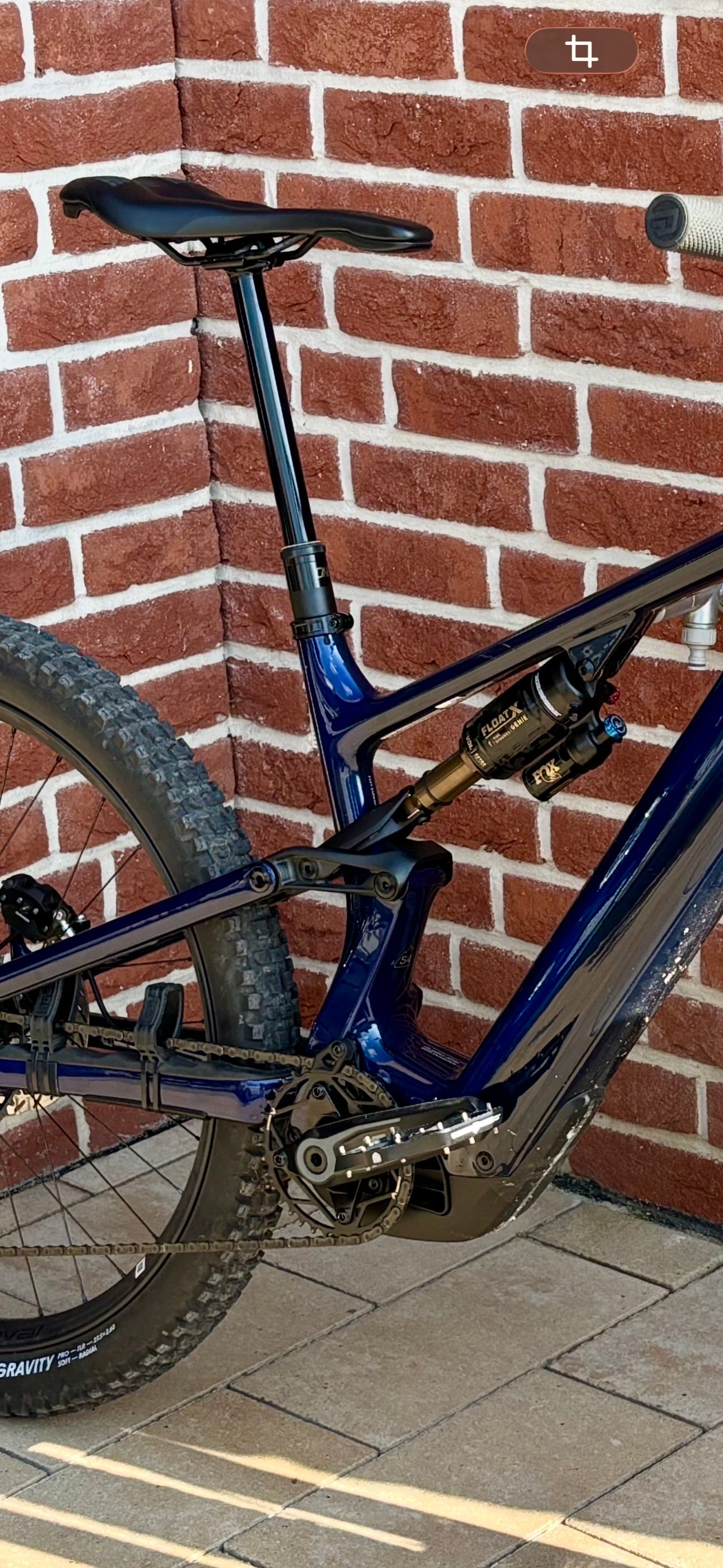

Anyone fitted a slammed 240mm dropper post? Looking at going 210mm or 240mm slammed if I can get away with it. Currently have a lot of post out.
I've got a 240mm OneUp on a S4 Frame, its not quite possible to slam it completely, so it stays about 3-4 cm (one and a half inch) post out.
I've traveled it to 230mm to fit it perfectly for me. Best compromise to achieve the most possible travel und lowest post out for me. I've got rather long legs ;)
Spot on bud I got a s4 too. Thanks!

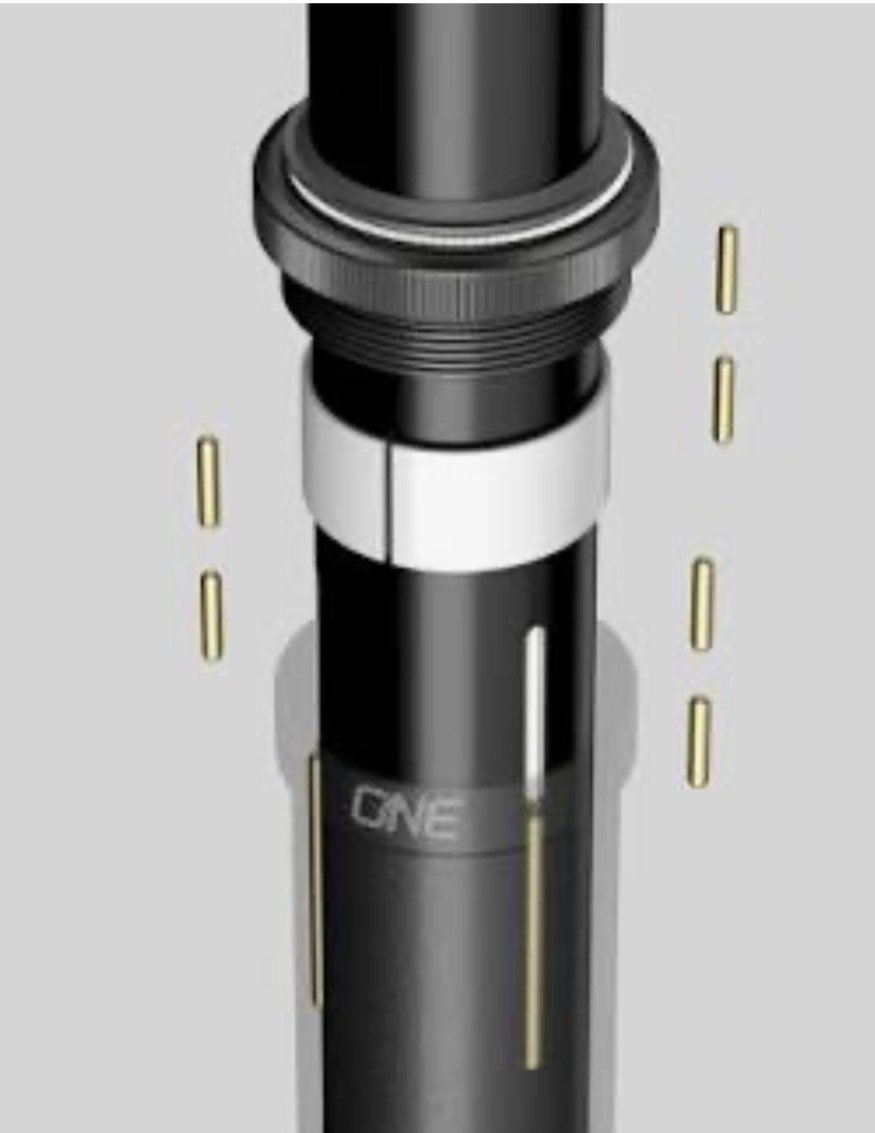

I’ve got the one up v3 on another bike but never changed travel. Is it easy to do?

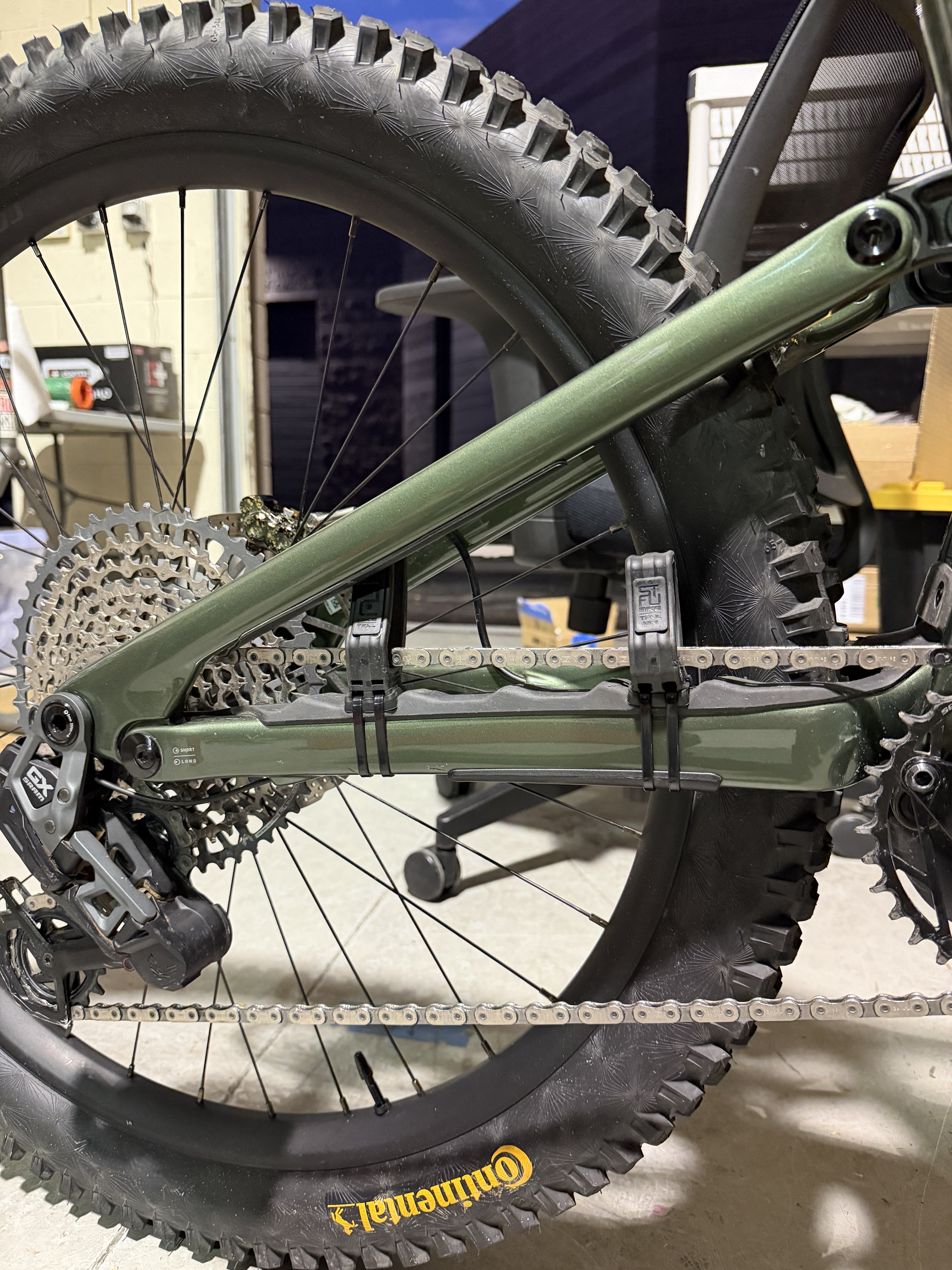

The STFU chain guides might be the best $40 I spent on my Levo.
I’ll have to pay a little closer attention but I’ve never noticed chain rattle/slap on the Levo.
Chain slap wasn’t anything I perceived as an issue, but my friend turned me onto the STFU guides and figured they’re inexpensive enough to give them a try. I was surprised by how much they quiet down the bike. Now I feel they’re not coming off; and if somehow they broke I’d buy a new set to replace them. I’m a fan.
Yeah its not really complicated, no need to deinstall it, just unscrew the top cap, extend the post und add the travel shim pins, just be careful not to lose one of these tiny pieces.
Well, I just placed an order so I will follow up and let you know what I think
Just placed an order as well. Can't say I've noticed this specifically as a problem, but a quieter bike can't be bad.
