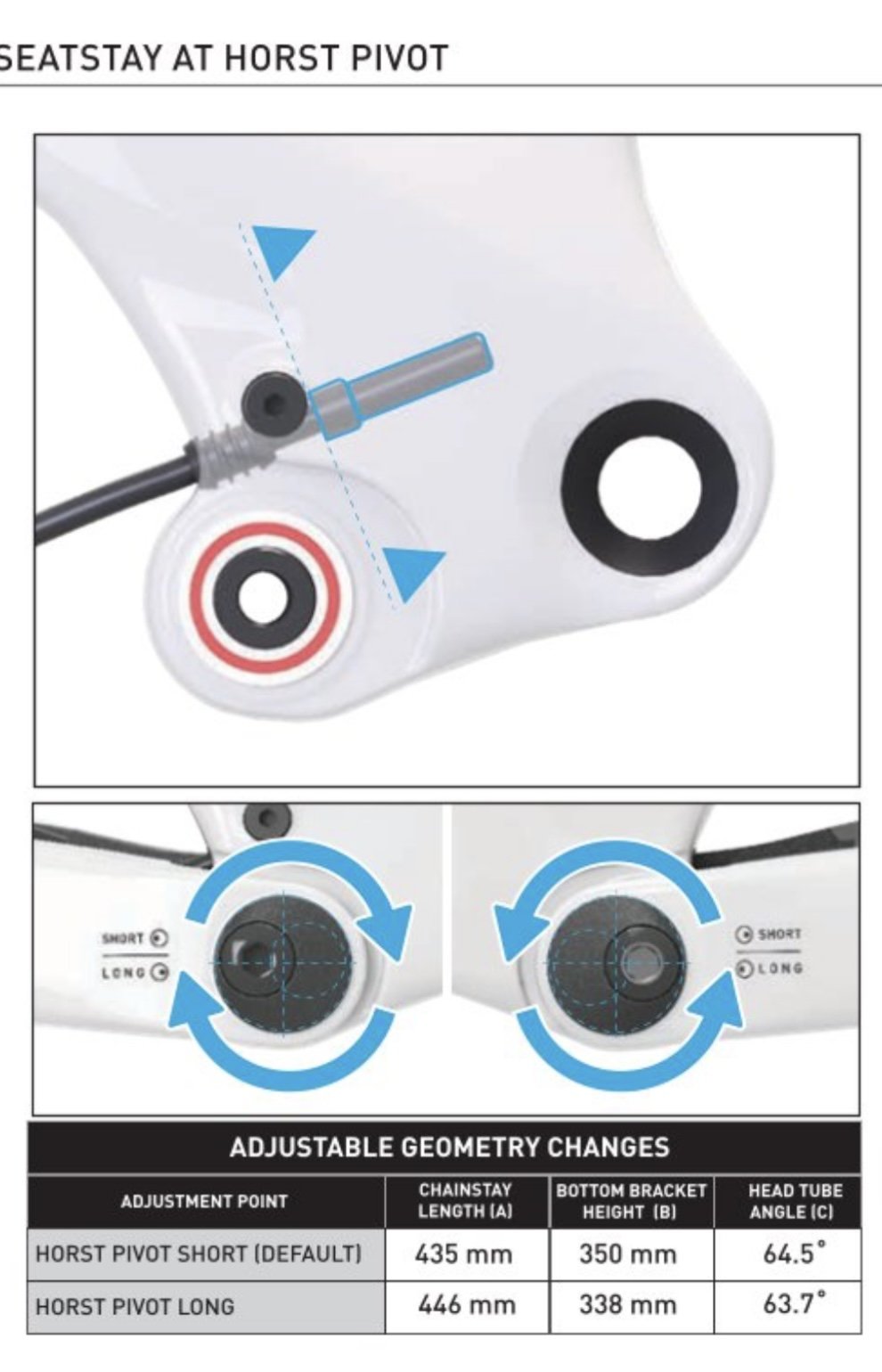

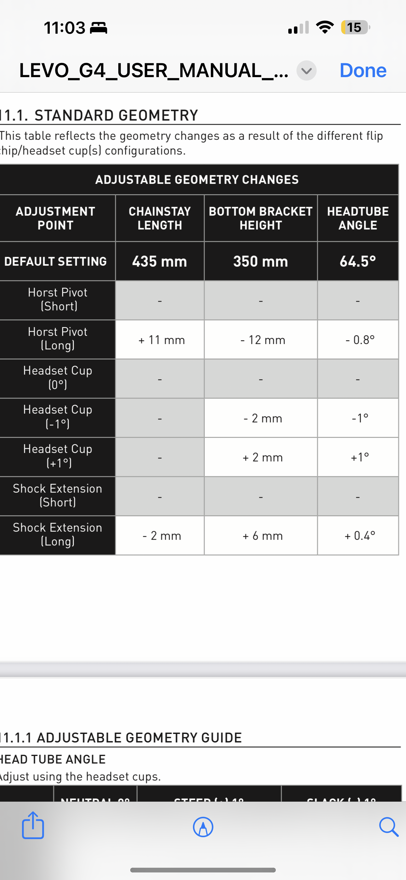

So running this Levo with long chainstays, does this not lower (and therefore slacken it slightly) as it did in Gen 3?
I know there’s a separate setting on the shock yoke that will lower it, but I’m looking at the bikes I don’t see how those chainstays can lengthen without it dropping the bike at all 🤷🏻‍♂️
I pick my Pro up in about 2 weeks!
I’ve managed to answer my own question with this looking through the workshop manual.
It seems the long setting lengthens the chainstays by 11mm to 446mm
As thought, it does lower the BB by 12mm to 338mm
It slackens it off a fair bit too…
That will be the perfect setting for me.
I posted some info from review few pages back, it looks like with longer chainstay BB height is even lower than should be.
''In the middle headset setting, low bottom bracket position and long chainstay, I measured my S3 bike's geometry as follows:
  • Head angle: 63.7-degrees
  • Rear centre: 445mm
  • Bottom bracket height: 333mm
The latter is interesting because it is significantly lower than that quoted by Specialized.''
I’d seen that thanks
Other numbers look bang on the money apart from the BB… good job mine will have those 155 cranks!
Certainly on the bigger sizes, those chainstays will work lovely in long.
Leaving the shock alone will give me a 446 chainstay which is perfect on an S5 imo.
