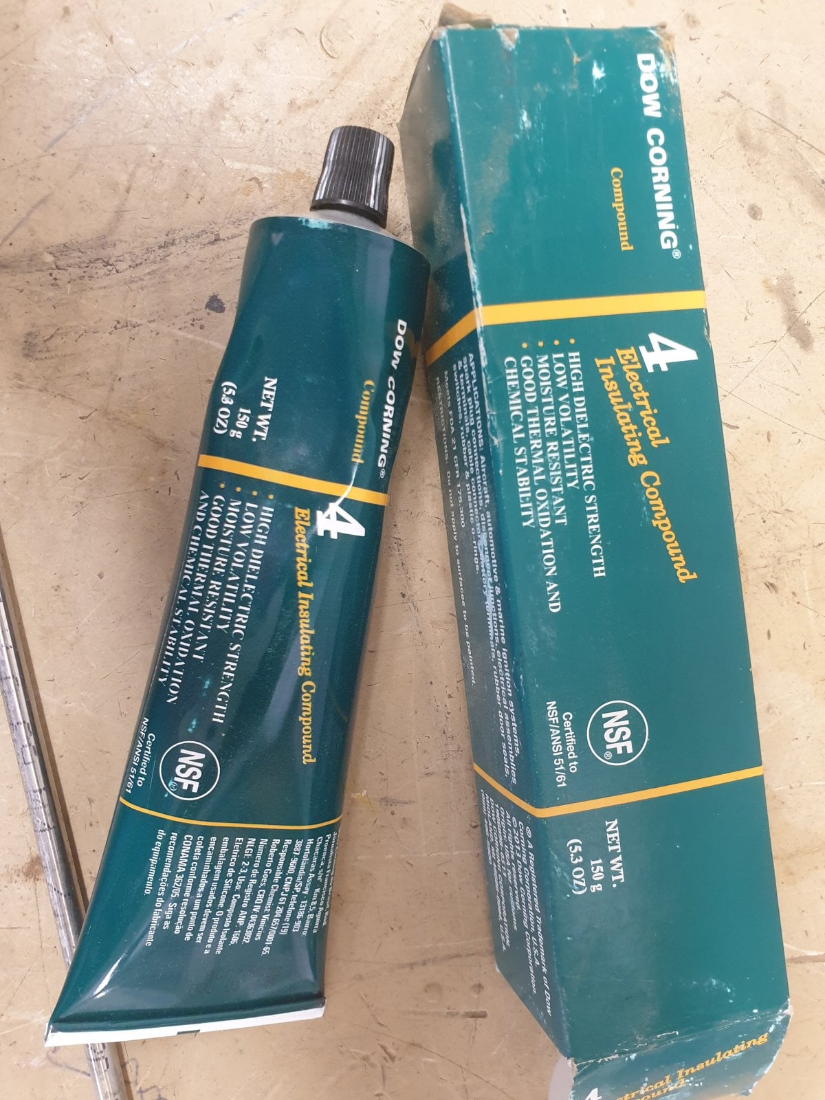

This lube is what we use for all electrical connections at work, to be noted that you do not put it on the actual wires / conductors inside the plug, but on the O-ring/ seal / gasket/ IP washer etc. Good stuff !!
Personally I use it on my seat post dropper after every ride, Only a really thin layer though

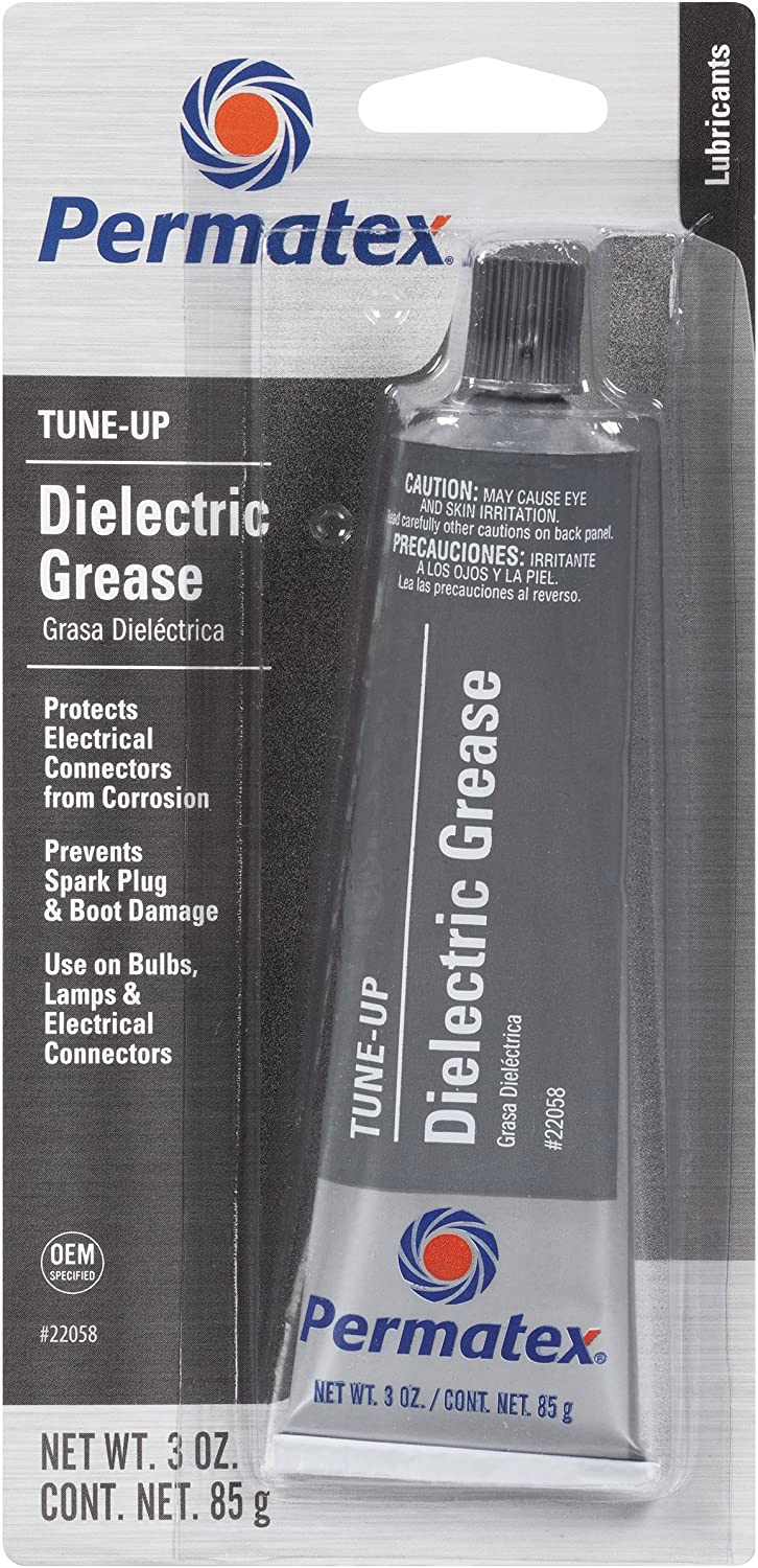

I use this grease to seal and protect electrical connectors:
Yes, just on sealing part of the connector before I put it in the opposite side of connector, I use very little, just to cover this seal area with thin film, I guess I have this tube for about next 200-300 years ...
Both sides of battery and motor cable. What about the TCU ones.
No, I don't use it on TCU connectors as with me it is not so exposed to water & dirt as motor/battery connections ... However I do have little bit of insulation tape over the USB port on TCU ...
Same here with tcu. Really paranoid now just got motor number three . So first ride out yesterday but need to try a few things to keep water out before i go out again
