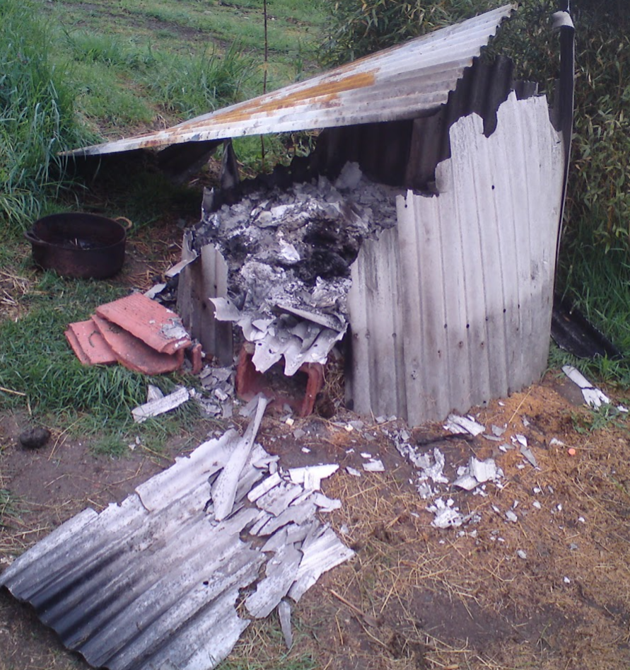

Years ago I quickly threw together an incinerator using some "tin" sheet .. except it wasn't tin, it was aluminium .. I didn't think it would get "that" warm .. Unfortunately it did appear to detemper ...... slightly. Or more likely, tempered - then shattered/combusted ... (660°C or 1220°F) Still, if you did the same in this instance, I think you'd get the bearing race out.
