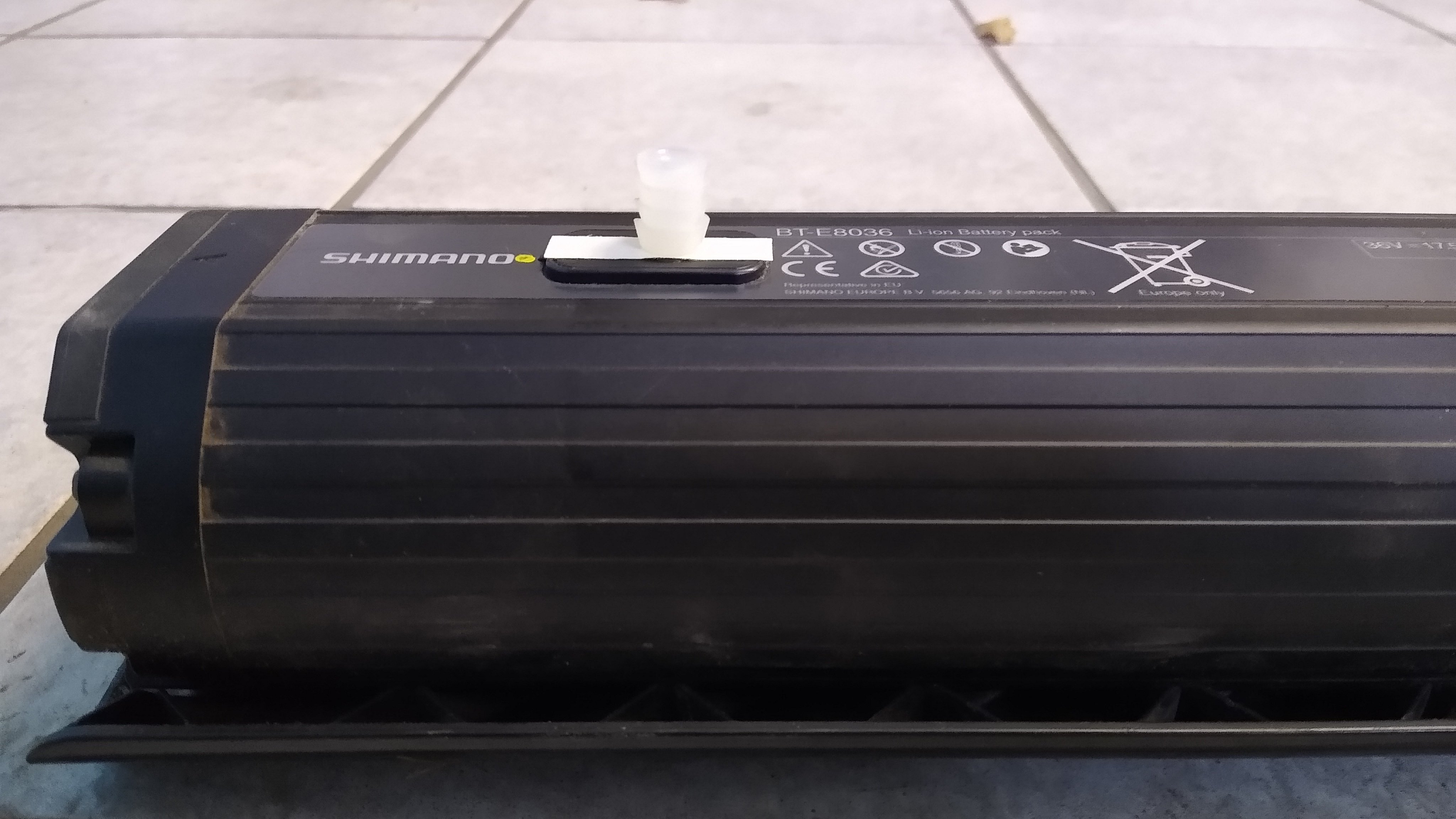

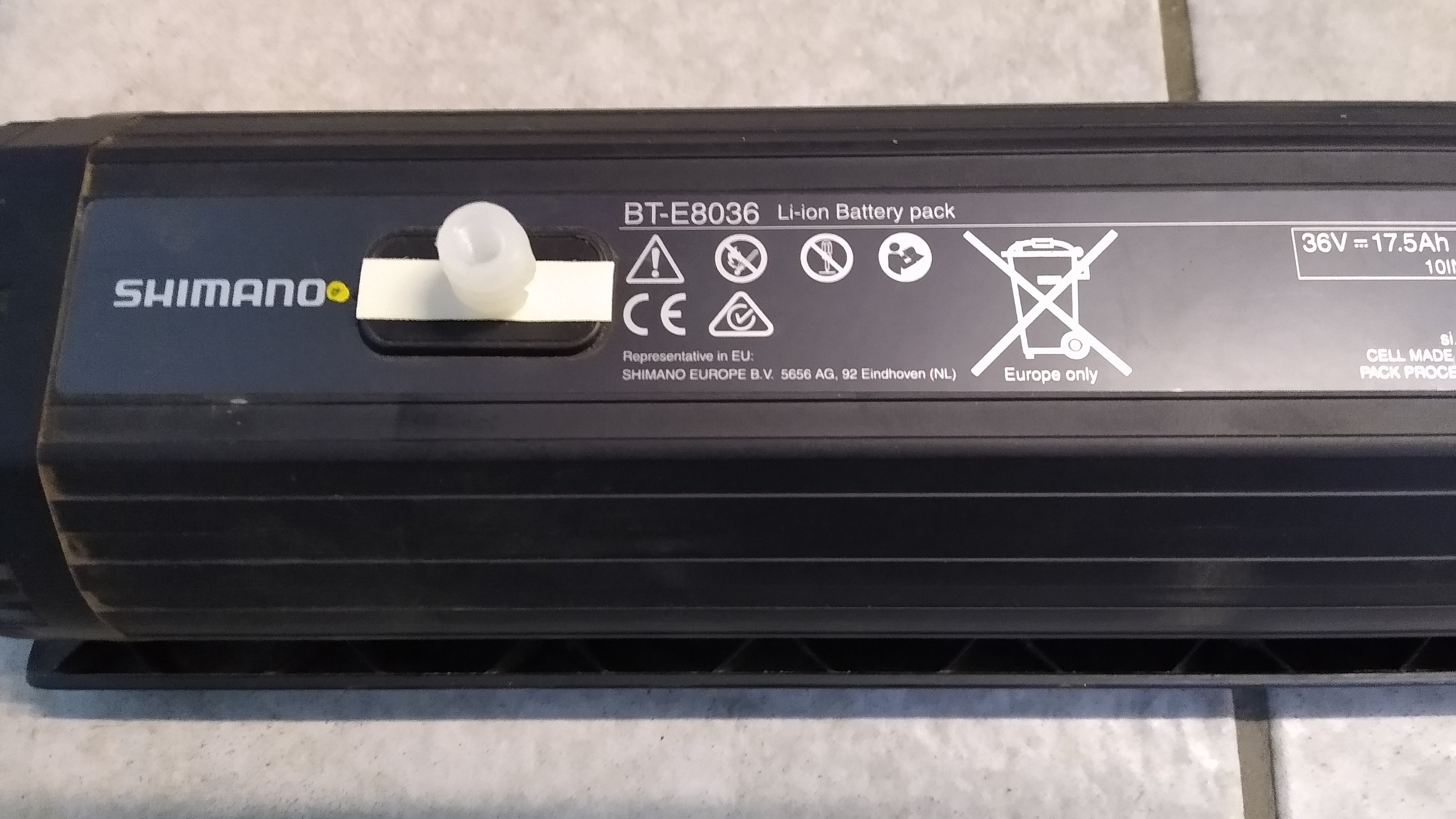

Had the same problem twice, both times after three days not riding. taped a 14 mm plastic plug to the battery start button and slowly pushed the battery in until display lights up and then left the battery hanging in the first lock, not completely pushed in, after 20 min i removed the plug , pushed the battery in and start the bike. My warranty expires in februari , then I will drill a small 2 mm hole in the frame above the battery start button. The yellow dot in the picture is the position of the bottle holder skrew, the new to drill hole will be invisible, covered by the bottle holder, approx 2.5 cm higher.
View attachment 103234 View attachment 103235

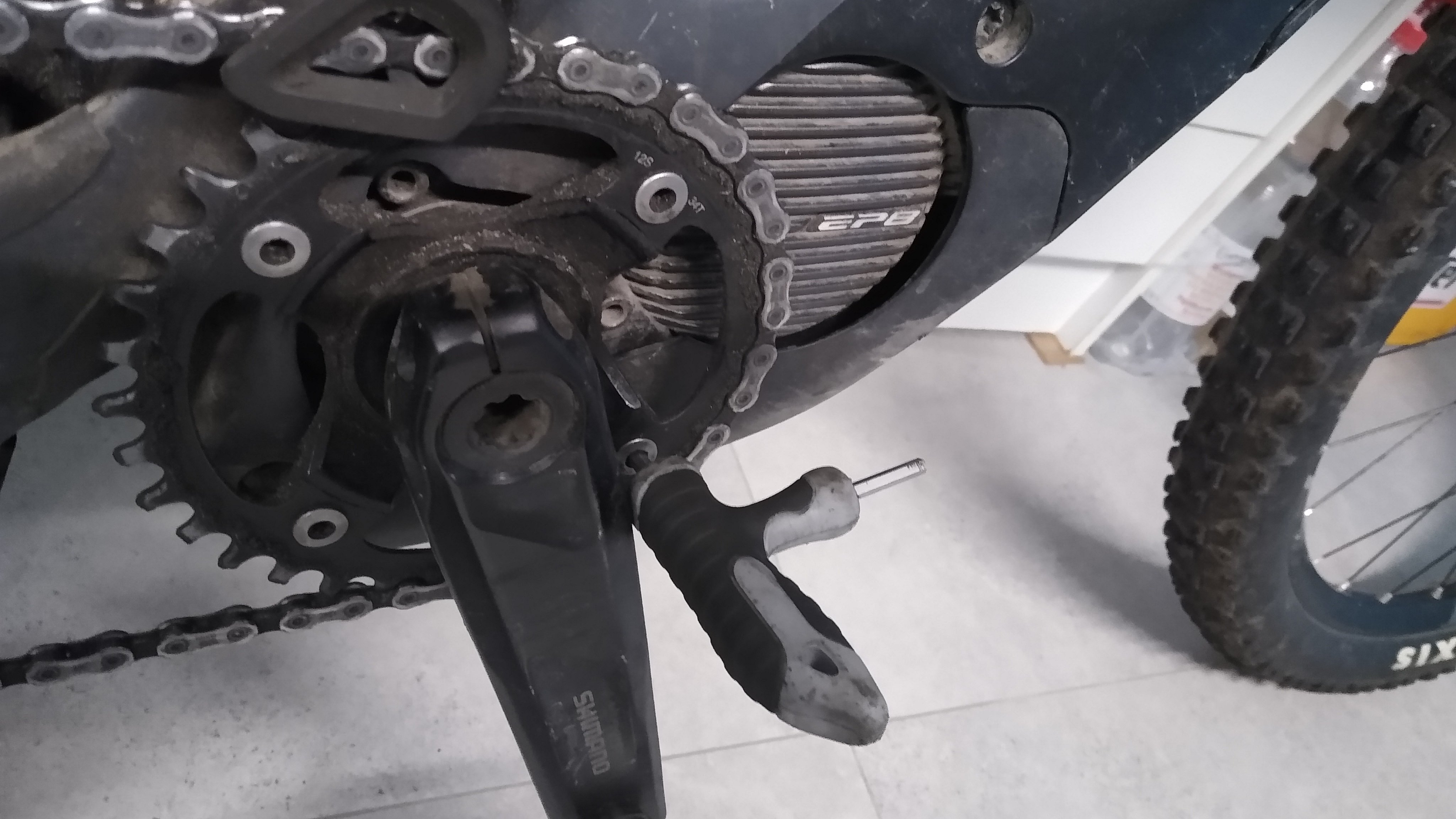

There might be another way to start up but I have not tried it yet. When cleaning/oiling the chain I spin the crank backwards (block pedal/chainring with allen key) when you spin back to hard the bike will switch ON, but this I havent tried with a dead start button battery. I've asked Canyon for a solution .
Excellent - basically exactly what I did. The lack of access to the main switch on the battery is a pretty silly miss. Thanks much.

When the problem is a flat power button battery, you can start the bike by pedalling backwarts. Connect the chainring to one of the pedals with a zip tie or if you have a spider, put an allen key in one of the bolts, pedal firmly backwarts and the bike starts up.
eph3
Nov 13, 2021
Thanks, it isn't there power button but I appreciate the advice.
