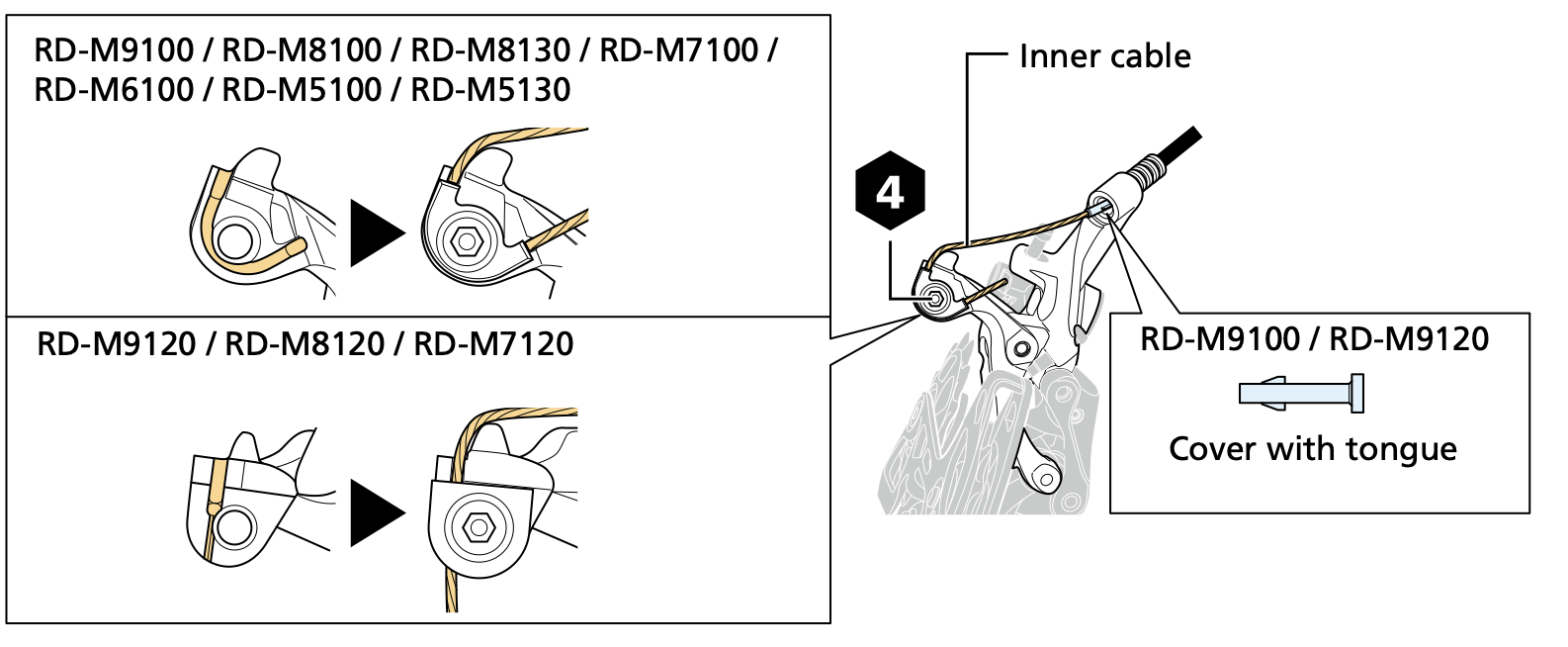

Had something like that and couldn't get mine to index so I reverted to the manual.
Is the cable routed this way?
