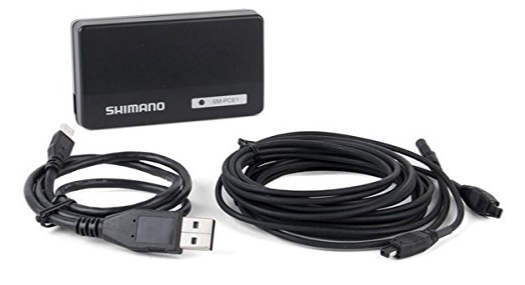

Ah it's officially a Shimano SM-PCE1 if you are searching :) Looks like this:
I believe there is a newer version too now SM-PCE2 or SM-PCE02 - maybe has enhanced communication or something? But the PCE1 works fine.
It's fairly costly, but useful if you are planning on doing lots of changes, or just like getting into the tech of it :)
I got from Amazon which seems cheaper than some places:
Otherwise, I always check Bike 24: Shimano Setting Kit for STePS and Di2 or Shimano SM-PCE02 PC Interface for Di2 + STePS
