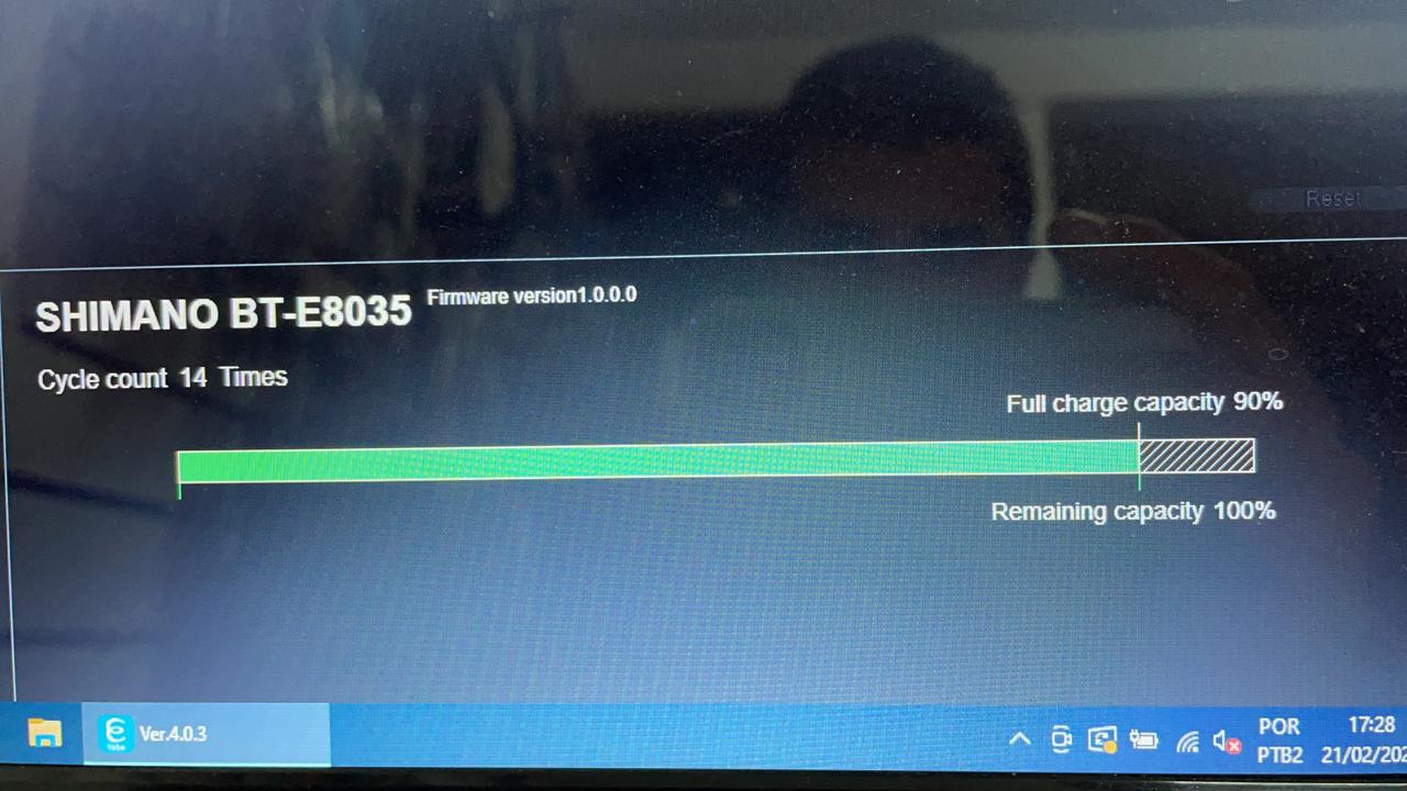

Shimano BT-E8035 Integrated Battery Issue: very fast degrading and loss of range

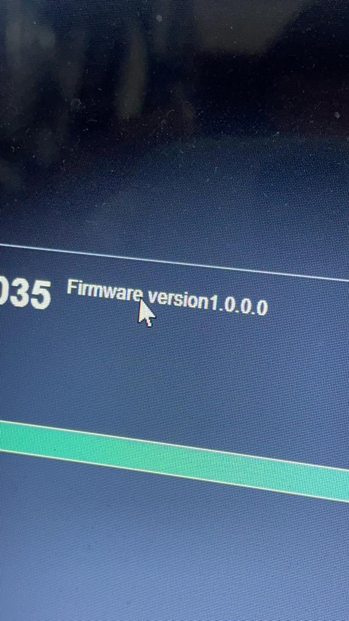

Firmware 1.0.0
14 cycles 90% health
Oficial shimano app.
it seems that the drop in the number happens every 10 cycles.
My battery has 161 charge cycles and 84% health
Using your logic it would now read 75% (10% drop after the first 10 cycles and a further 1% for each subsequent ten cycles?).
