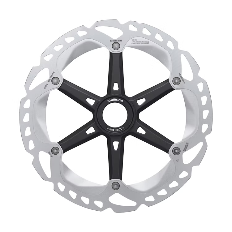

An example of this is the 203mm "Magnetic" RT-EM810 center lock brake rotor seen pictured below. In the United States, a 203mm "Magnetic" RT-EM810 center lock brake rotor, much like a unicorn, is almost impossible to source. To complicate matters further, Shimano prevents USA customers from purchasing Shimano parts from European vendors. Because of the scarcity, prices in the area of $100 to $120 are typically charged for the 203mm RT-EM800 rotor.

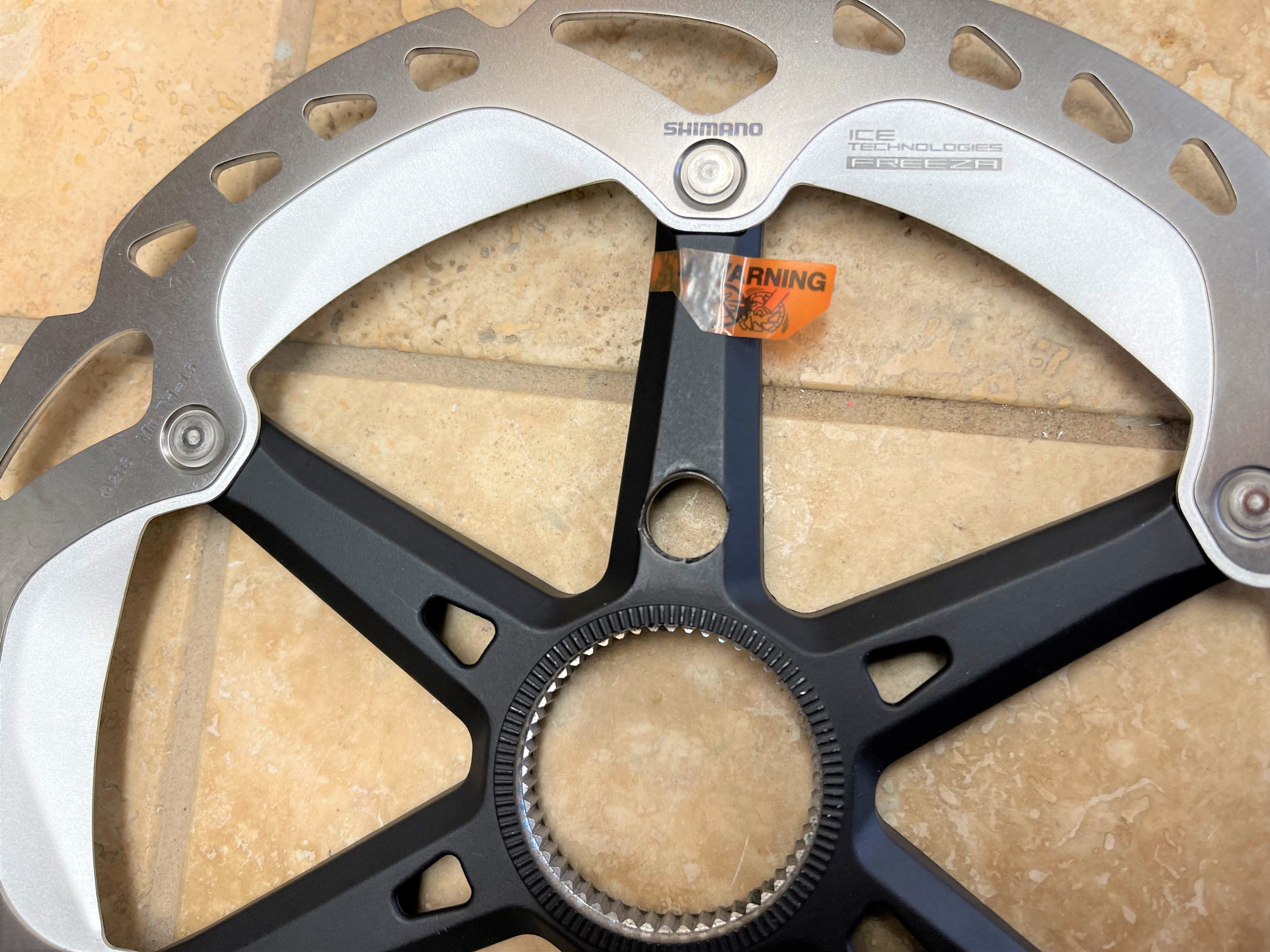

The "Non-Magnetic" RT-MT800 203mm version, seen pictured below can be readily sourced and commands a much cheaper price, typically in the area of $50 to $55.

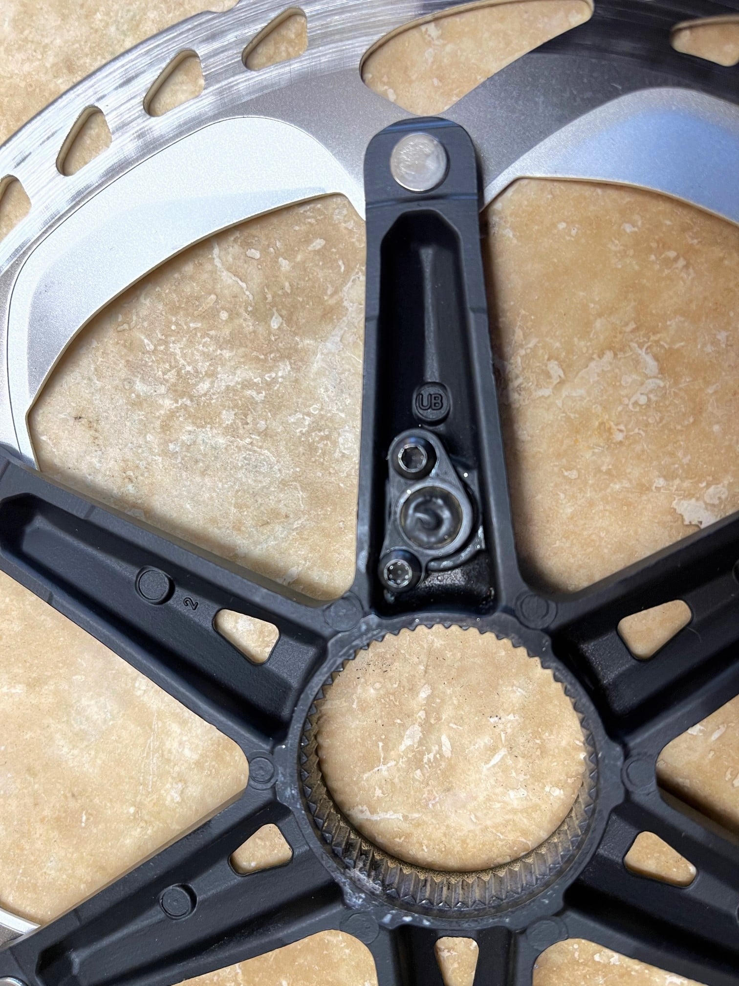

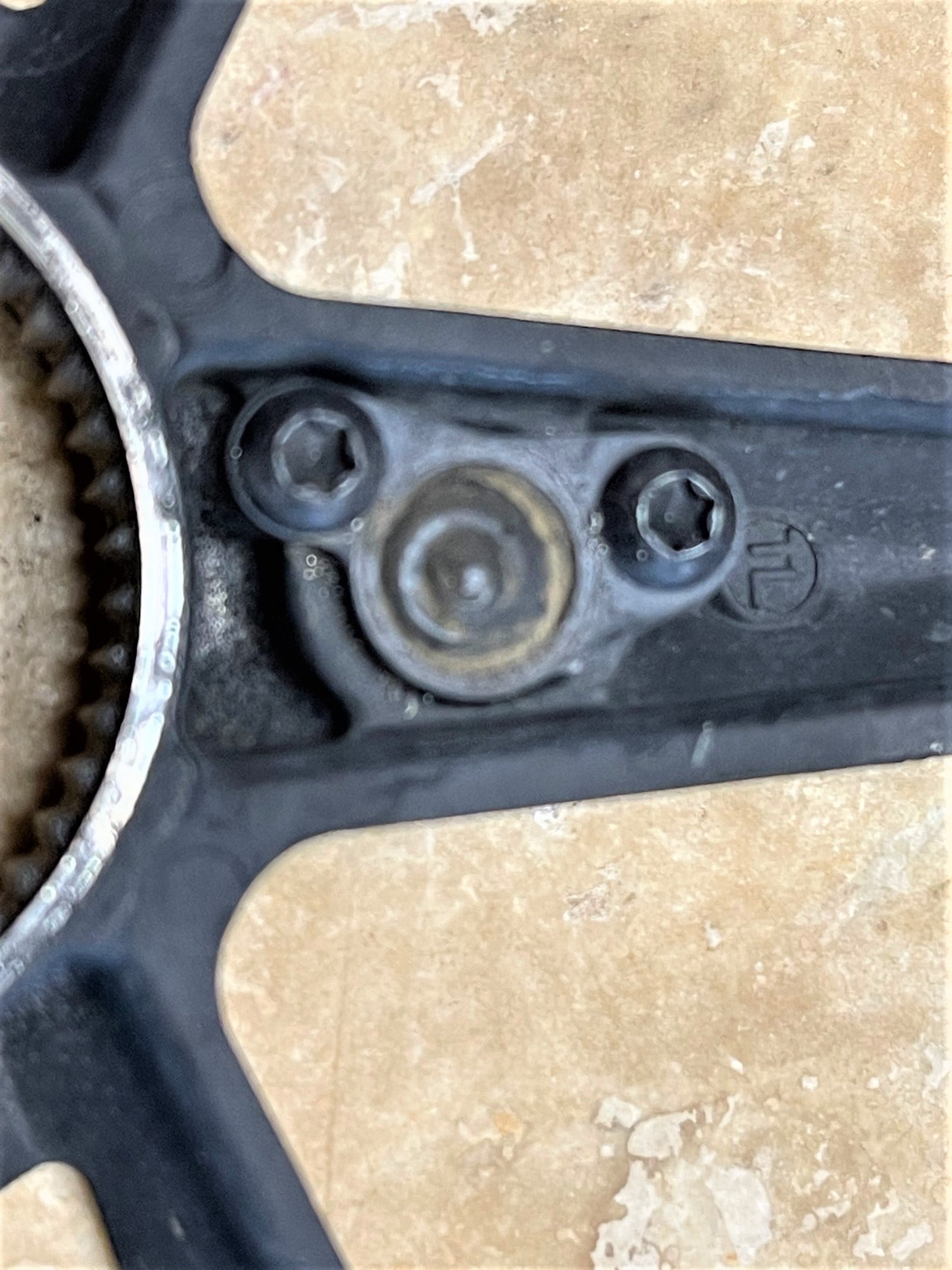

So....what's the difference between the two rotors? An examination of the back of the RT-EM810 rotor revels a removable magnetic insert which is held in place by two 3MM screws.
Backside of a RT-EM810 center lock brake rotor with magnetic insert secured via two 3mm screws

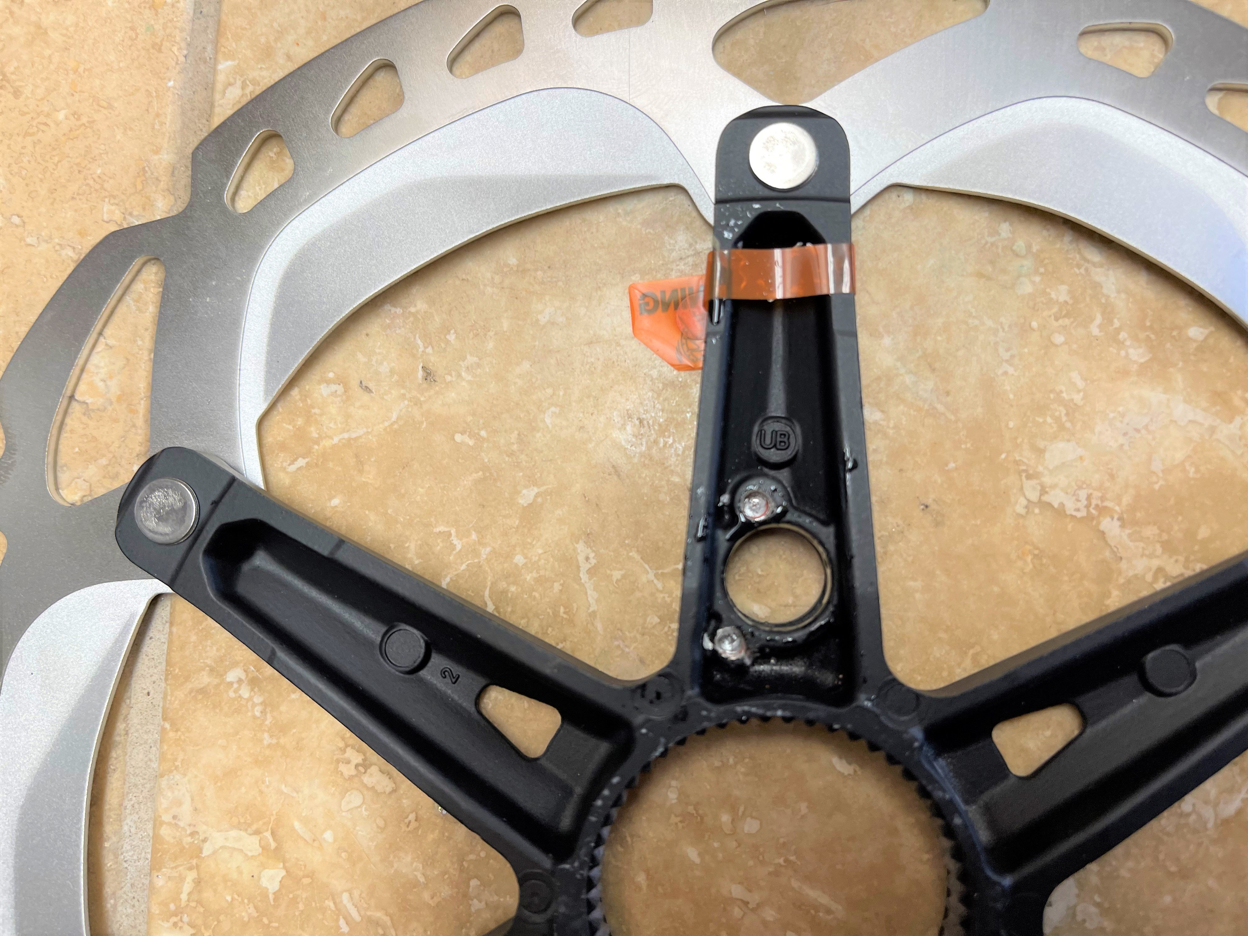

Backside of a RT-EM810 center lock brake rotor with magnetic insert and screws removed.

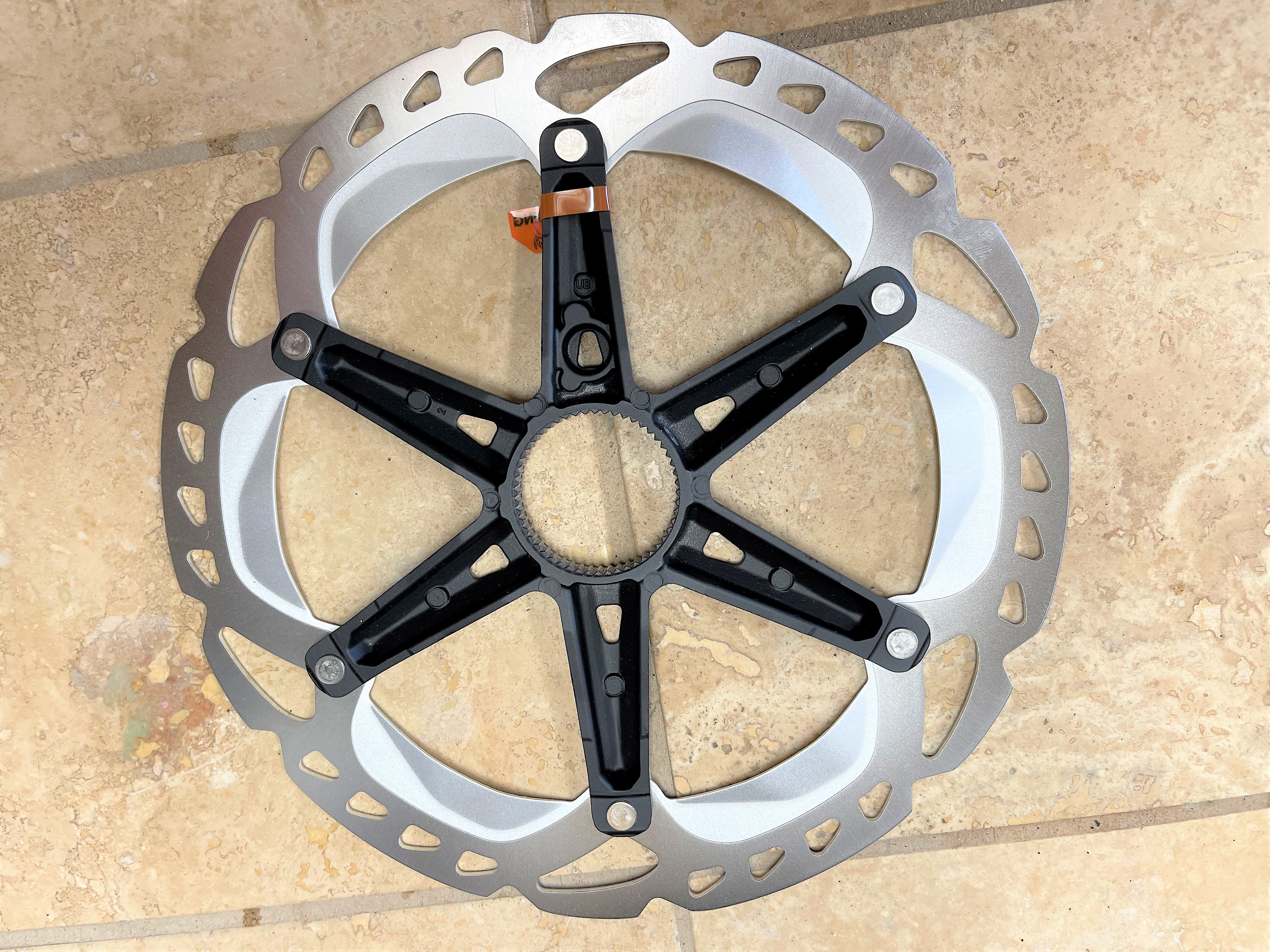

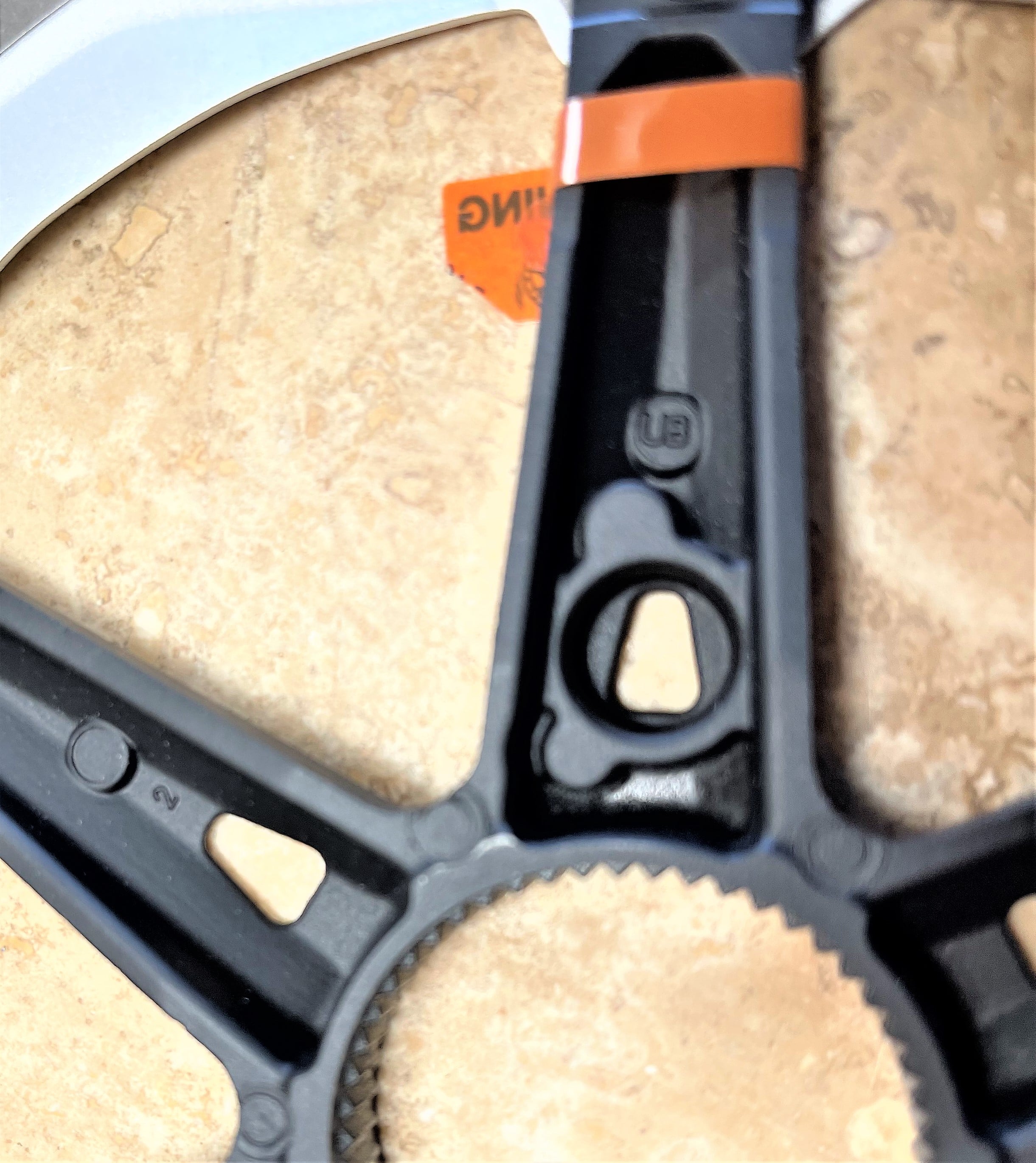

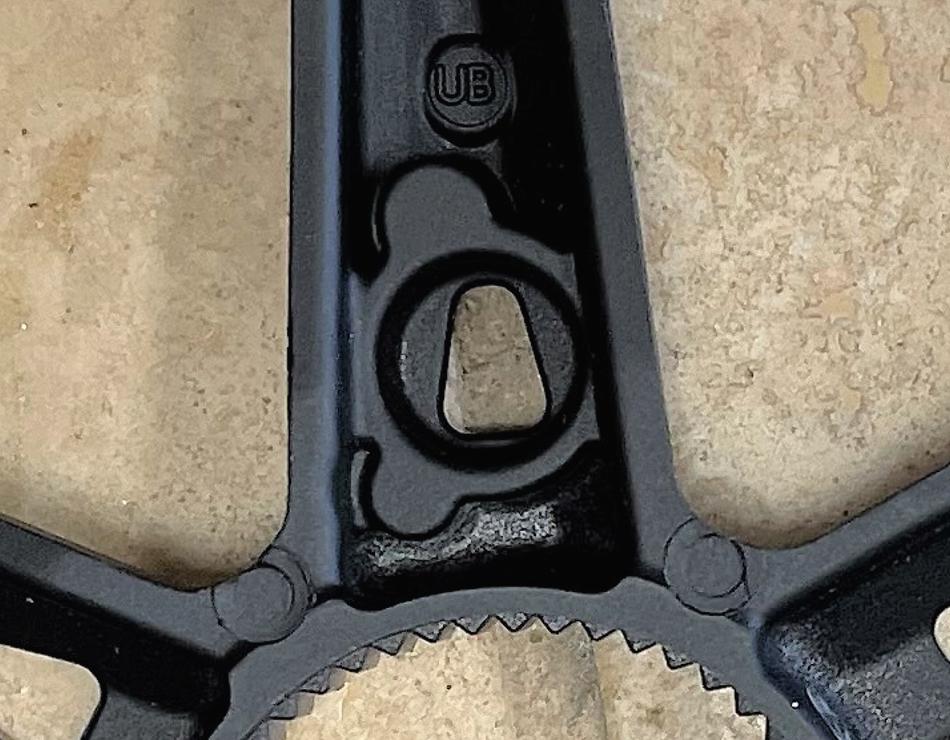

Backside view of a non-magnetic RT-MT800 rotor. It is identical to the RT-EM810 rotor, however the magnet assembly is missing and the hole where the magnet goes is not bored all the way through the rotor carrier. Also, the two 3mm screw holes are not drilled and threaded.
Close up view of the RT-MT800 hole

Frontside view of the same RT-MT800 brake rotor. Note the lack of bore hole through the carrier for the magnet assembly.

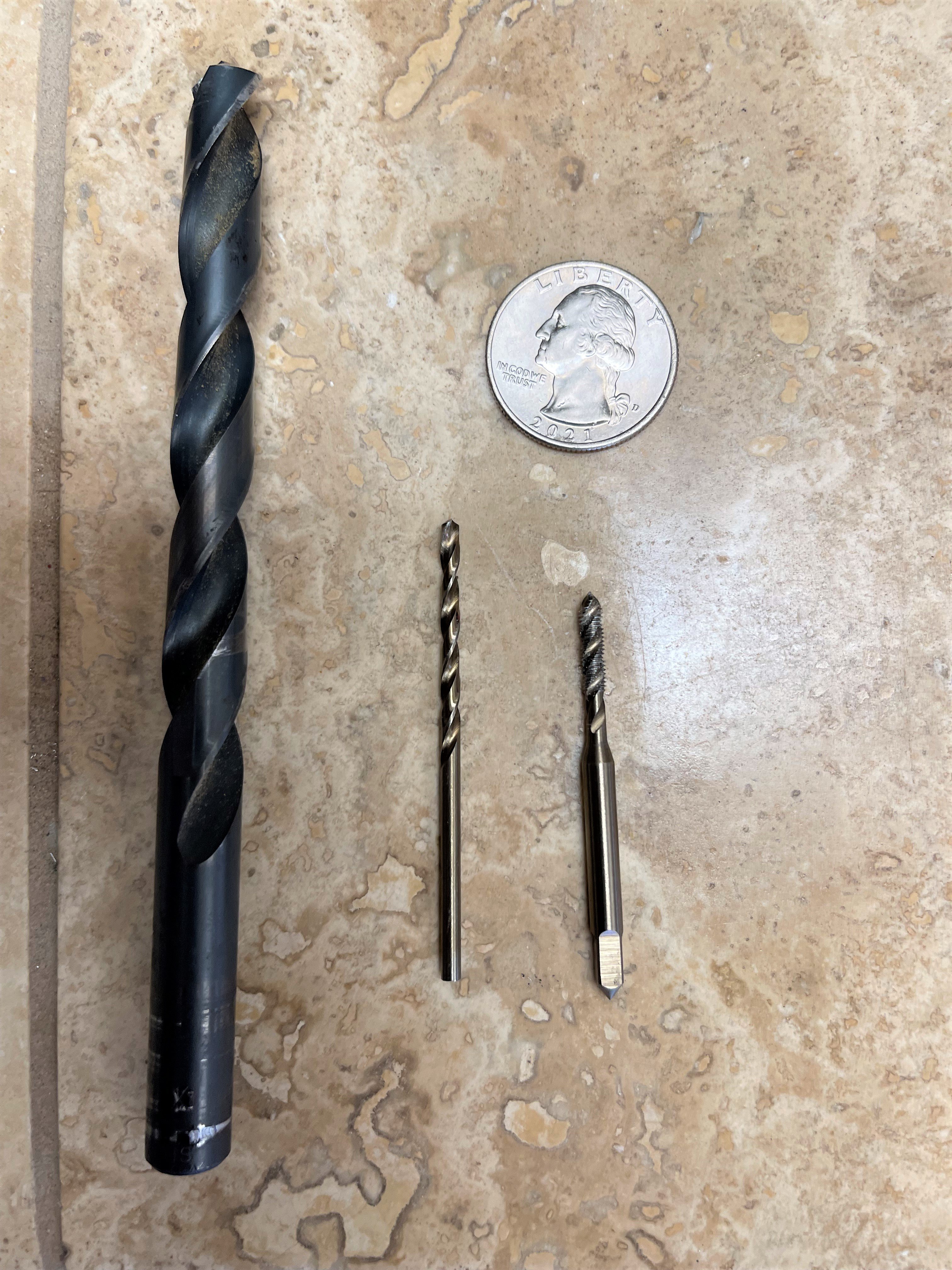

2. A "Metric" M3 x 0.5 Spiral Flute Tap and 2.5mm drill bit. I purchased a tap and drill bit set on Amazon for $9.49. Pictured below is the set I bought and used.
3. I used an American size "X" drill bit to bore the hole for the magnetic insert. If you have trouble sourcing a size X drill bit, a 10mm drill bit will work.

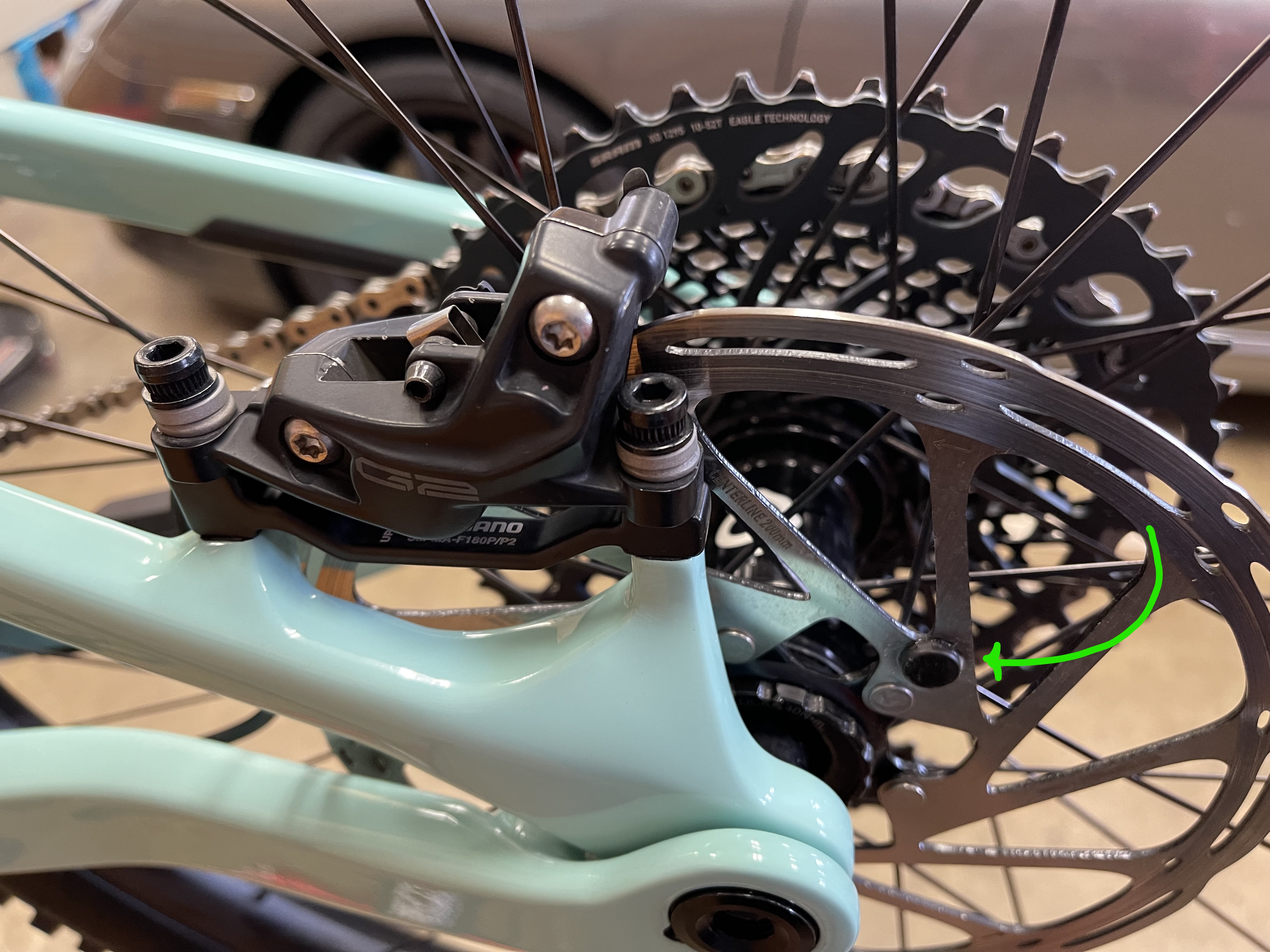

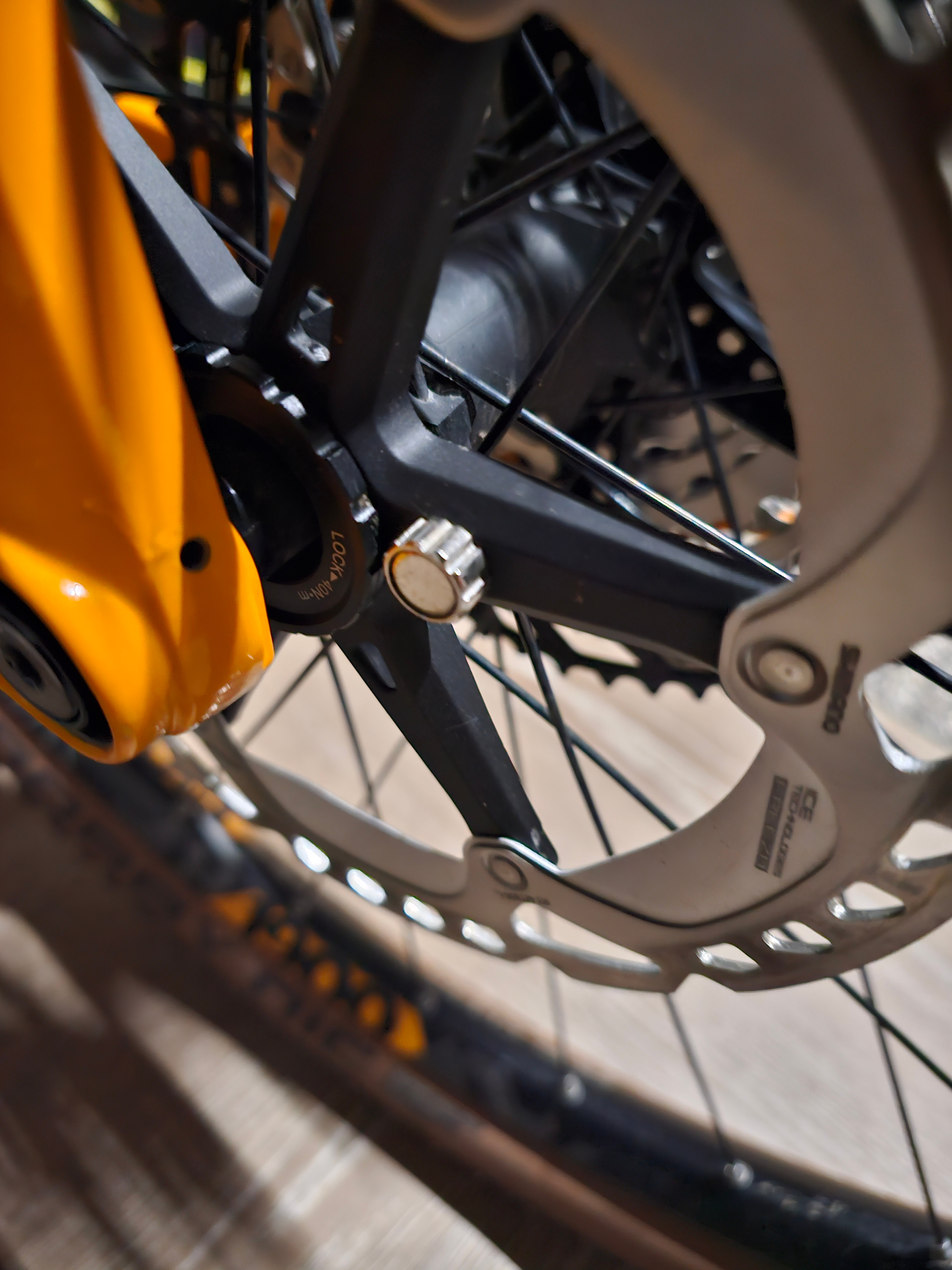

When I first got my Rise M20, I converted the two piston Deore brakes to SRAM G2 with 200mm brake rotors. SRAM does not make a magnetic brake rotor. I superglued a magnet to the brake rotor as depicted in the photo.
Supergluing the magnet to my rotor worked fine for awhile. After awhile however, I began to experience the occasional fault code and loss of motor power. The fault code indicated a speed sensor issue. The power issues usually occurred after multiple applications of hard braking or after a high speed technical down hill run. I eventually figured out that the magnet was overheating and loosing magnetism. Once this occurred, the speed sensor did not pickup the magnet and would shut down the motor. After the magnet cooled off, my bike was good to go.
My thought is that there needs to be some form of insulation or cooling gap between the magnet and rotor to prevent the overheating. I'm not saying gluing a magnet to a rotor doesn't work. I think in your application, the JB Weld is providing enough insulation to keep the magnet from heating up. I superglued mine which offered no insulation and thus the failure.
