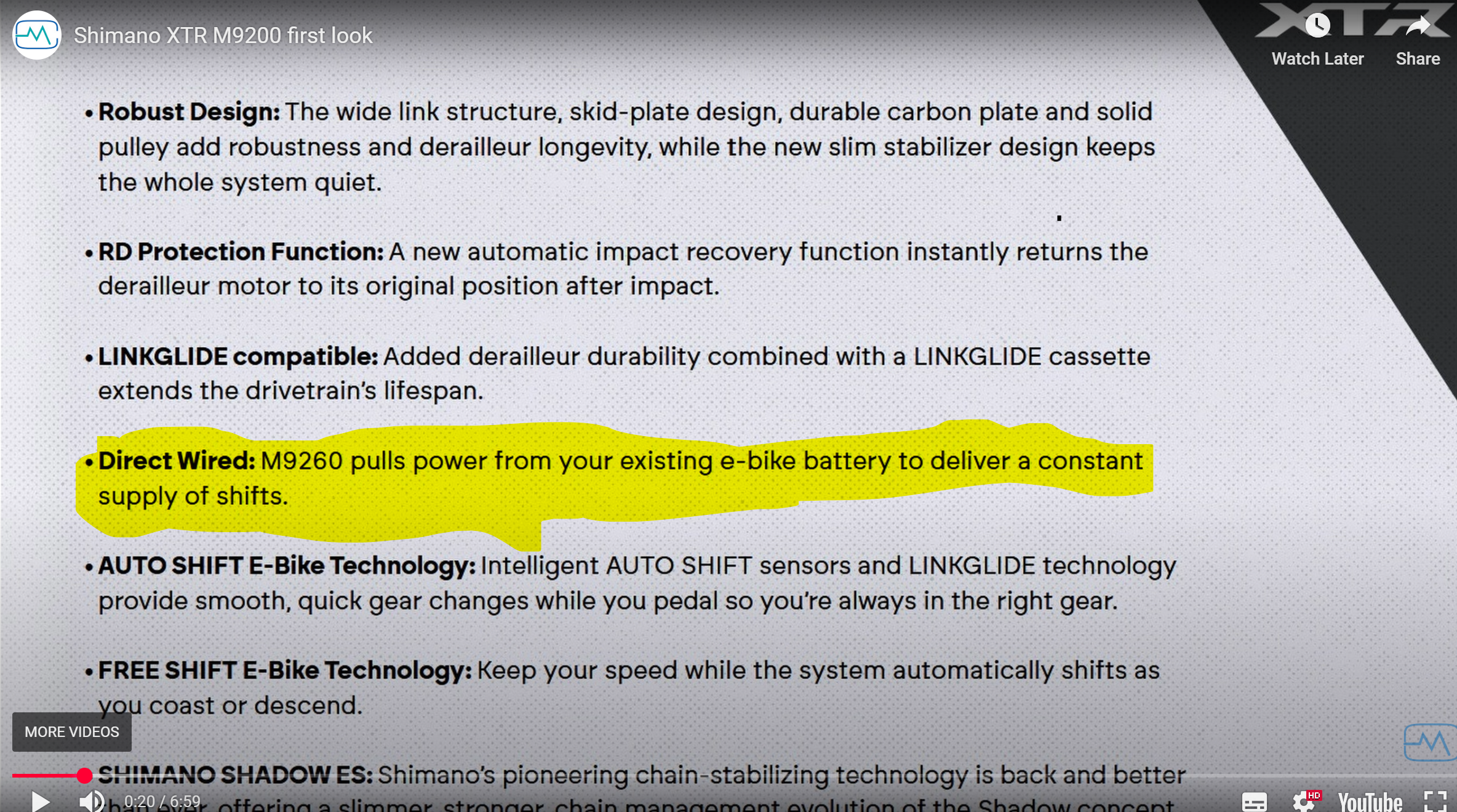

I read "Direct Wired" for the Linkglide version as meaning it is directly connected (wired) to the E-bike battery to power its wireless operation! NOT that it is still cable (wire) operated.;)
I read "Direct Wired" for the Linkglide version as meaning it is directly connected (wired) to the E-bike battery to power its wireless operation! NOT that it is still cable operated.;)
Yes, I agree that’s what it means. Didn’t it say somewhere they all use the same shifter? I though the only difference was cassettes and derailleurs.

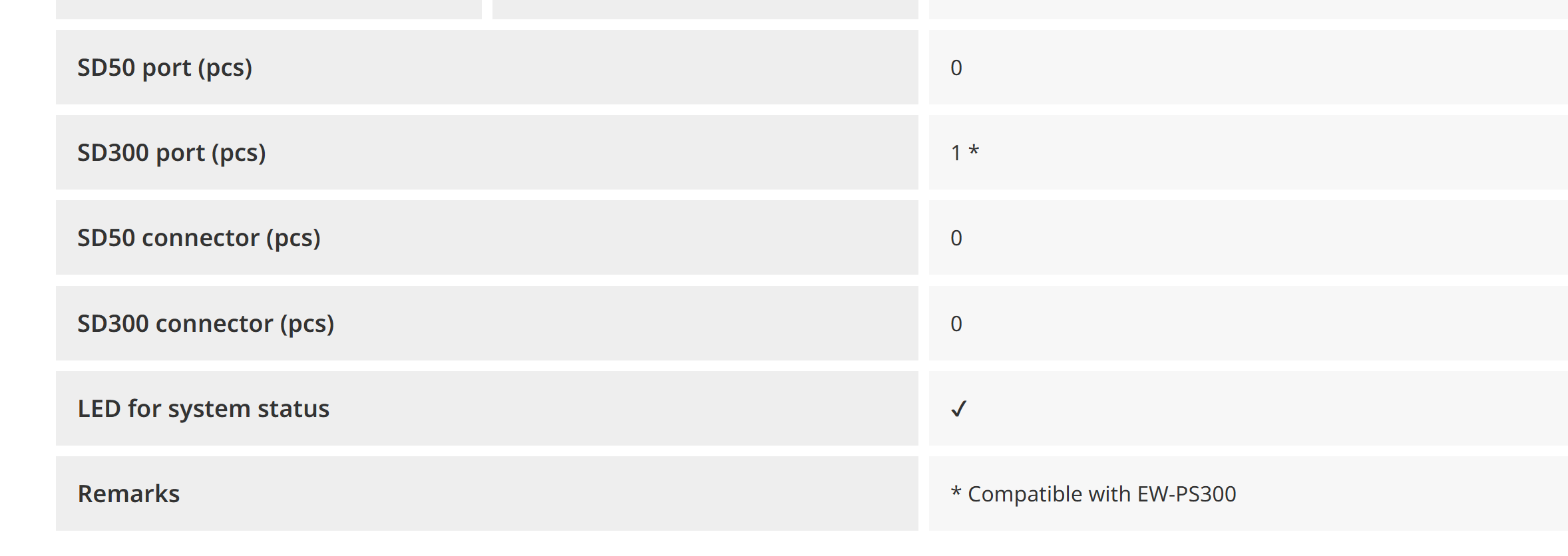

It runs a SD300 Port. So you can only plug it into a Shimano Motor, or a Bosch motor with a EW-PS300 cable. SD300 port is 7.4 volts. Most EMTB batteries are not 7.4 volts. So you need a 7.4V voltage converter in the motor.

Not every motor is going to run a 7.4V power supply. And it clearly says EW-PS300 compatible, which only plugs into a Bosch.
Having built two Di2 EMTBs. You can only assume compatibility with what Shimano state in their Technical Documents. And that states SD300 or EW-PS300.

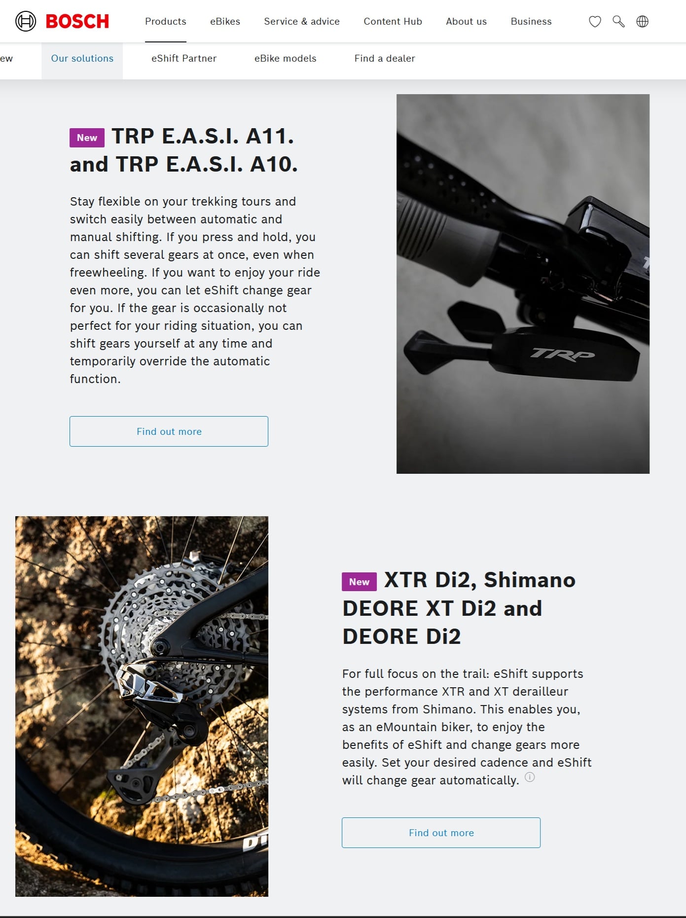

Not in stock yet but the XT Di2 is now listed and priced in the German Bike Discount online shop. My interest is in the 11 speed Linkglide version, powered from the E-bike, the bike already has a Linkglide casette so the cost would be as follows:-
DEORE RD-M6260 11-speed rear derailleur Euro 414.95​
DEORE Di2 SW-M6250-R Shifter right Euro 144.95​
Cable for BOSCH Smart System & DI2 rear derailleur Euro 79.90​
Total:- Euro 639.80
