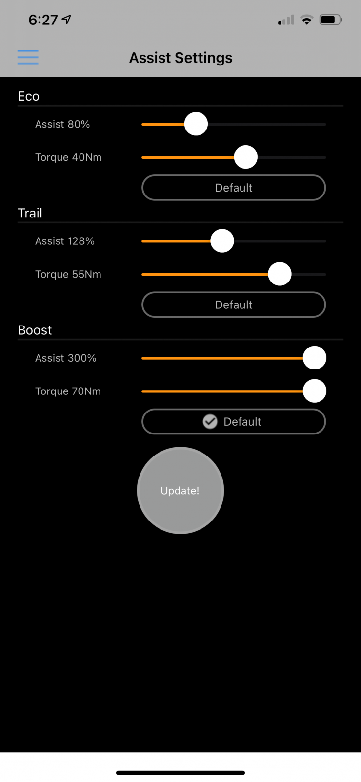

I use the ST Unlocker app and love it. My setup is pictured below and so far I have been able to peddle 25 mile rides and still have one or two bars left. This is in 90F temps, not sure what the cold will do yet as it's barely here. I ride primarily in eco/ trail so I upped the power in the eco just a bit and and turned down the trail assist from stock and uped the toque 5nm. I will use boost on the super steep stuff but try not to as it sometimes is a bit much and I find myself spinning out and then not able to get get going again. The stock settings are ECO: 75% 35NM TRAIL: 150% 50NM BOOST: 300% 70NM.
