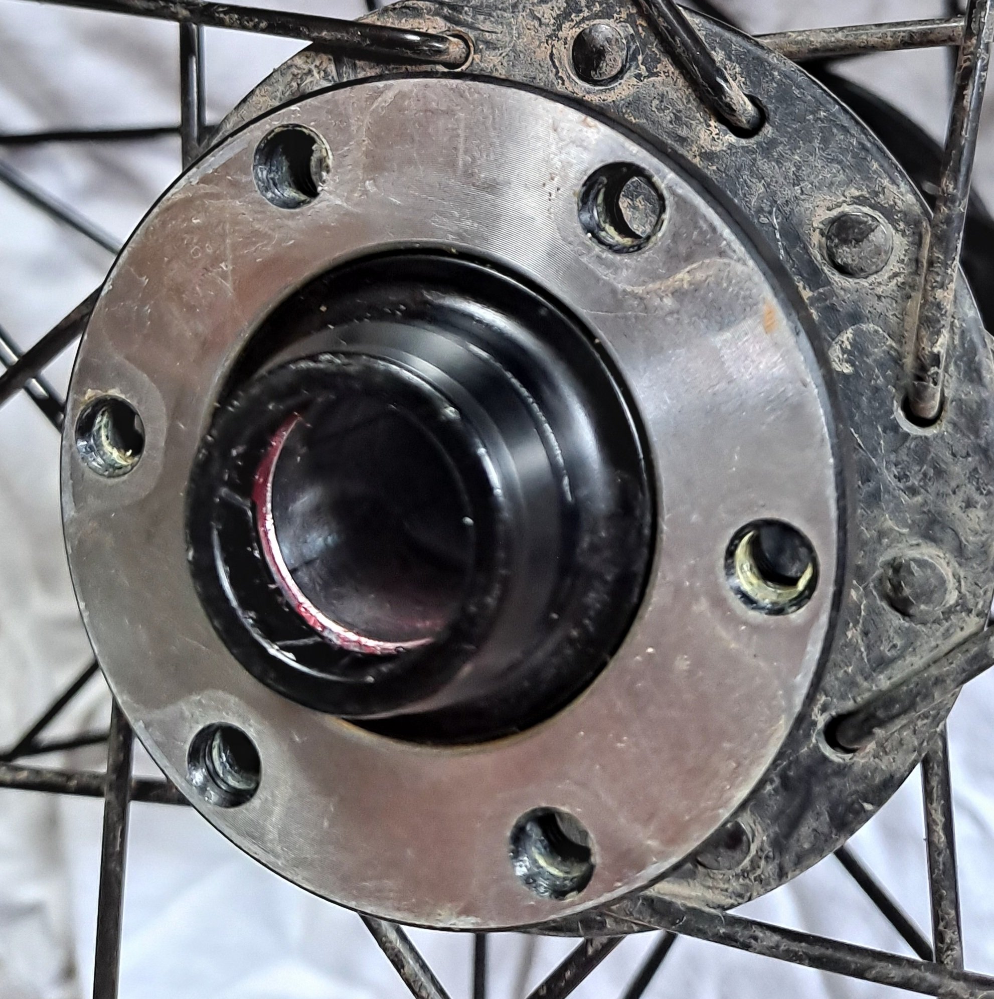

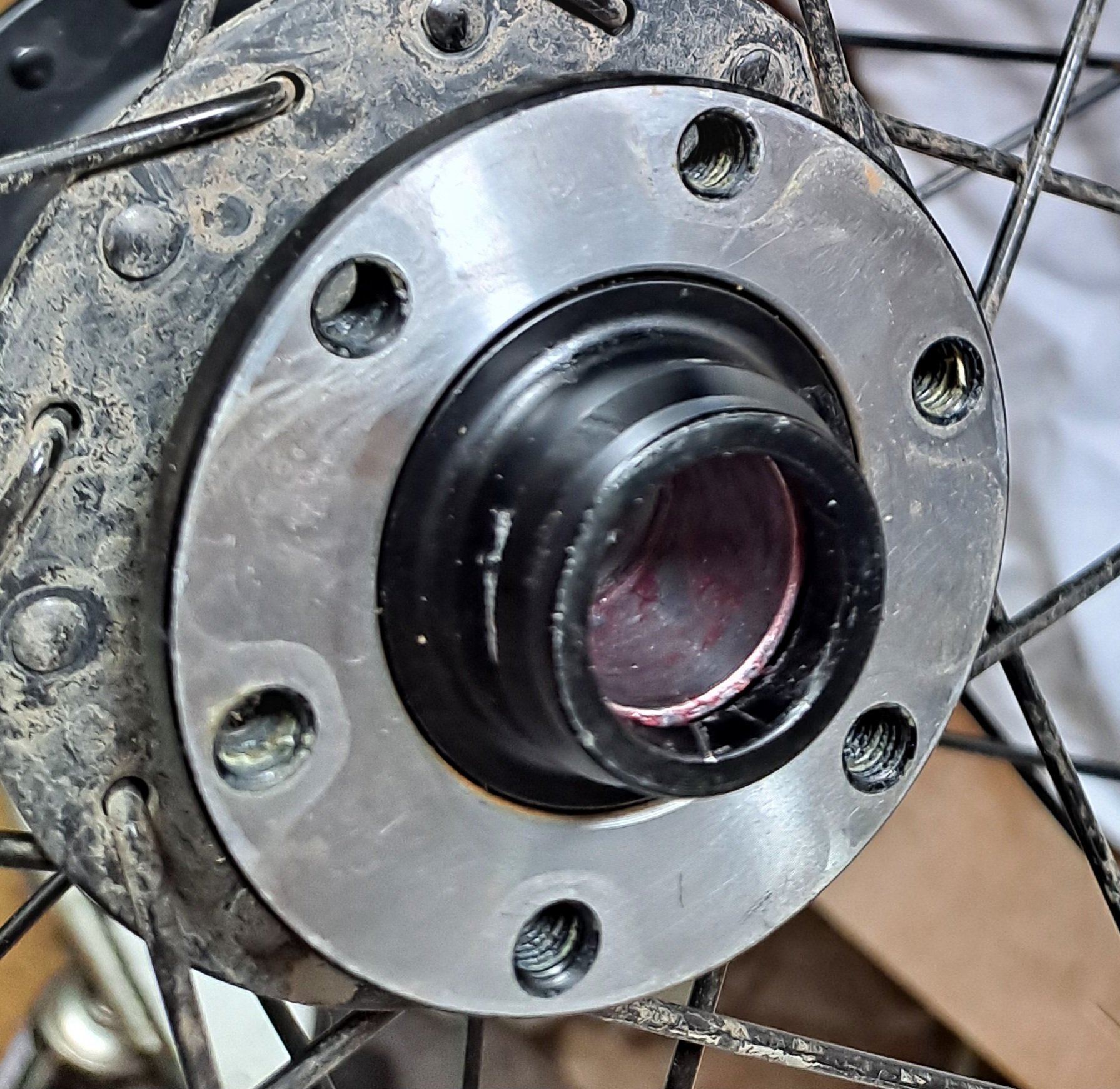

As above some photos may help to let folk on here give some ideas. I don't understand how the caps you refer to form part of the hub if they have no hole in them to allow a thru axle to pass through the hub!!
This is the front hub.
Photos left , as you can see the cap is flush with the axel and no visible way of removing them

Looks to me like the caps are retained by the outermost rolled sleeve. You can see a gap between that & the aluminium spacer in the axle. Next thing I'd try is a pick to pull the sleeve out & then I reckon the caps will slide off.
There's no aluminium spacer , that is the axel . It goes all the way through .
The caps are pressed on .
I've tried , pulling and turning both ways and they don't move.
Maybe but nevertheless, the flanged sleeve & axle caps are clearly separate parts & the solution lies in removing the layers to work your way in. Getting the outer sleeve off is the key, don't under estimate the amount of force required.
I believe @VWsurfbum is right....and you may be misunderstand the construction of a hub.....any hub. There is no axle in a hub!! Inside the hub casing there is a bearing towards each end. In your hub ( at least on the sides you photographed) there is a spacer between the end cap and the bearing...I assume the other side of the hub is the same. The thru axle then fits through the 2 bearings and spacers in order to mount the wheel to the bike drop outs.
The end cap is just the black plastic piece. Its sits up against the spacer where your photo shows a red colour...I assume that is in fact some sort of seal.
As I suggested previously and vwsurfbum has also suggested, it looks like you remove the end cap by inserting a rod similar diameter to the hole in the end cap and lever up and down. Given the end cap internally is only the black plastic up to the "red line"......probably 1cm in?.....you should only insert the rod that far. VWsurfbum suggested using the thru axle as that rod..........I would suggest finding something the same diameter if you can to avoid any risk of damaging the thru axle. The rod needs to be 12mm for the back wheel and 15mm for the front ( or risk using the thru axles).
Sorry but you couldn't be more wrong .
There is no plastic seal .
The axle cap is all one piece of aluminium.
The red ' seal ' is grease .
If you could see down inside there is one solid piece of aluminium tube ' axel sleeve'.
