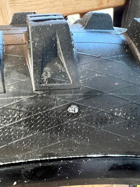

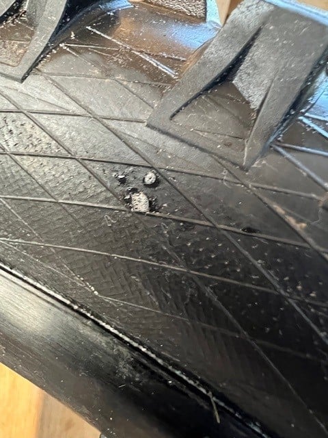

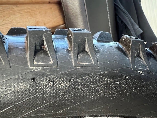

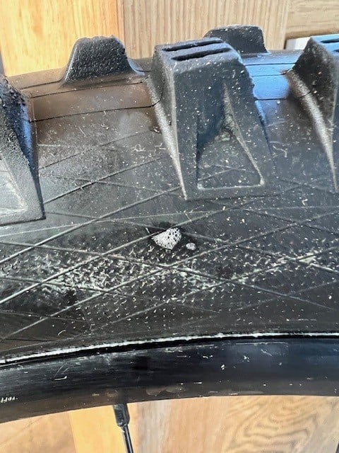

I've been running a Radial Magic Mary 27.5 Gravity Soft (rear) for five months and have ridden 464 miles. The tyre no longer holds air, and the tubeless sealant leaks through the side wall in over twenty-plus places. I've had to swap the tyre.
I've contacted Schwalbe UK; hopefully, they can advise.
