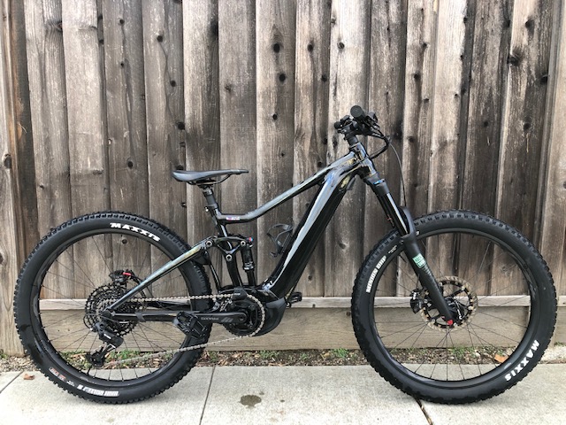

Luddites are gonna say don't do the mullet (void warranty, mess up design intent, blah, blah) but I say you do what works for you. i have altered this bike's front so much to my liking that it ended up being my favorite bike (sold my fancy carbon). FYI, it's got a 1.5 degree angleset, 160mm Yari (and soon to be 170mm Lyrik internals because I can) 29er fork but still rocking 27.5 wheels.
Looks a nice bike that!

I'm on the Decathlon Stilus. It has strange geometry anyway so I believe the mullet setup really suits it. I may take the plunge at some point. But probably should start saving for other things, baby stuff lol.
