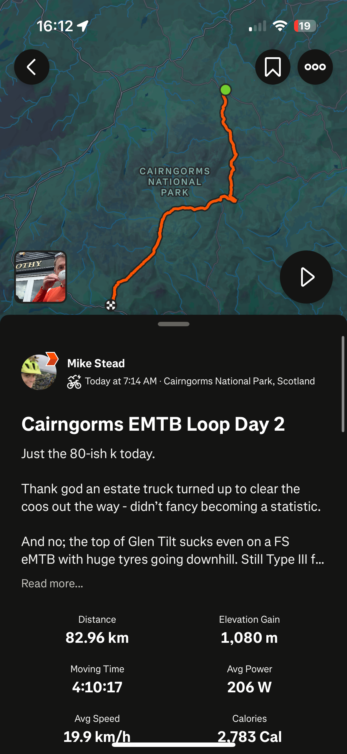

Cairngorms inner loop ride report: Bosch CX motor, rode using eMTB mode the whole way, two 625w batteries, two days, overnight at Smugglers hostel in Tomintoul to charge.
Day 1: 115km / 1500m all of first bty and 31% left of second. 5:30 ride time, 7:30 elapsed with eating and faff.
Day 2: 83km / 1080m all of first bty and 37% left of second. 4hrs ride time, 6 elapsed with eating and faff.
