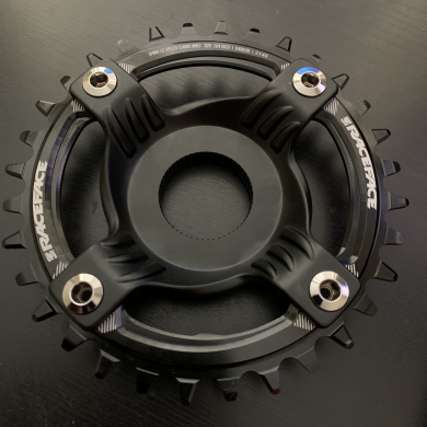

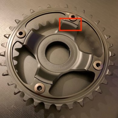

It will bolt up (104bcd), it just looks weird as the shimano spider's inner wings only look flush when using a shimano chainring. The RaceFace 104BCD 32T chainring for Shimano 12speed has a different profile on the tabs so looks like there's a gap.
Here's what the RaceFace 32T Shimano 12s chainring looks like on the FSA Shimano EP8 spider. Lighter too - 136 grams vs 176 grams).
Shimano spider with 34T Chainring for Shimano 12-speed (SM-CRE80-12-B)
