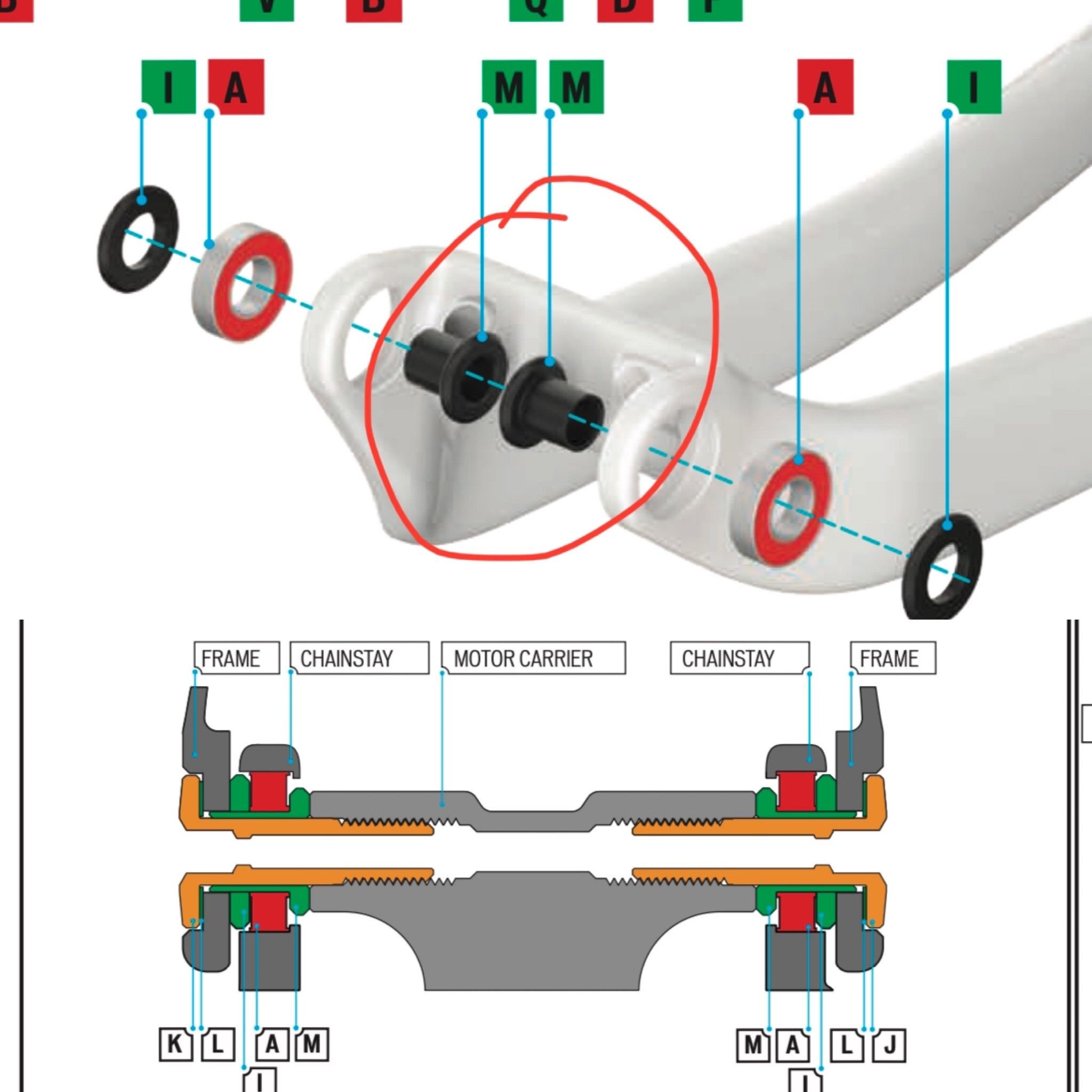

Taking my rear suspension apart to clean and repack bearings. Any tricks for the main pivot on the chain stay? I can't find anything on the Gen 3 in my searches. Got the bolts out, and it just does not seem to want to come out. Don't want to force anything. Tricks anyone?
You have to remove the spacer „M“ first to get the chainstay free.
Thank you very much for this pole1602. So the motor does have to move. Thats kinda what I figured.

Yes, the motor have to move. I found this in the Levo Megathread
