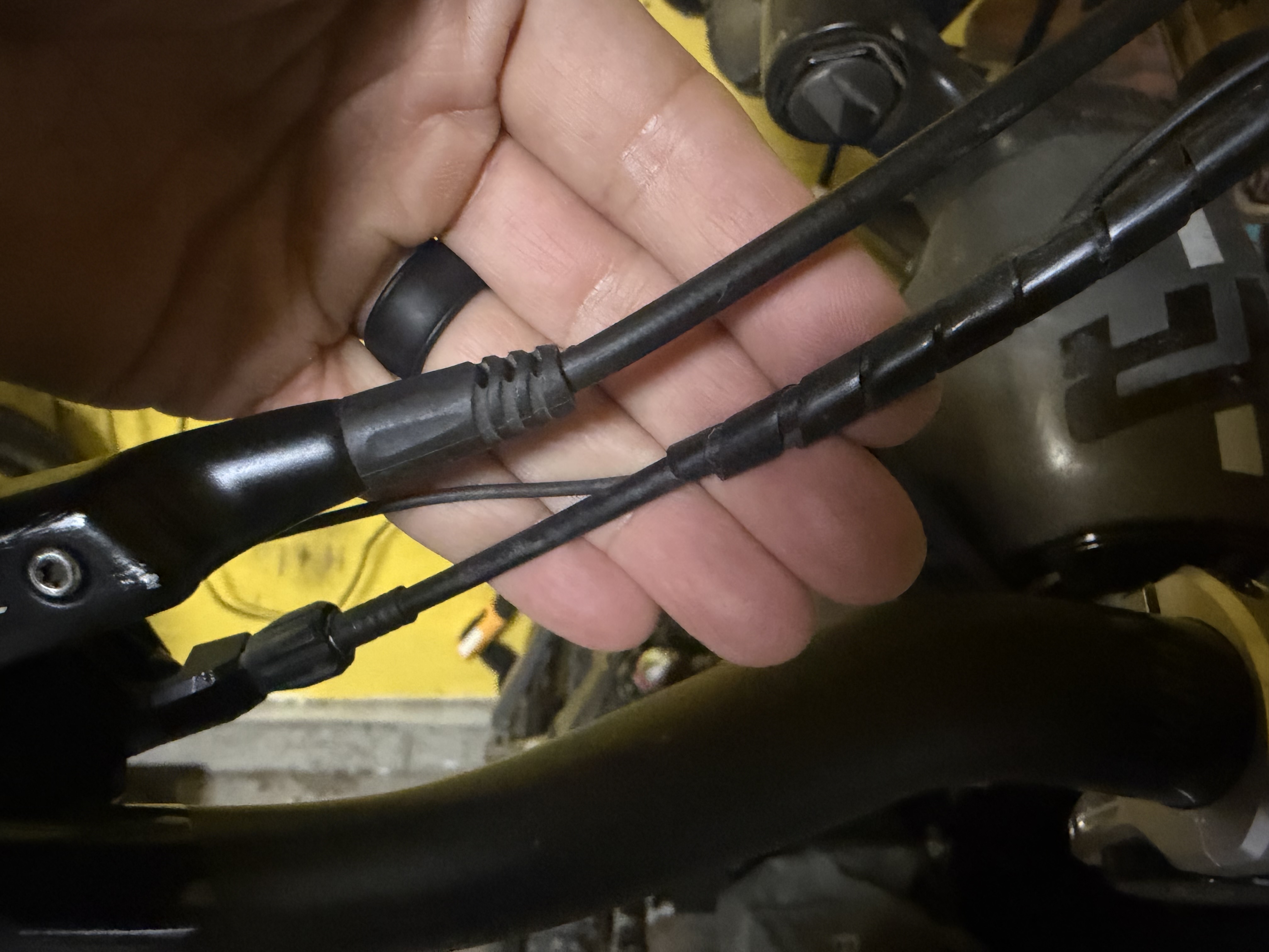

For those of you who have a Reverb AXS dropper, what did you do with the FAZUA controller cable routing after getting rid of the steel dropper cable?

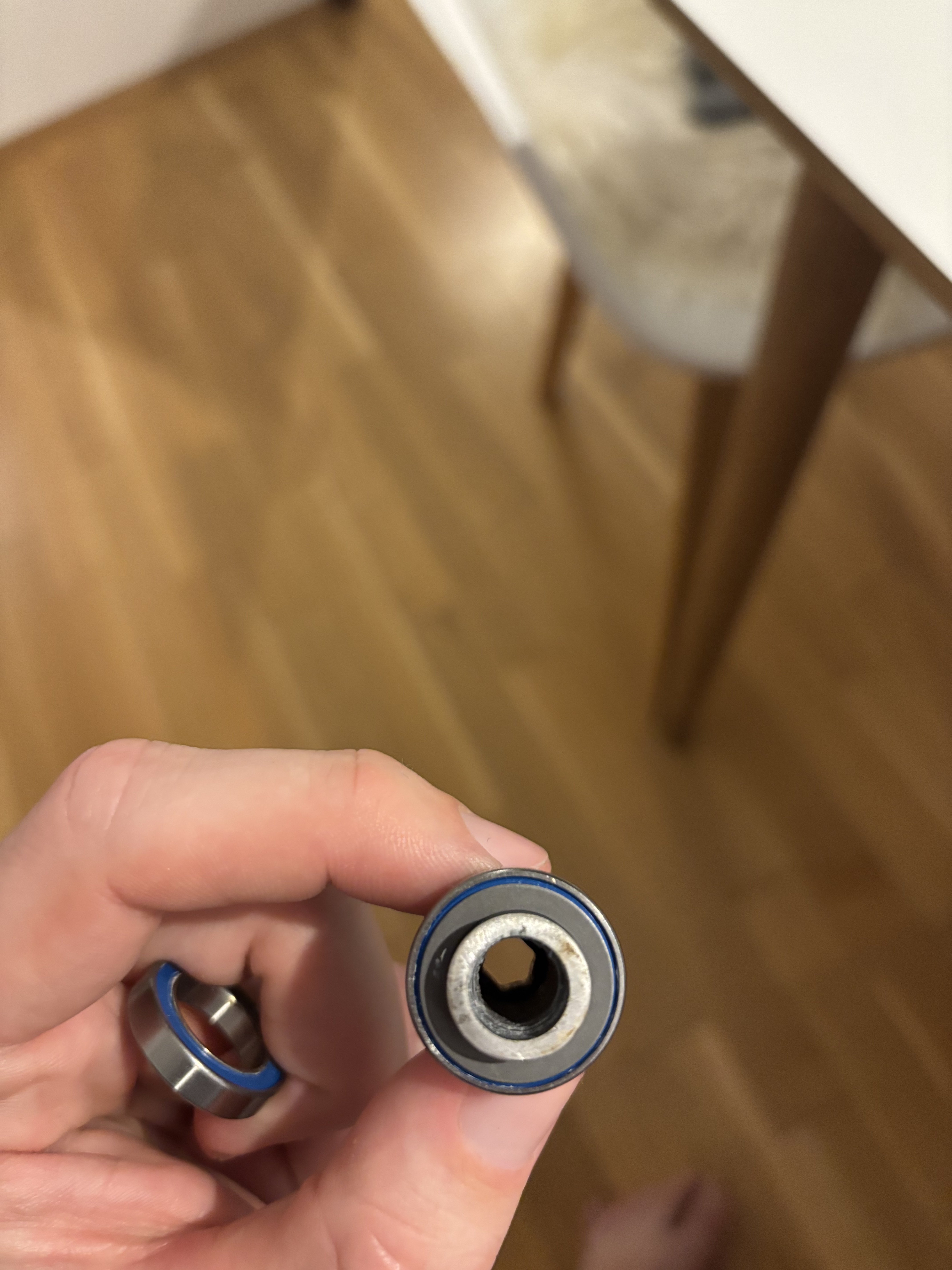

I have about 7300km on my relay.
The chainstay bearings drive side just developed play the 3rd time now.
(Other bearings have been play free, but I‘m about to swap them also)
Anyone experienced the same?

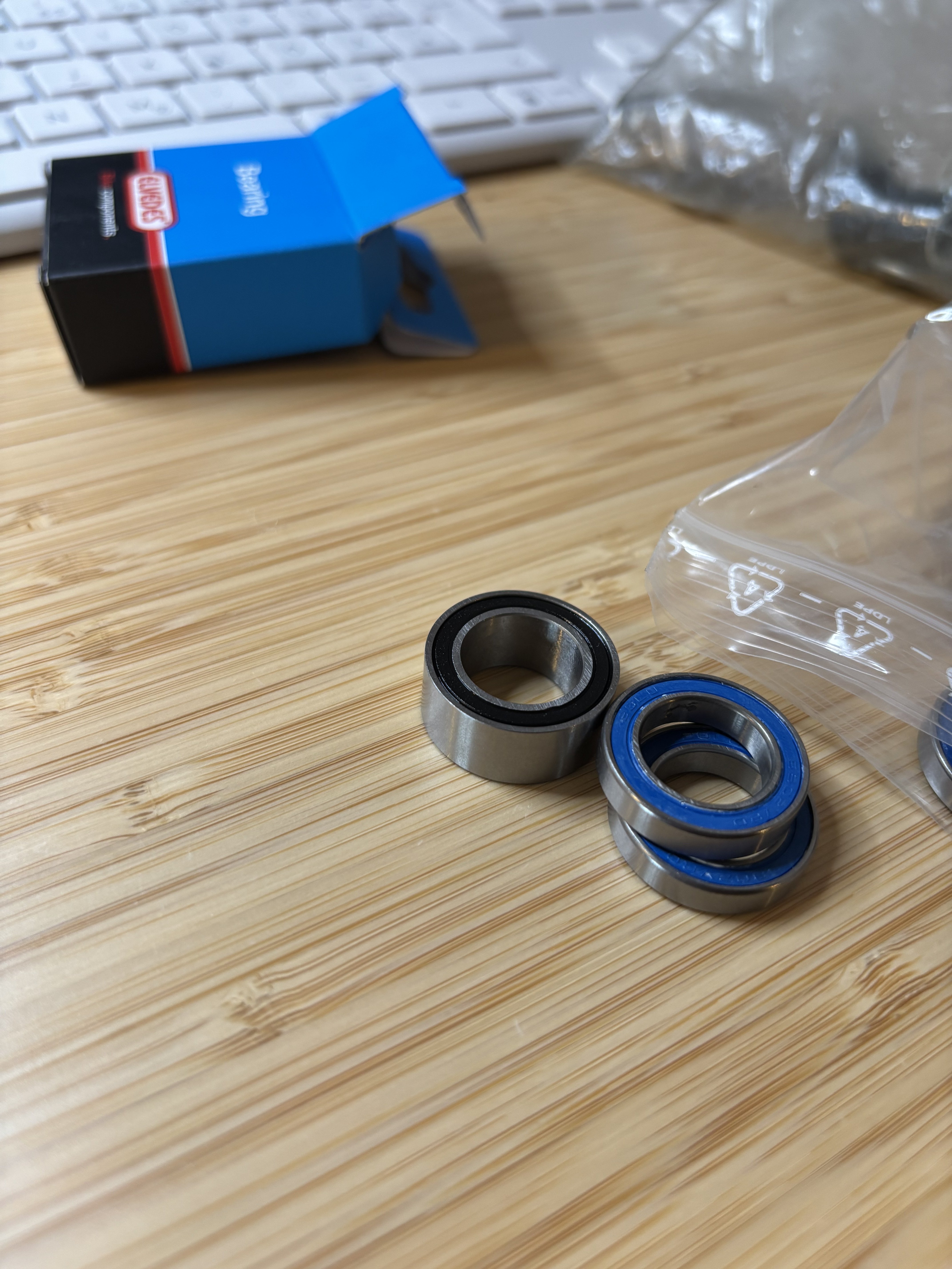

The chainstay is using 2 x 6802 bearings back to back.
I made some research for longer lasting bearings for the chainstay and came along this double row bearing which is twice the width of the 6802 bearing (10mm instead of 5mm): Elvedes 3802
Seams like only Elvedes from Netherlands is doing this cage free max double row bearing in 10mm width.
I‘ll let you know how long it holds up.
The 2x 6802 lastet always around 2000-2400km.
@Tmae - how have you been getting on with those new bearings? And how did the worn out chain stay bearings manifest - did you get side to side play?
Thanks
Good timing to ask.
Just returned from some days riding in finale ligure. And Unfortunately the Elvedes bearing already developed play after ~500km of riding 😑
So looks like 2 single bearings hold up better then 1 double row.
The pairs of bearings before all developed play also.
Next I will try to put a 0.3 thin spacer (15x21mm) inbetween the 2 bearings to ensure that only the inner rings are touching each Other.
With the current back to back setup it might be the case that the outer rings touch First which will result in axial load applied to the bearings when the pivot is tightened (which will degenerate roller bearings quickly).
If this also doesn‘t help i need to change the bearings frequently after about 2k km or ask transition if there is something wrong with my chainstay.

Yes, side to side play on the drive side chain stay bearings (next to the derailleur)only. Manifesting in a kind of knocking sound while descending, you can also feel it when wiggling hardly on the rear wheel while holding the pivot joint with your thumb and index finger.

Unfortunately not, i always used max bearings (without cage) for high load low rotations intended for mtb suspension.
Spacers arrived, looks good so far.
I will fit them with new bearings in the next days.
Update:

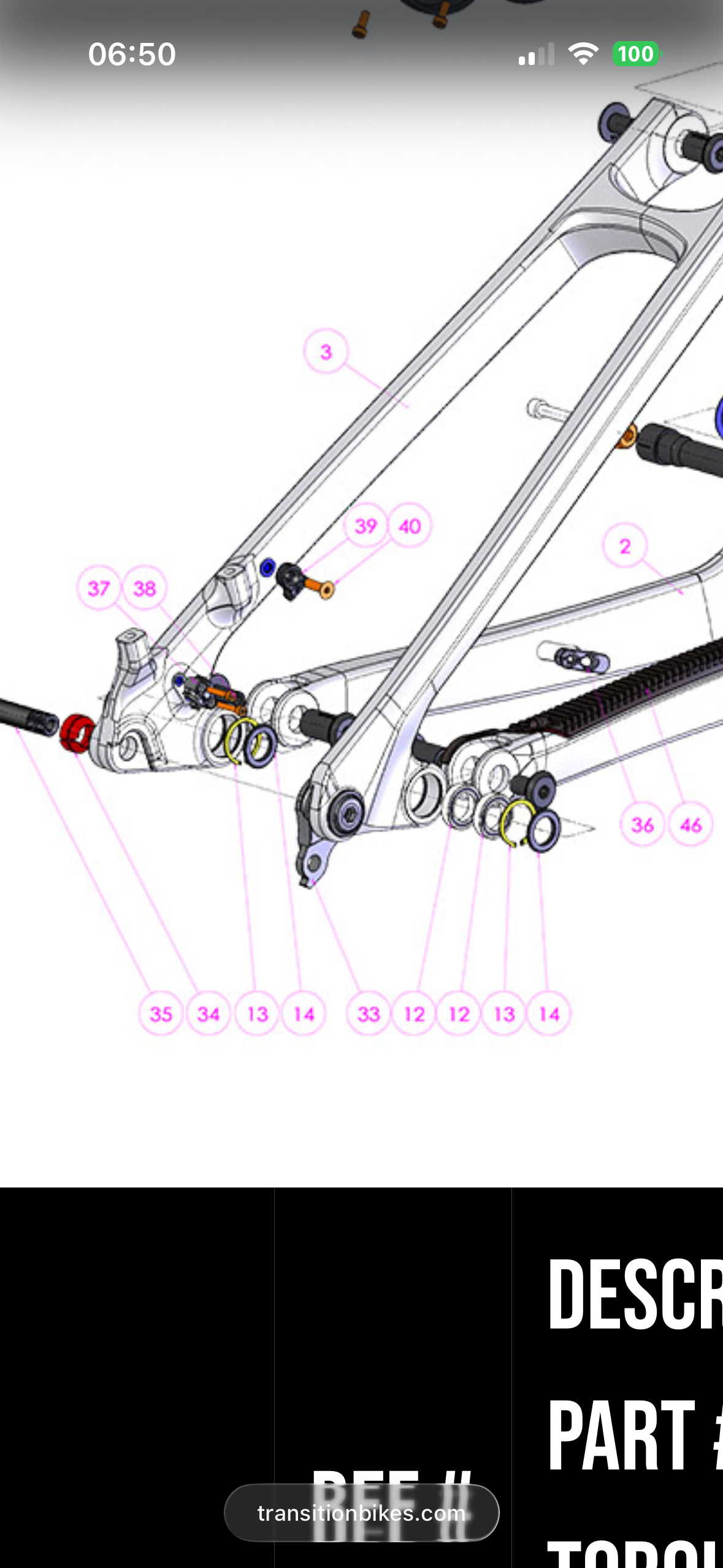

I just disassembeled the chainstay pivot and inspected everything.
I finally found the root cause for the play.
It‘s not the bearings developing play, it‘s the bearing seat of the frame which is too loose :(
i can press through the bearing just with my fingers.
Also the drive side pivot hardware is showing wear (non drive side no wear).
So means I likely will need a new seat stay, i already reached out to transition.
—> the double row Elvedes bearing is still ok.
transition agreed to send a new seat stay.
Maybe it would be better to use retaining compound loctite 641 (mid strength) or 603 (high strength, specialized is using it) instead of grease when replacing the besrings to avoid movement in the seats which will cause a loose seat finally.

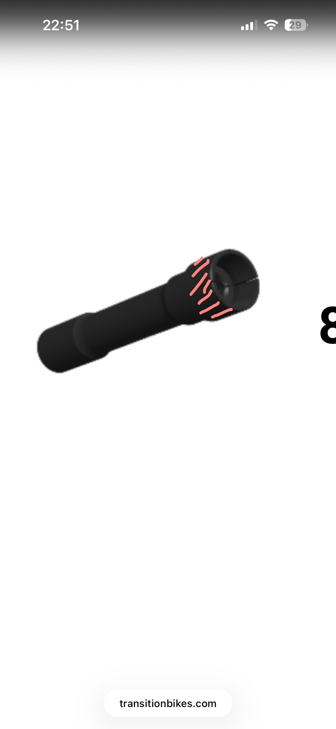

Hey guys, i need your help :)

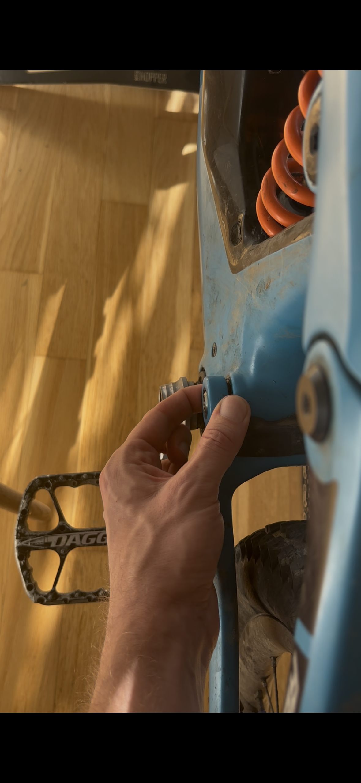

I have some play on the non drive side (left side) on my main pivot.
It‘s not the bearing, since i replaced them and the bearing seat is tight and snug.

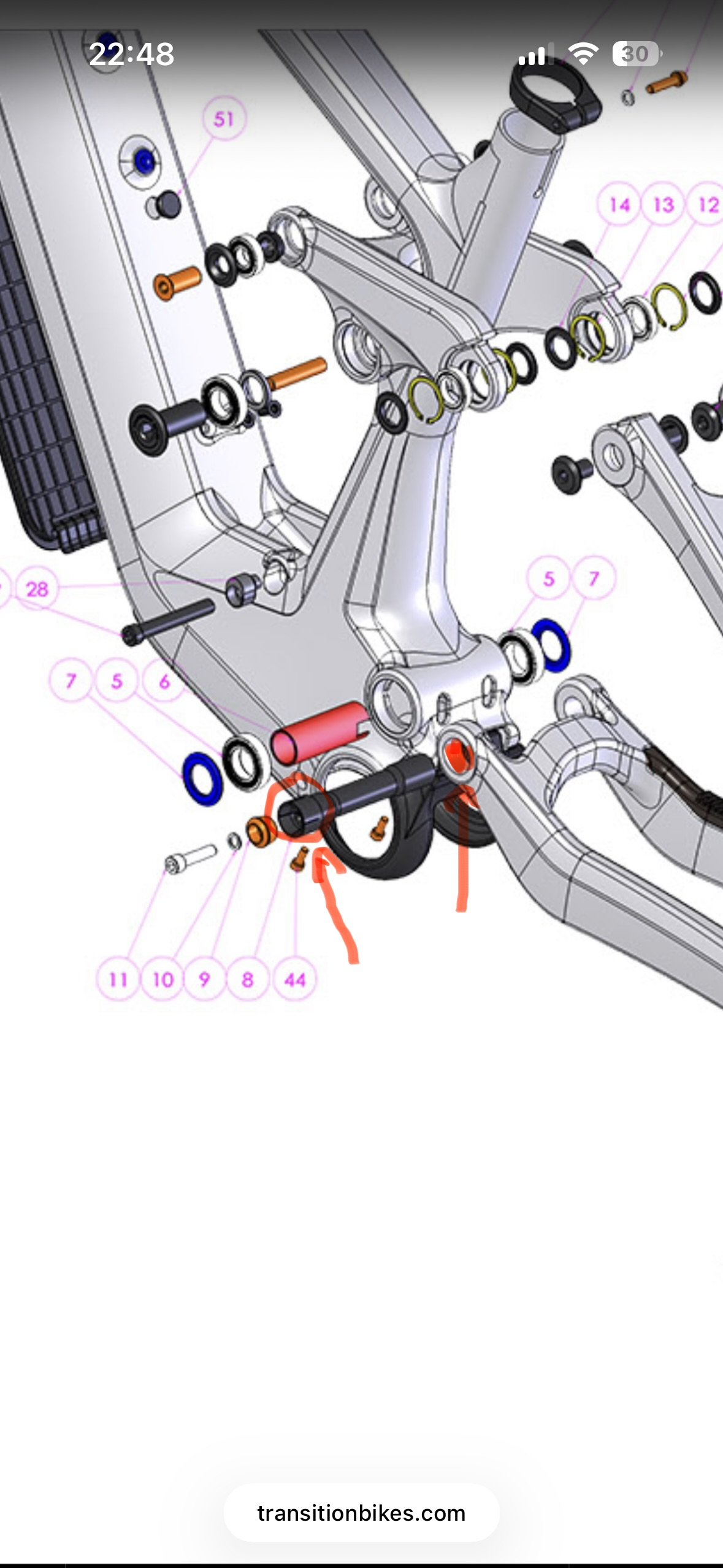

I think it‘s the chainstay bore „floating“ on the main pivot axle head:
Is it normal that these 2 have some relative movement when axial force is applied to the real wheel?
I‘m quite sure i didn‘t had any movement there before 🤔, maybe it‘s because i put also grease on the main pivot axle head?
Should it be grease free to have a better friction to the chainstay bore when the main pivot taper nut is torqued?
the play is easily detectable by shaking the rear wheel left and right with one hand while holding the pivot joint by my thumb and index finger.
Maybe you guys can check if you can also feel any play there.
Thanks!
That came loose on mine once and I could feel it. I just tightened it back up and went right back to riding and forgot all about it honestly.
I couldn‘t wait the curing time and just checked with medium strength loctite at that head pivot axle area —> play is gone. So looks like my axle/ chain stay is also worn 😩
Are your relays play free at this area without loctite?
My pivot axle initially kept coming loose. Wrong install from the factory. Tightening the black axle up again and adding loctite seems to have sorted it out.
I hope your troubles go away @Tmae
@jever98
Thanks mate :)

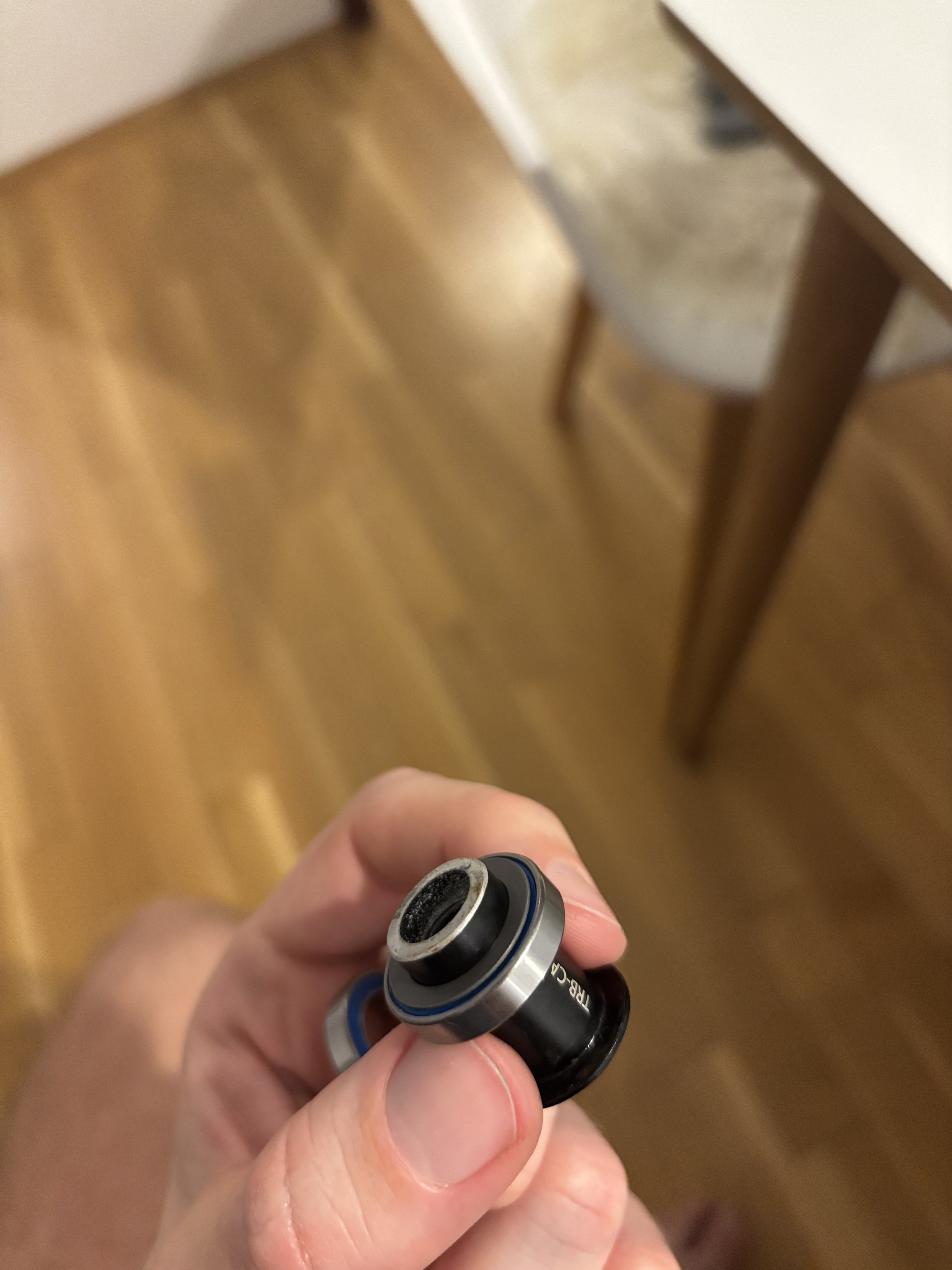

My issue is the press fit of the opposite side of the axle thread which is fixing the axle to the chainstay by spreading the slotted axle head by screwing in the nut.
Axle or chainstay is worn at that contact area.
I already ordered a new axle to check that first, if still play persists I need also a new chainstay besides the seatstay which developed bearing play at the seat.
