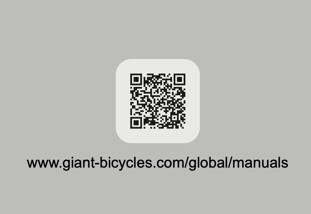

I find it incredulous that spending 7k on a trance doesn't get you a 2022 manual on the updated ridecontrol ergo 3. But I did get a great manual that shows how cantilever rim brakes should be set up. Really useful. I understand the middle blue light is the smart assist but once you start pushing buttons only God knows what setting your ultimately gonna end up with. If anyone comes across a new manual please pass along. But on a positive note.... The bike is an absolute riot, up and down.
