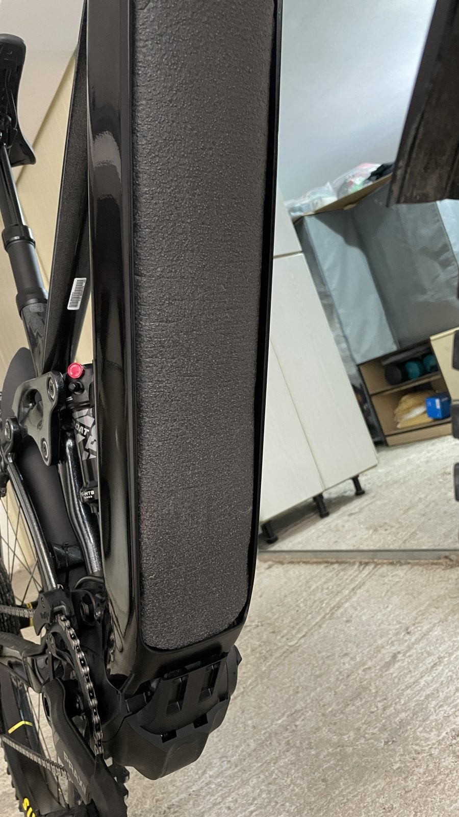

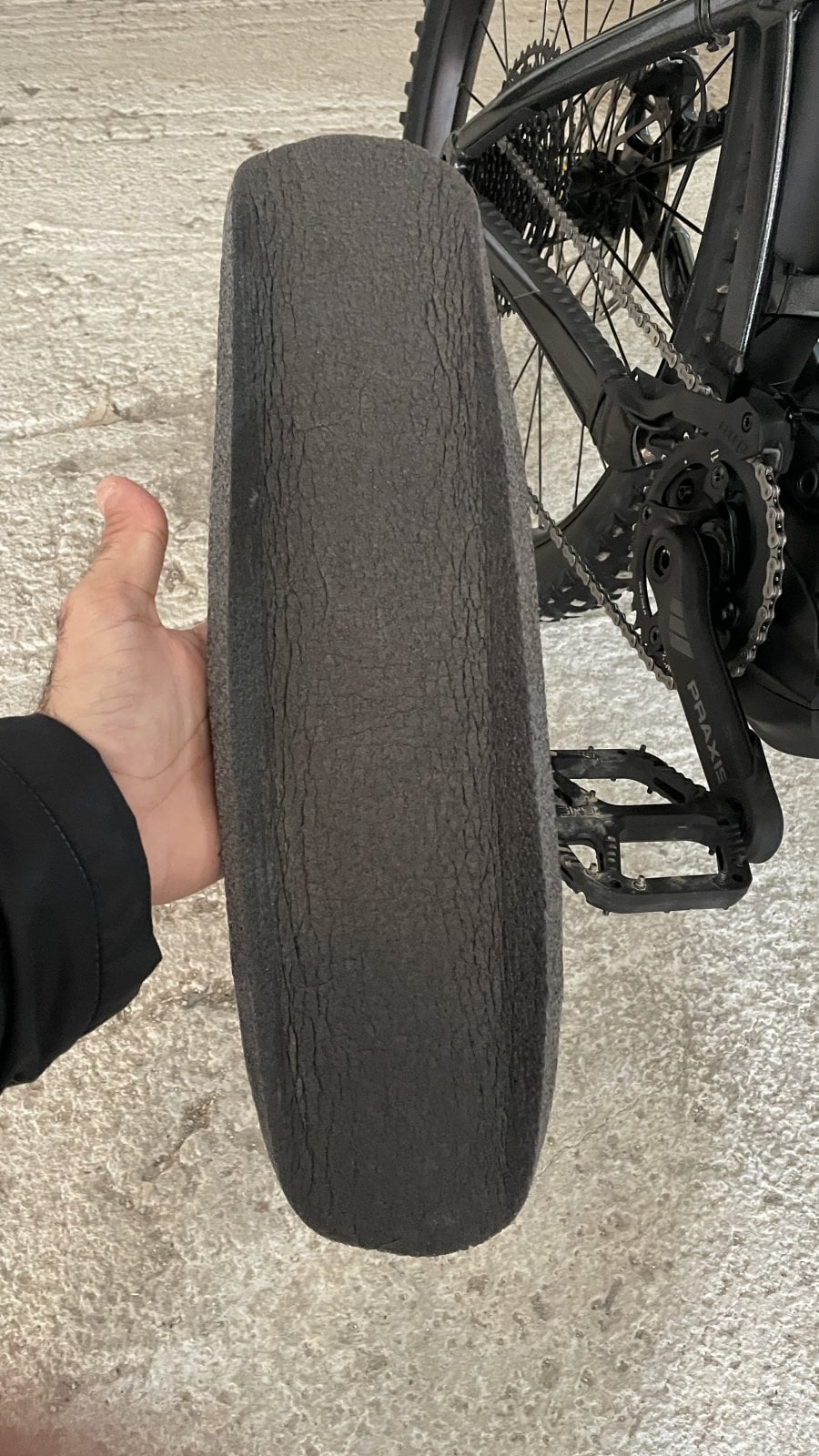

Anyone tested to hide a Airtag in the battery cover? is it enough space?
You mean something like that?cheap and easy, also it stop all the annoying sounds from the plastic cover and add some protection from low temperatures and water .

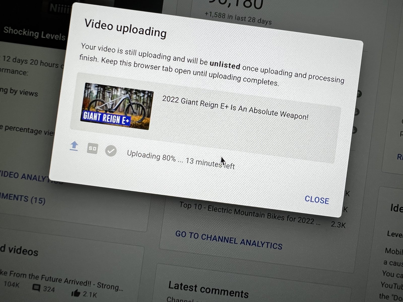

Robs video supposed to be landing today (according to his response to a question on YouTube). Fingers crossed.

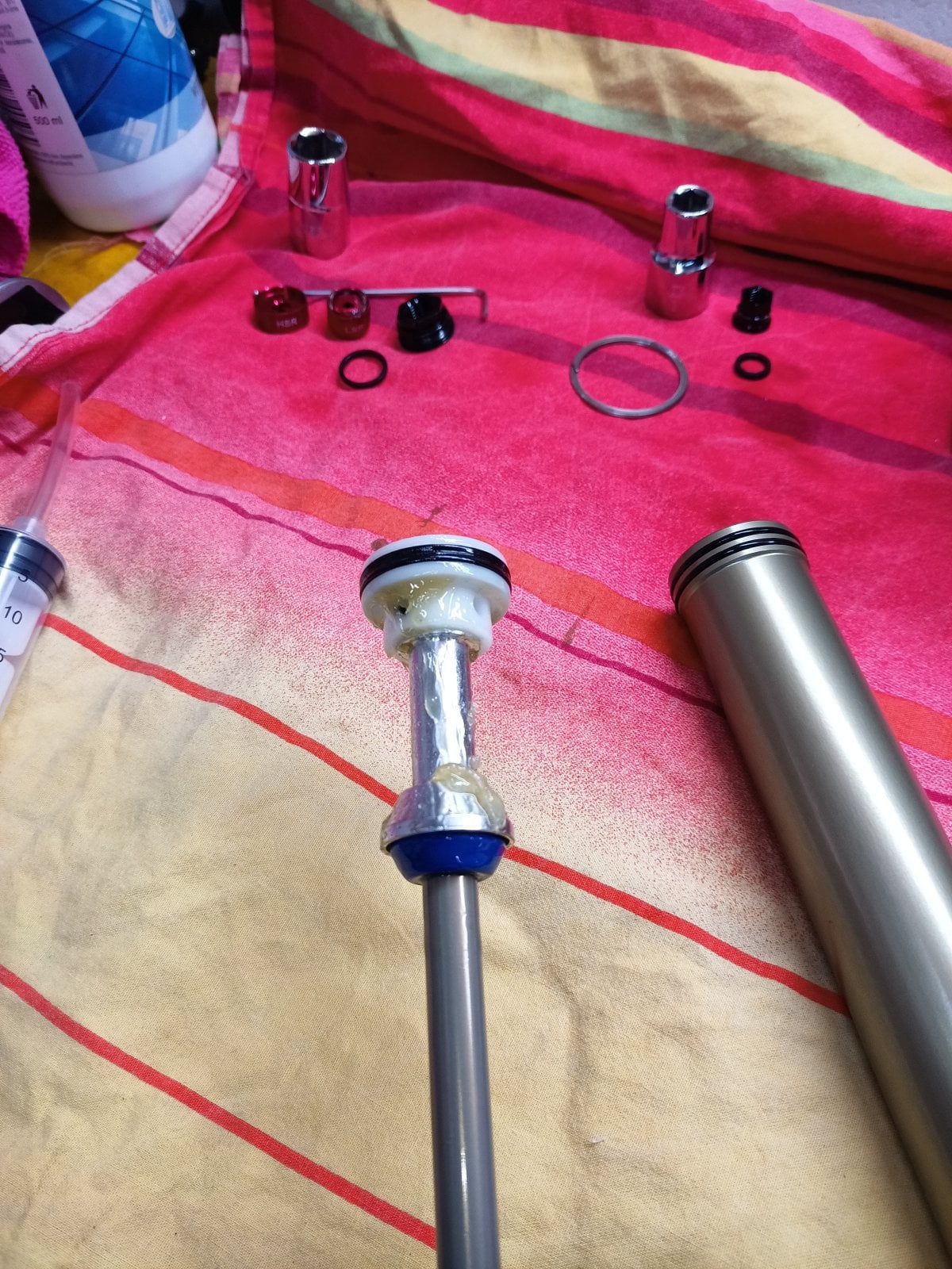

I’d this your Fox 38? I’ve taken mine back to the shop to sort. Feels super harsh and have told them I think I have too much grease in the negative side. Hopefully Fox will sort it as a warranty issue.
That sounds oddly specific. How did you come up with this diagnosis? What was wrong exactly? Usually nobody links harsh fork with too much slick honey in the negative air chamber but rather with 1. Bad damper settings, 2. Temperature.
What were your symptoms exactly?
If you google Fox forks harsh there are plenty of cases. There is a thread here on emtbforums that covers this extensively. Plenty more on MBR, pinkbike and Vital.
Apparently it reduces the negative chamber and can also block the port between the two chambers.
I tried to set up a ShockWiz on my fork but when I released all the air to calibrate it I couldn’t pull the forks up to full travel, even after putting a zip tie down the seals to break the pressure.
What does @zorro77 think?
I felt the fork too hard even in small bumps, I played with the pressures but it did not improve, moreover to have sag 20% I had to put too much air for my weight, probably the air remained in the negative chamber .... as soon as I can I try it and update it
This might be the symptom of negative air chamber being "stuck". Happened to my X2 in the past
Do you guys follow instructions of how to pump your forks? Or do you just pump them once to the "correct" pressure? There is a specific procedure how to inflate stuff with big negative chambers. You need to do it in steps. Pump a bit and then press the fork slowly. Repeat couple of times.
Exactly how I felt. If I set it up with 20/25% sag it still felt harsh. I have removed tokens, changed air pressure. Up: down. It’s never got to a place where I’m happy. I’ve been riding for 20+ years and I’m fairly confident on how a fork should feel. I’m sure it’s not every fork but it’s enough that there are plenty of discussion on the web about it.
Yup. Every time. Every 15 psi to equalise the negative chamber. Every time I change air pressure.
If you are able to equalize the pressure in every step and the pressure in the main chamber drops a bit each time, that means that the passage between the negative and positive works correctly.
I’m not saying it’s equalising each time. Exactly the opposite. I’m saying it’s not equalising. Try letting all the air out of your forks and then pull up. You should be able to pull it up to full height. I can’t. Not even 20mm before it sucks it down.
I’m glad for you that you have a fork that is perfect. Im just telling my story about how mine isn’t and how that seems to be a fairly common problem.
If you read this forum it explains a lot.
You've got it wrong. I'm trying to diagnose your problem in order to help.
If your fork sinks after totally deflating it, it's not necessary that bad. Fox has a good support and should help here. As far as I remember they told me to just try to inflate my X2 when it was stuck. High pressure just pushed slick honey from the passage between the chambers and the damper was fixed. Write them and confirm that you can do it with the fork too. Opening Fox fork and air leg is relatively easy but I think it might not be necessary in your case.
If possible link here the other forums that discussed the problems you mention.
I read it all :). So basically they say exactly what we are saying here. Just in more detail. The only thing I would add is that the reduction of the volume caused by excess amount of slick honey is not a cause of harshness in my opinion. Stuck air transfer between positive and negative air chambers might though. But as @Rob Rides EMTB mentions there, for him what helped was properly inflate the fork in steps. If you are not able to equalize the pressure and you don't want to tinker with your fork then of course just give it to your shop or Fox and they will fix it. I would talk to Fox service first.
38 is an amazing fork in my opinion. Not plush like RS but it absolutely shines when ridden fast. So don't give up on your fork just yet :).
