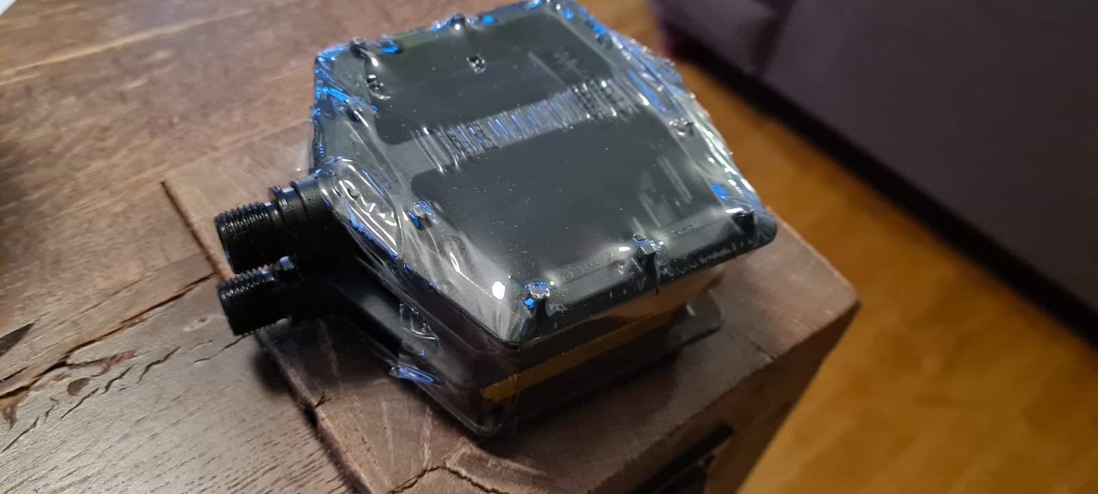

Can anyone tell me if the bikes come with pedals of any sort? Any pics?
Plastic Flat. E+0
The fails of giant are that the bike come with plastic pedals., 125mm dropper post , 50-55mm stem and rear awfull hub .
usually you never get ANY pedals. 125mm dropped is a fail for sure. But the specs say 150mm on E+1 medium size. Same for the stem. The E1 specs say 35mm.

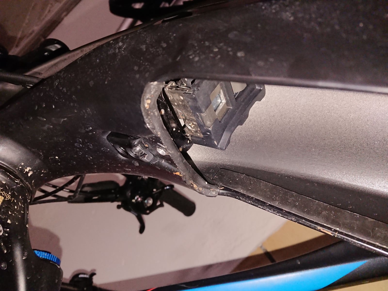

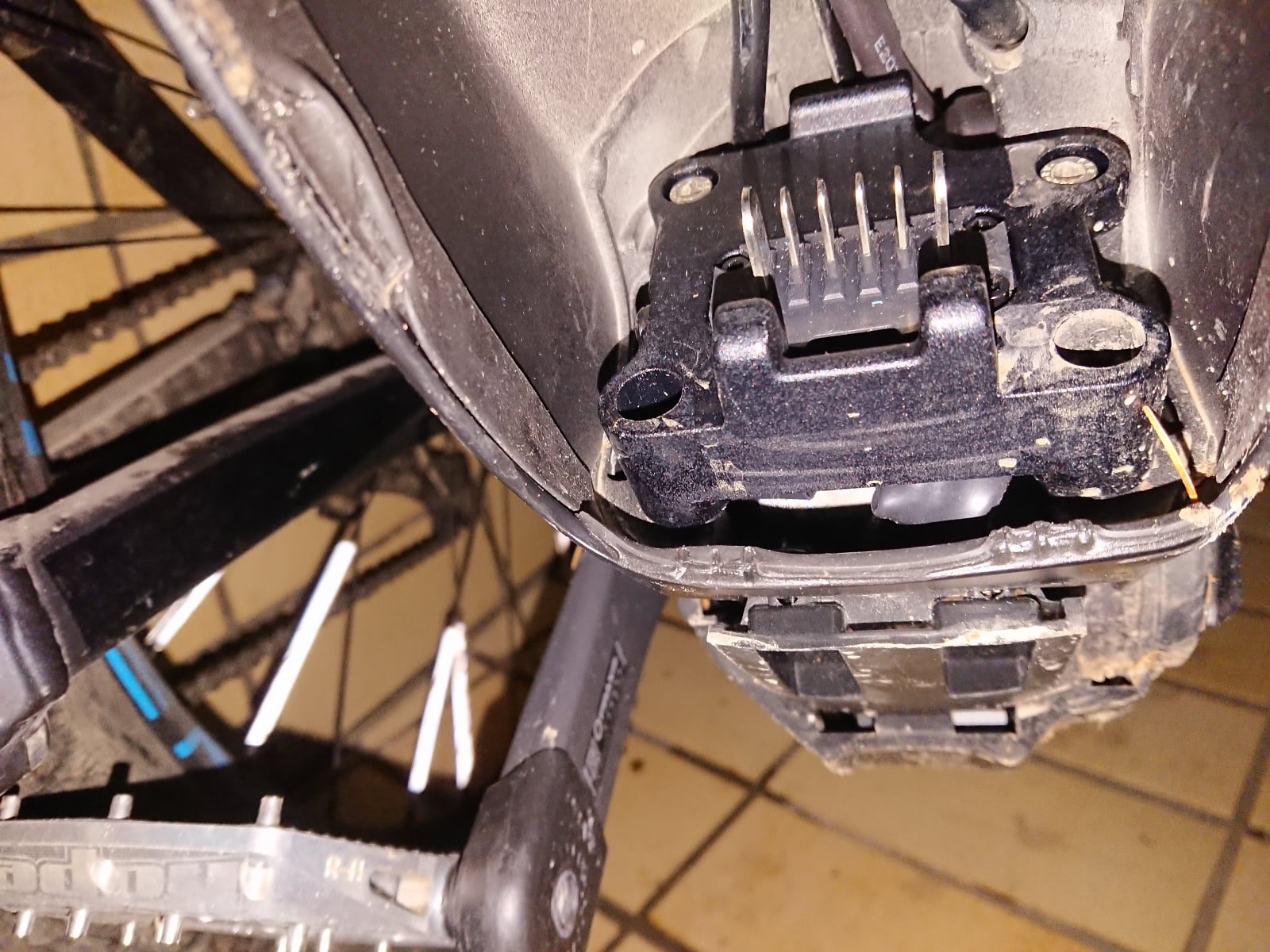

I was doing just that right now for you guys:p.

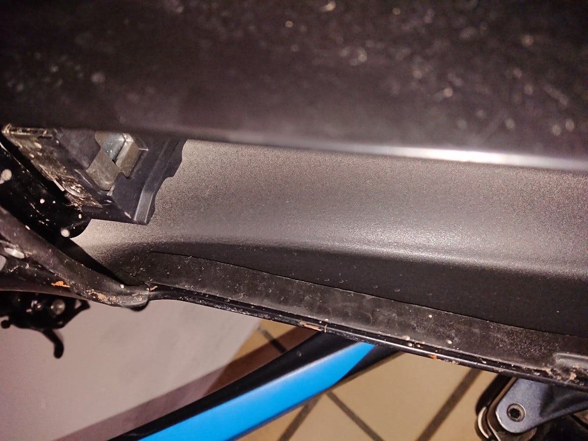

Here where the battery cover hooks go, I pushed the rubber tape with a tire spoon. You need to do it because the battery cover hooks will not push the tape for you like that.
This is all just first iteration. I am pretty sure that if you guys will start to play with the subject someone will come up with a better solution. But right now for me it works.
I used a wide M3 tape (@seofrancisco you were right this is M3 mastic tape 2228) that I cut in 3 stripes. When gluing the main 2 long stripes to the downtube I left 1,5mm to the edge. I think this is not necessary. 0,5mm is enough or even 0mm because the downtube is bent where the edge is. I don't know how to explain it better. But basically you can try to stick the 2 long stripes without any gap from the edge.

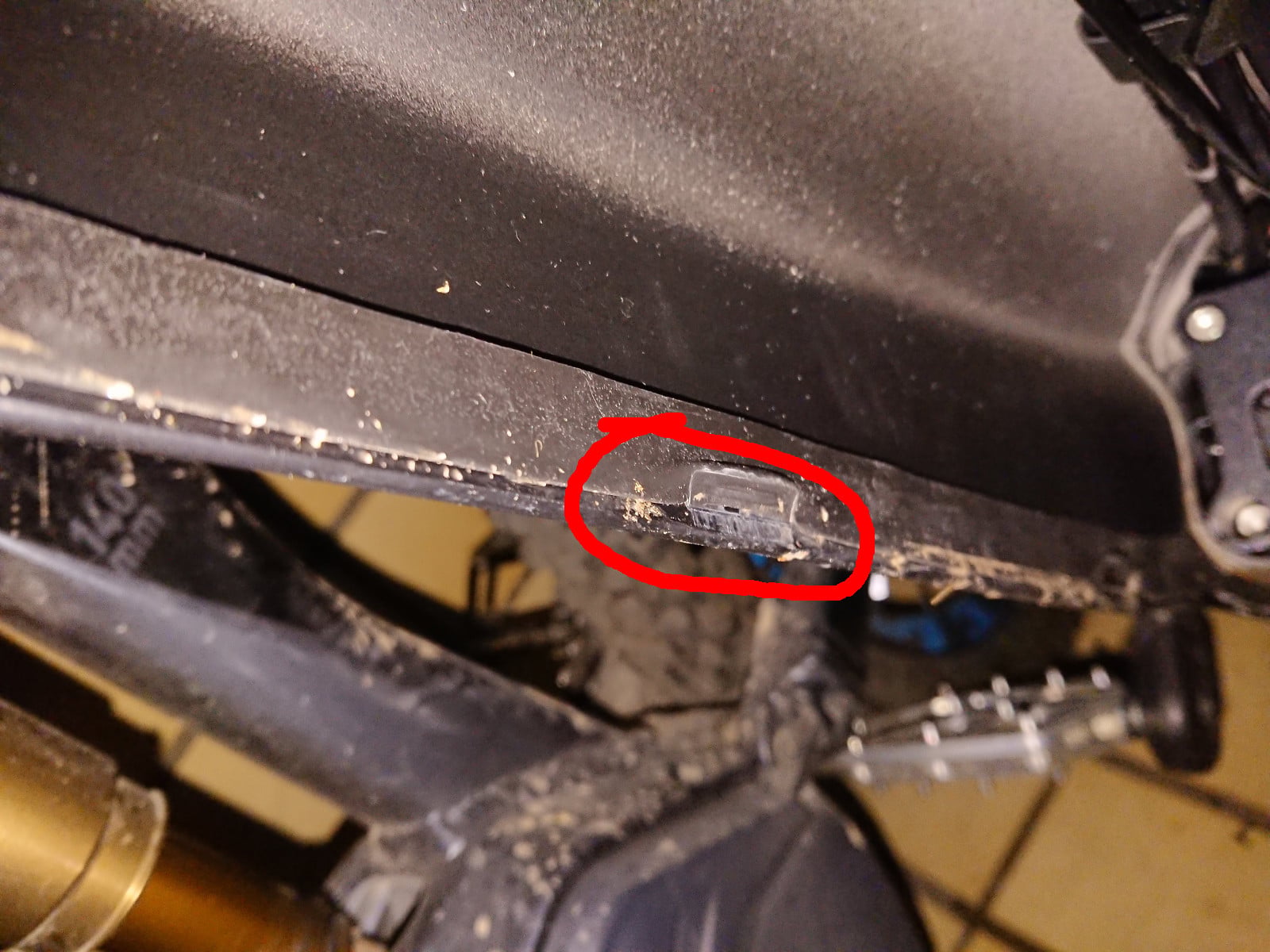

Has anyone got a suggestion for the replacing the plastic lugs which go in the holes on the down tube which are above and below the bottle cage mounts. Mine came with one of them missing 🤦‍♂️
Same tape I used above. M3 mastic tape 2228. Cut a nice circle out of it and nobody will notice. Or buy battery extender mount.
General rule in life. There is nothing you can't fix with silver duct tape (even wife that talks to much 🤣). I added mastic tape to the mix. These 2 will fix a rocket. Silver tape actually did just that on Apollo missions. Multiple times.

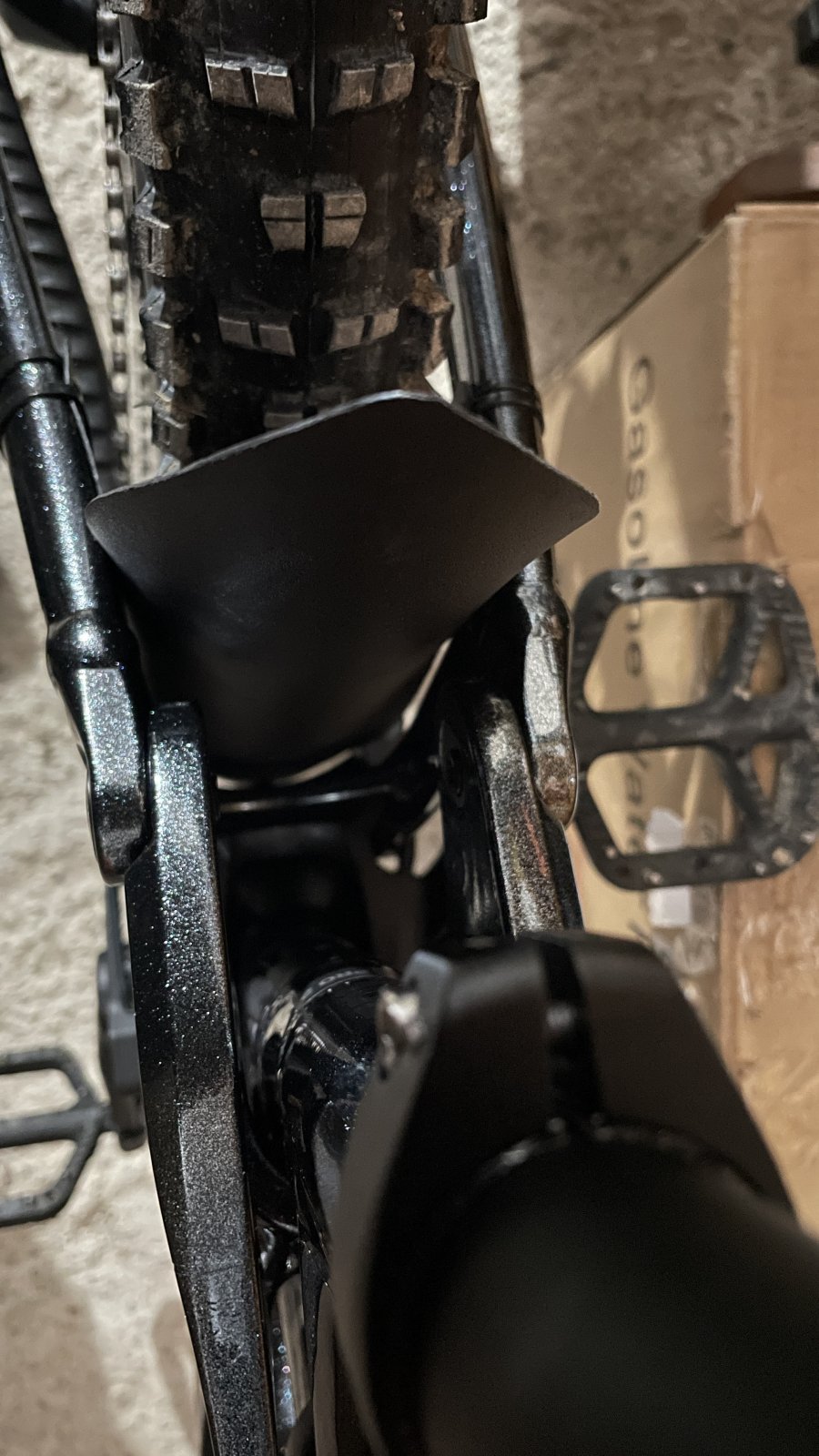

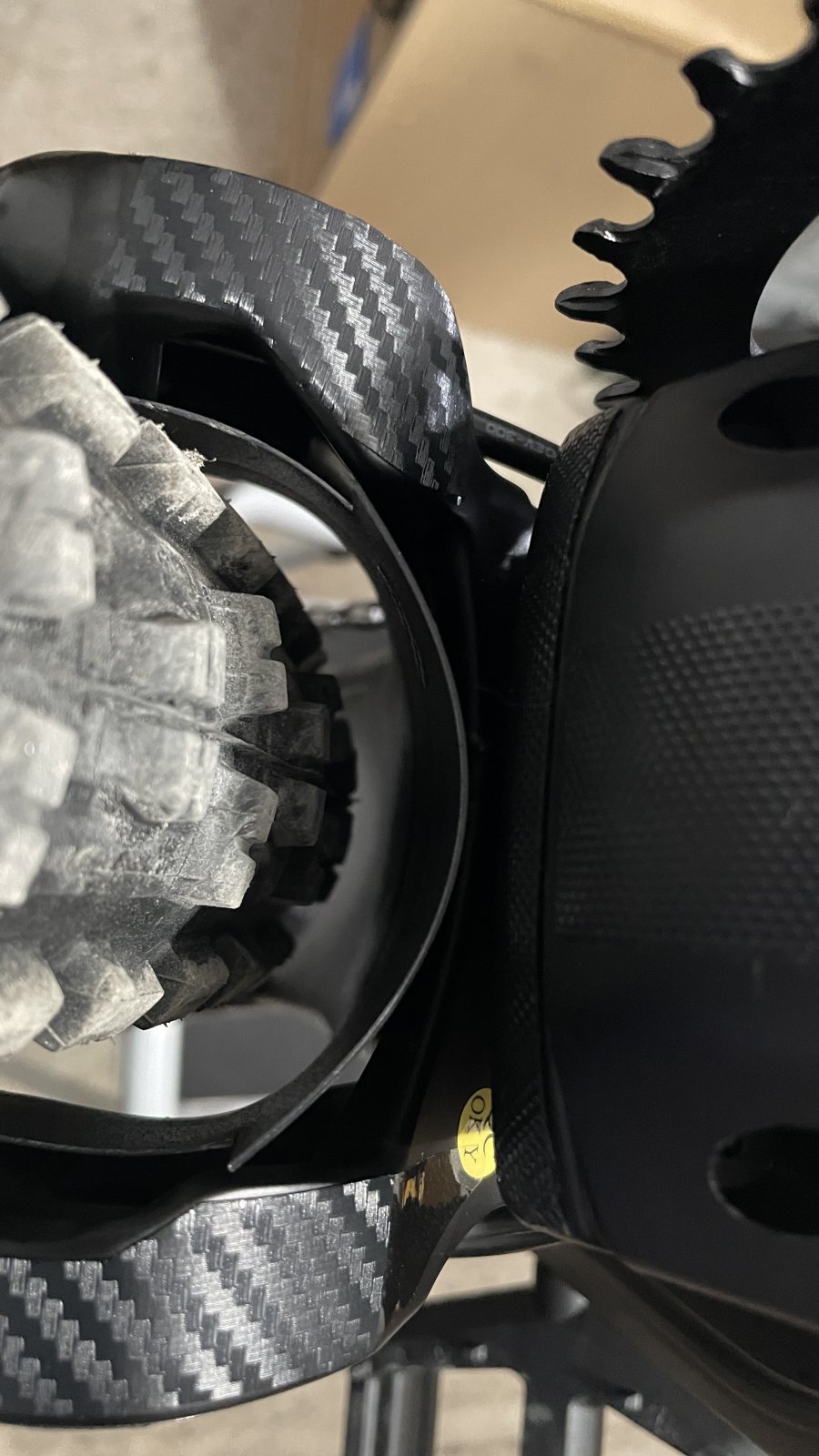

hello, can you give me some information about the rear fender?
i set mine to the high setting right away and it still seems extra low. this is due to the weight and is std for all eebs, but also the fact that it's really designed as a self shuttle bike where other eebs are more trail bikes. i did the same, ridden a couple of very janky xc trails (easy to access) just to get used to riding the bike and it's still fun, but it was clear to me that it's not the bike's happy place.
i also put my preferred dropper at 210mm on right away. given the weather it will be a while before the good trails and big descents will be open, but i'm stoked for this bike.
Did u ride the 2020 reign? That was low!

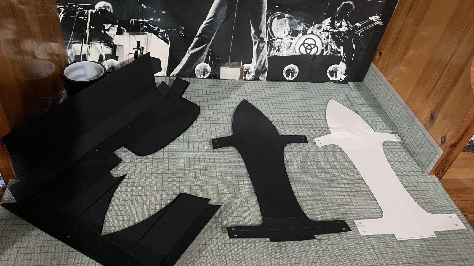

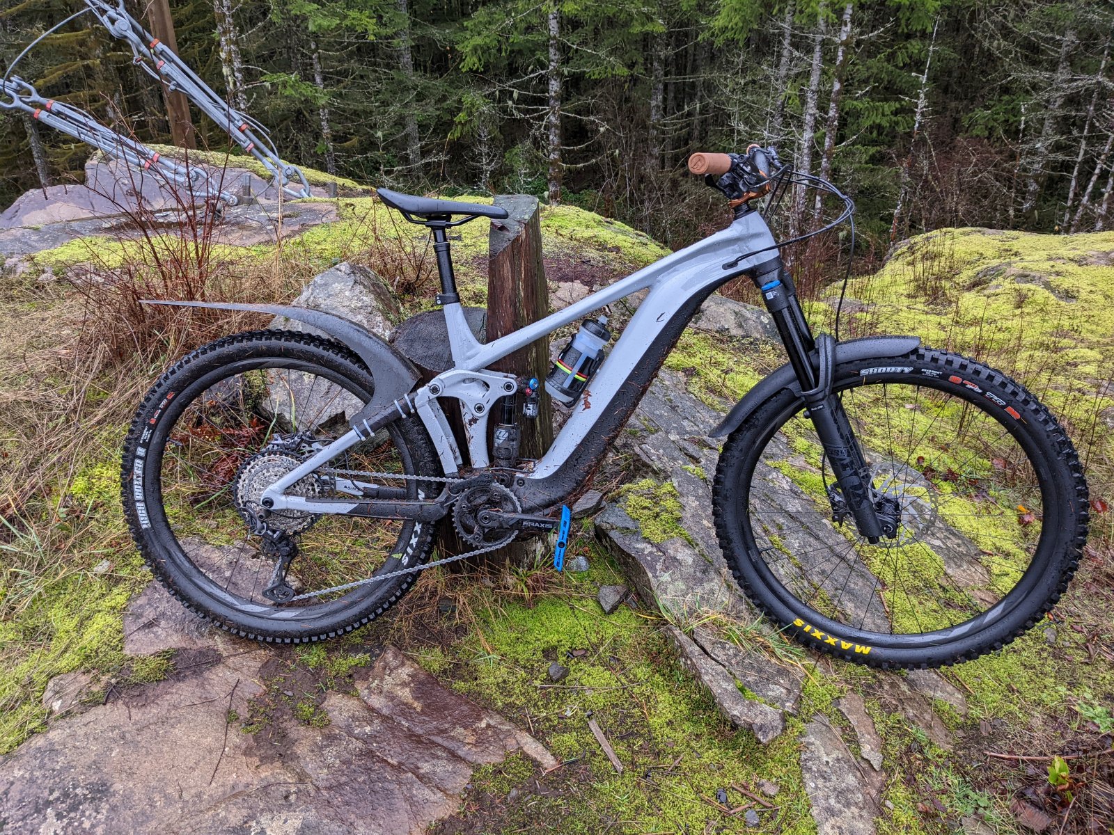

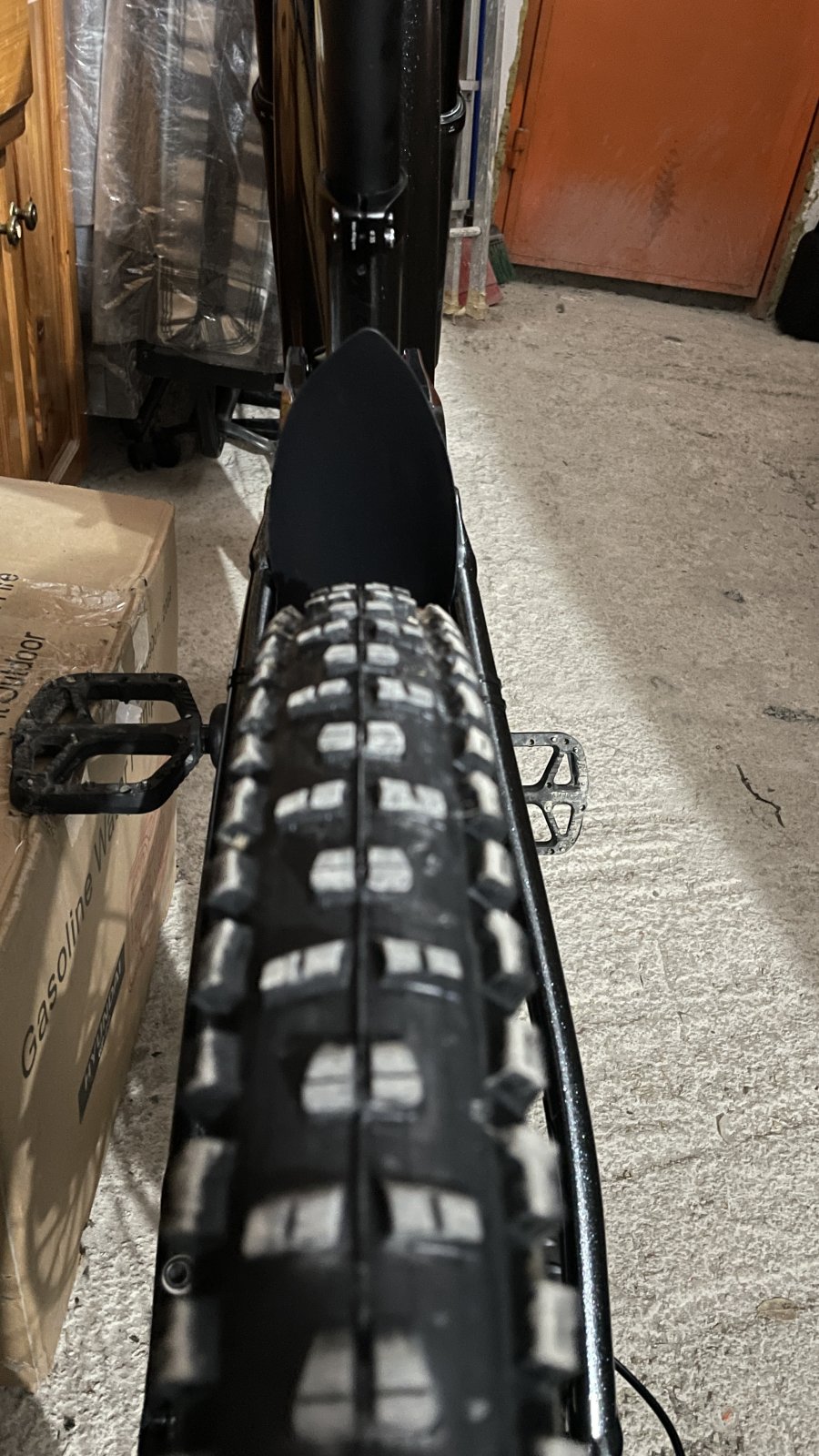

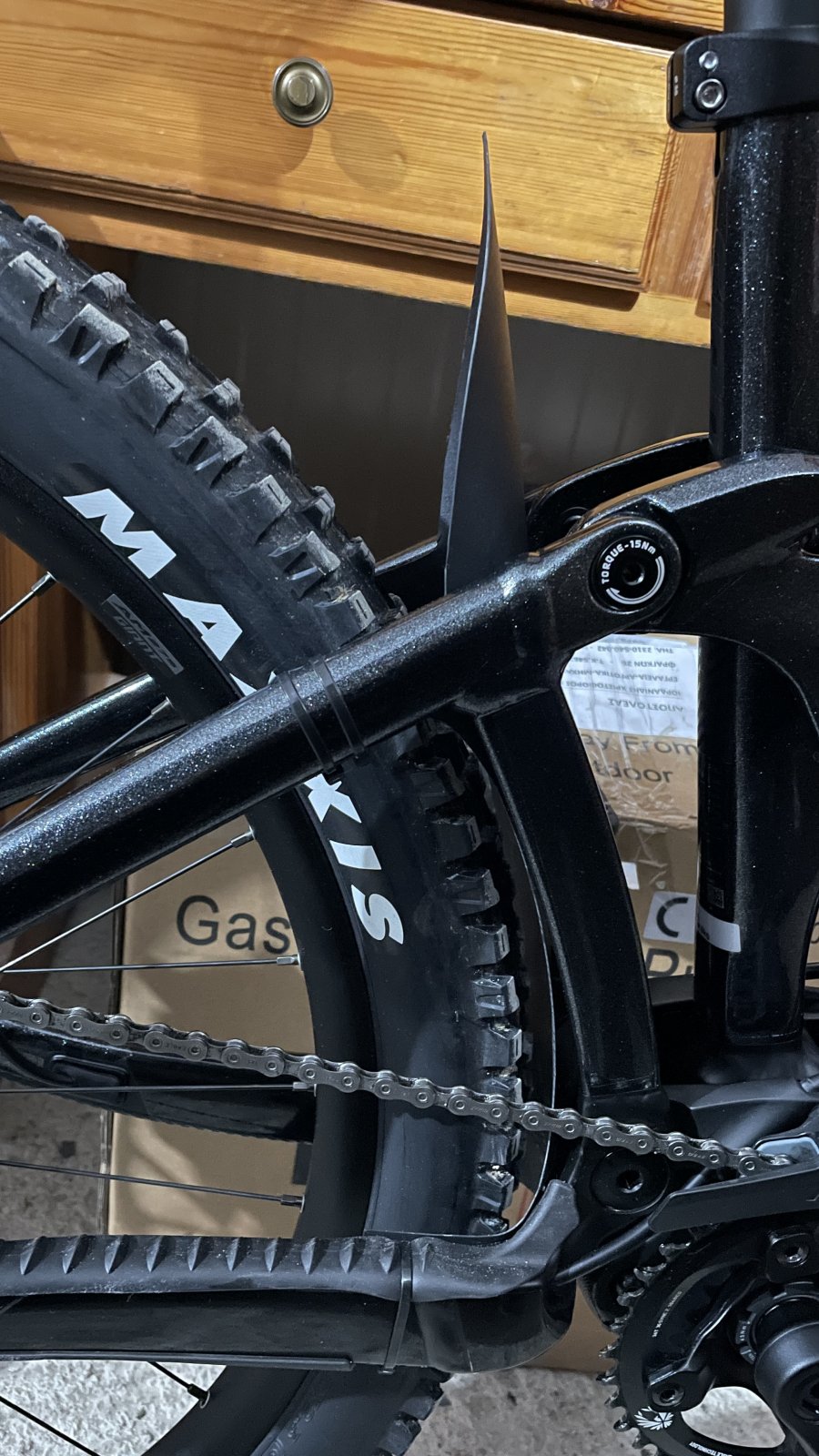

I make my own rear fender , it is protect all the rear link from rocks,mud and water without any issue.The shape at the top is not sharp anymore ,i did it more round. this work great i did it to all my bikes all this years and save my frame,my bearings and my ass.
