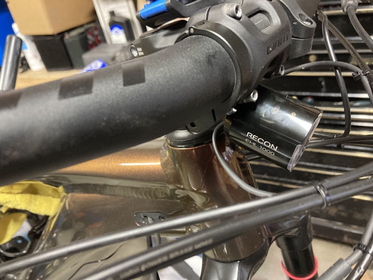

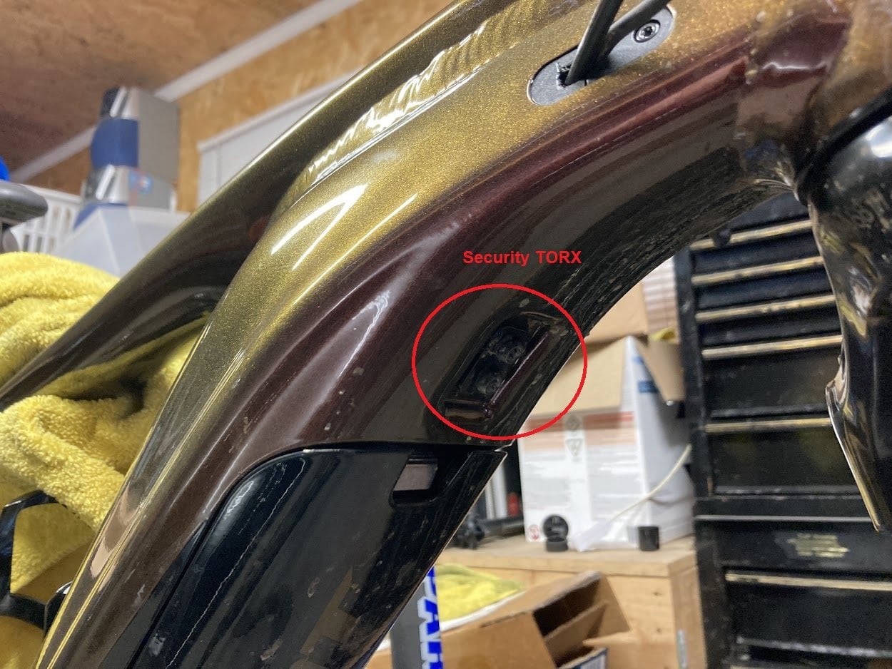

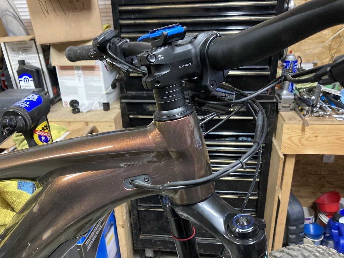

Hi!
I installed the same light on my 2021 Trance X E+. The connector is tucked just above the battery top retainer. I had to remove the battery and the retrainer (2 security torx). The light has a wire long enough to leave the connector inside the down tube, I ran the wire thru the right side groomet along with the dropper cable.
Here's a video I found helpful:
Keep in mind your GIand light will connect directly to the bike cable, no cutting or splicing required
I had to readjust the battery retainer a few time to get it to the right position, it might take a few tries.
