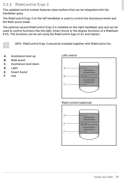

I put the same light on my 2021 Stance as well but I think the problem is with the new controls on the 2022's would it still work? I'm not sure how you'd turn the light on/off with the new buttons in 2022.

I bought them fitted them, the functionality was horrific so they went back, they defaulted to full power whenever i switched the bike on, and as other pointed out with the 2022 controller you have to reprogram a button for lights meaning i lost walk assist which was a no go, shame the supplied switch did not do on/off.
