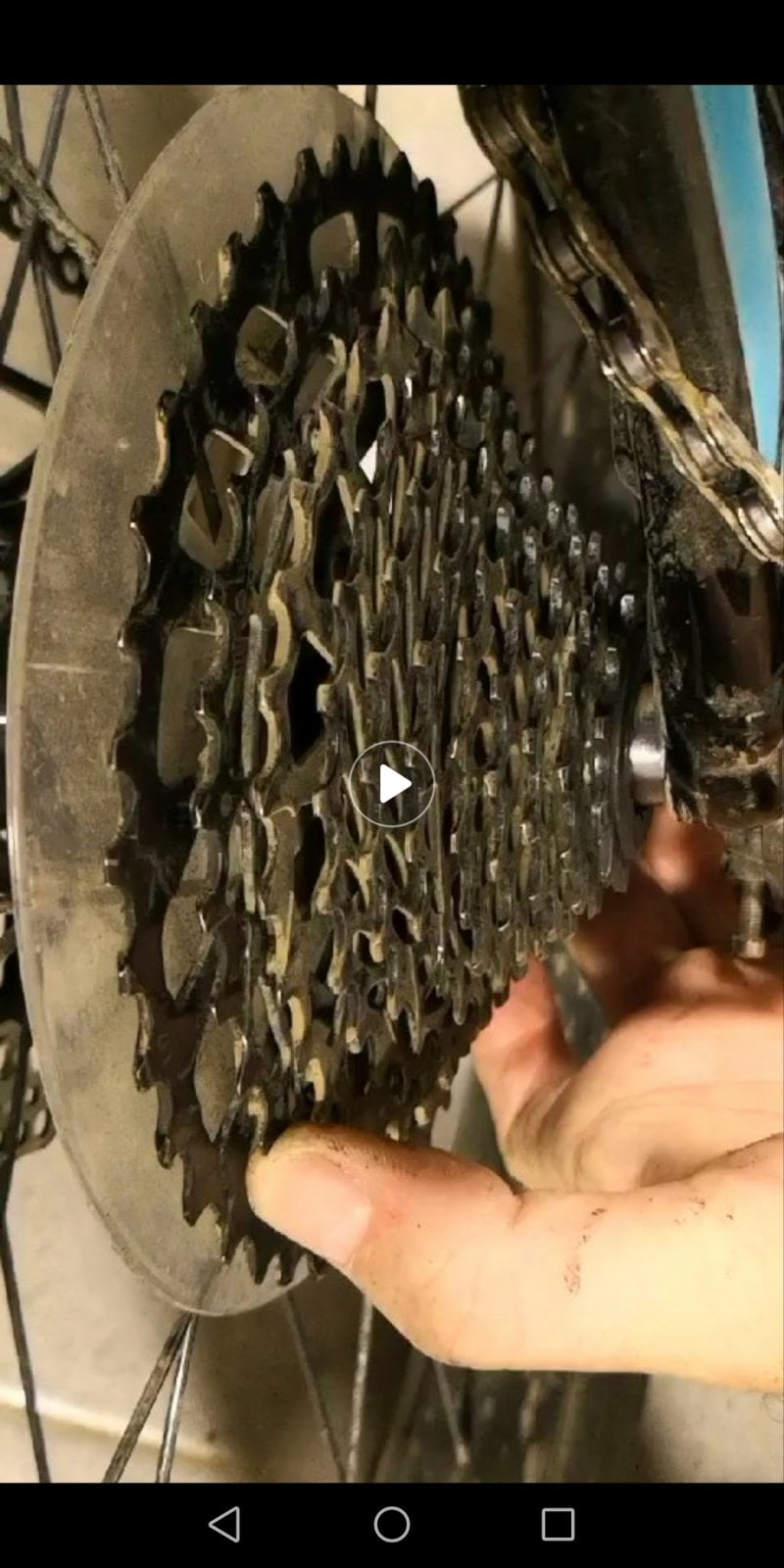

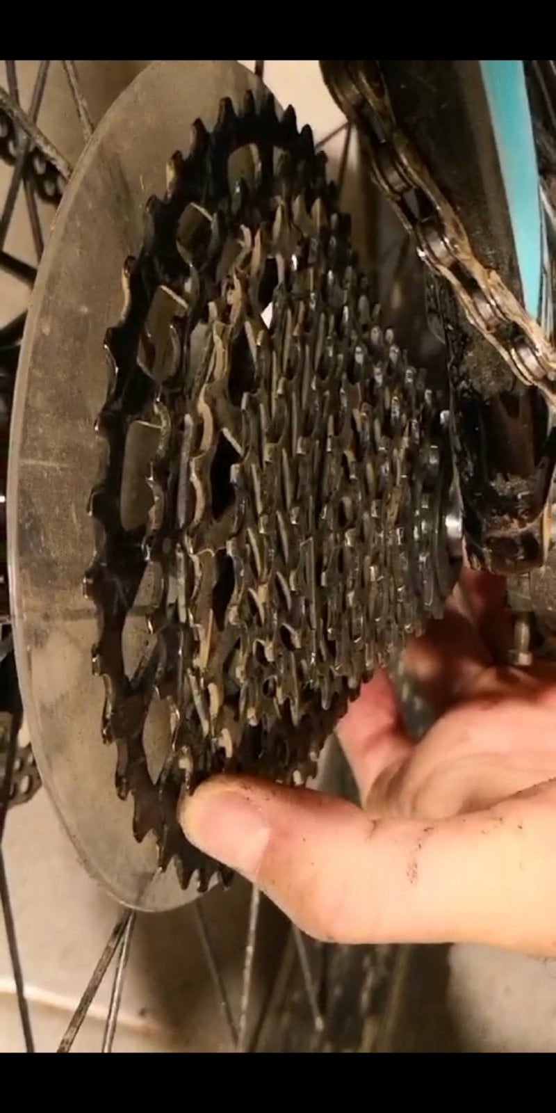

Update....!
Well.. I had to open my big mouth!?
In the middle of yesterdays ride... It came loose again!!!???
After checking it at home, and wondering why I can't get the gears to shift consistently, even after a new chain, and multiple adjustments.... I realized the whole cassette! Slides back and forth, from side to side.. about 5-6 mm play! So how could the gears work properly... When the cassette's never in the same position!
HELP!!!! What do I do!?
There are no loose nuts.. tried to loosen the cassette but, it's tight as can be! What's happened?
See attached video...
Well.. can't upload video, but look at the gap on the right side of the cassette, in the two screenshots..btjetes a big! Difference.
Tim

Update....!
Well.. can't upload video, but look at the gap on the right side of the cassette, in the two screenshots..btjetes a big! Difference. View attachment 15961 View attachment 15961 View attachment 15962
Tim
You may of done the bearing in the freehub.
Best way to check is to pull it apart.

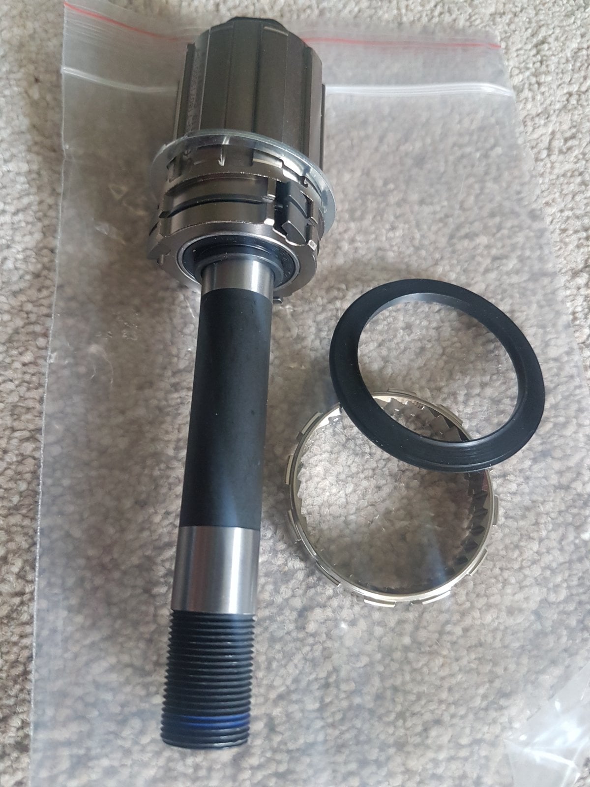

Had this happening to me yesterday... Figured out that it was the locknut of the axle that holds the freehub in place on the cassette side that became loose. The cassette was moving from side to side as well (the whole freehub was actually moving with the cassette).
What I see is that the locknut locks directly into the bearing, and it doesn't have another locknut to keep it from loosening again. I don't know how much I should tighten it against the bearings, any clue here? I wonder why it doesn't have another locknut like the traditional "cone and locknut system" where the cone tightens against the locknut. I feel that if I tighten too much I might ruin the bearings, but if I don't then it may become loose again and ruins the whole shifting...
Any comments here?

I tighten the non drive side until I start to feel a little drag then loosen it a quarter turn and tighten the locknut against it. On the drive side I tighten finger tight plus a quarter turn. In both cases you are only adjusting against a cartridge bearings so the objective is merely to remove any play. Slightly overtightening then releasing off ensures the axle bearing faces are fully engaged against the bearings without apllying too much pressure on the inner race. Threads should be clean and lightly greased.
