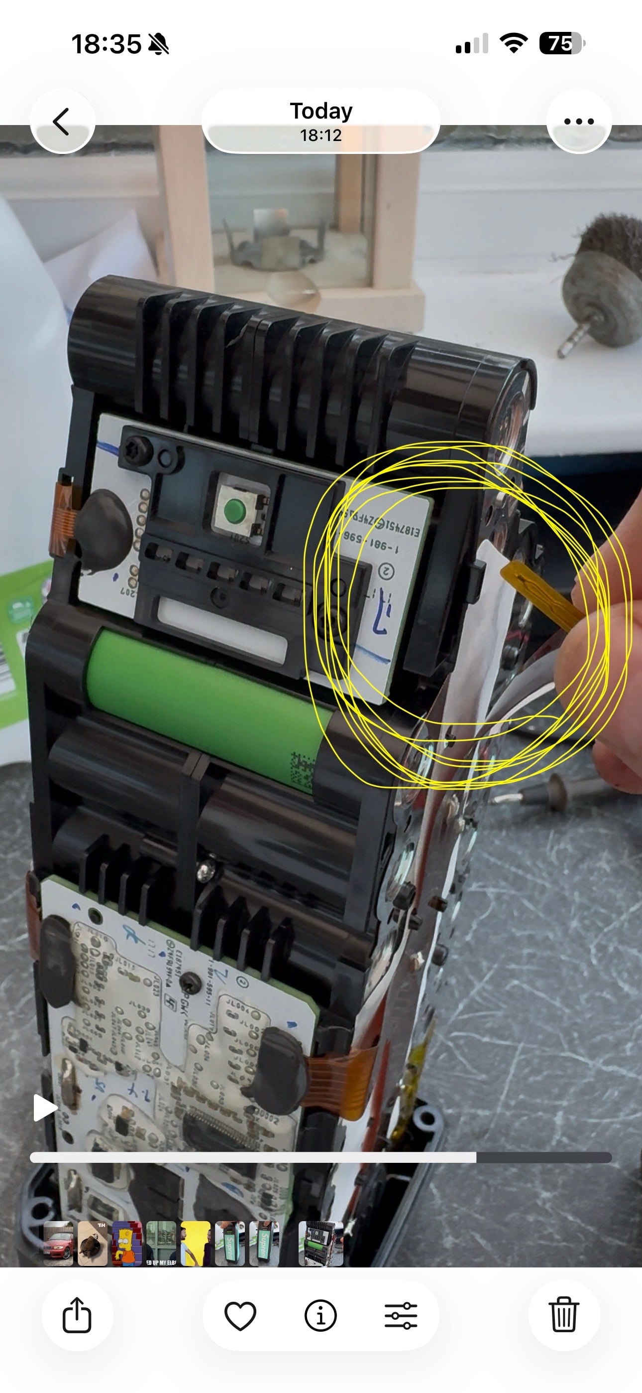

The wife’s Vitus has developed a problem with its BT8010 …..it’ll take a charge and the charger comes up with no faults ..
But the battery won’t turn on without having to REALLY press the on button and then it’ll show five lights , but waggle the battery and they’ll flicker …..what’s loose 😳😳😳 or is it rebuild time …
I’ve opened the battery and there’s a clip that goes to the back of the power button that seems to be disconnected or just slots in?!!?
What’s this and is it supposed to be loose ?!😳🤷🏻‍♂️
Soooo update , tried a few things and touched a few bits , but I’m not brave enough to mess with it …but discovered if I push and hold on the corner of the front board near the connector ribbon the lights come on and stay on, take pressure off , lights go out ….simple fix or 🤷🏻‍♂️
