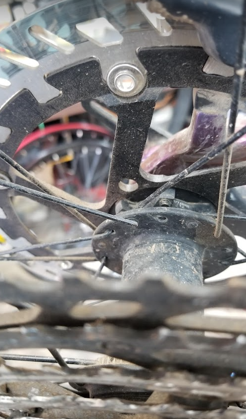

Rail spoke size is 280mm

Well that's the size spokes needed for my rail7 bontragers. I'm posting this in case anyone needs to go into a shop to buy one then get told to bring the wheel in - then get told 2 days later when the next spoke breaks to bring the wheel in ...again.
Also a good tip is if a spoke breaks tape the nipple/spoke in place on the track so the tyre etc doesn't have to be removed for the replacement spoke.

I snapped two spokes on the rear rim last week and took the wheel to my local dealer. He sold me 2 spokes for 2 bucks each but said they are asymmetric. The nipples were still in place since they snapped close to the hub, so it was easy just to slide in the new spokes and tighten them up.
The dealer said that if I snapped any more spokes he would cut them to length based on what side snapped. I think he said the asymmetry was only a few mm or so. This is the first bike I've snapped spokes on. Bent rims before but never had spokes just snap on level ground.

Ahh ok so maybe that's why I had to take them into the shop.
I initally broke one spoke at the hub, wedged it into the rest of the spokes to carry on the ride, forgot about it then the derailleur snapped the next ride. I assumed I hit a rock but wonder now if the spoke got loose & caught in the chain pulling the deraileur back. Got it fixed then next ride another broke & while fixing that saw another bent which I think may have been from the derailleur hitting the wheel.
