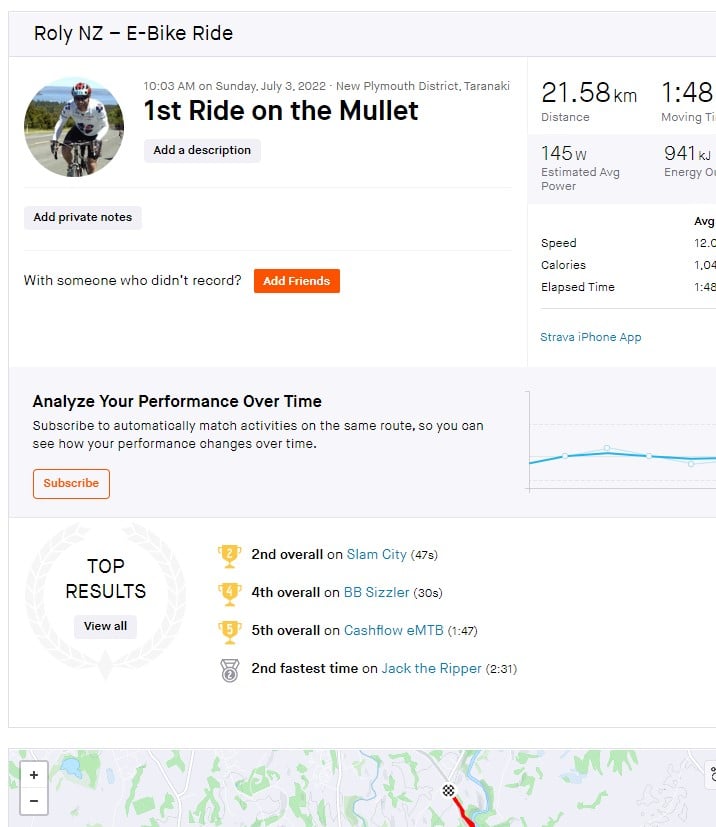

Anyway if it was I love it thanks. I got the e-bike rated rear wheel, I think it just means 32 not 28 spokes and they are a little thicker. I set it up on a Maxxis Assegai 2.5" that I robbed off my poor pedal bike. I didn't adjust the wheel size on Kiox, I don't think it makes any difference unless the bike shop does it, TBH I don't think LBS will do in here in NZ but correct me if I am wrong.
So speed/distance is measuring wrong, Strava says 21.58km and the Bosch App says 27.14 so reading 25% faster/further than my phone GPS.
First ride it felt sweet, turns in quicker, definitely noticed the snappier feel when turning. I always felt my Rail had plenty of grip, I think it's better in the rear now, don't ask me how but I just feel more confident. Could be placebo... could be I just spent $450 so it has to be better...
So on my first Mullet outing, after a week of storms + rain, trails were in good nick considering, I was frothing to give it a good workout, and my strava tells me I got 3 top 10's which has never happened before and it's wet and slippery.
Awesome bro. Yeah I really like mine too but haven't managed to thrash it yet. Feels totally different aye? I don't strava as I go so slow the app thinks I'm asleep but good to see the comparison of the speeds. I was cruising along up a forestry rd & it was reading 21kph so I thought it might be 5 kph or so over.

@Doug Stampfer Mate was it you that put me onto the PUSHYS RACEFACE Wheel deal in OZ?
Isin't this where you start running into issues (Especially if you have a bike in the UK and have a 25kph cutout :LOL:) so effectively the Kiox/Bosch cuts out at 32kph so according to your findings your actual speed will only be around 27kph?
Seems like you'll be really limited on most trails at that speed? I ride my analogue bike on XC trails at well over 30kph
@JP-NZ Yep it probably does cutout way too early, but I keep pedaling, and I found pre-Mullet when it cut out, I was on flatter or down sections so I could easily keep pedaling. I have not done a ride on sealed/hardpack yet and It may be more of an issue then but I am yet to test it out.
By the way, my 25% calc may be misleading, I don't think my strava distances are very accurate as it's from my iphone. My mate rides a Bosch ebike and we had similar distance readings on our bike computers. I have just checked back over previous rides Bosh App vs Strava Distance, and they are quite different each time, Strava was only 1% out on a straightish 30k town ride and on other rides it was 15% and 23% out, so go figure, I don't know what to believe.
Bottom line so far is I like it. I will talk to bike shop mate to see if I can re-programme the wheel size as I don't think I will be going back anytime soon.
