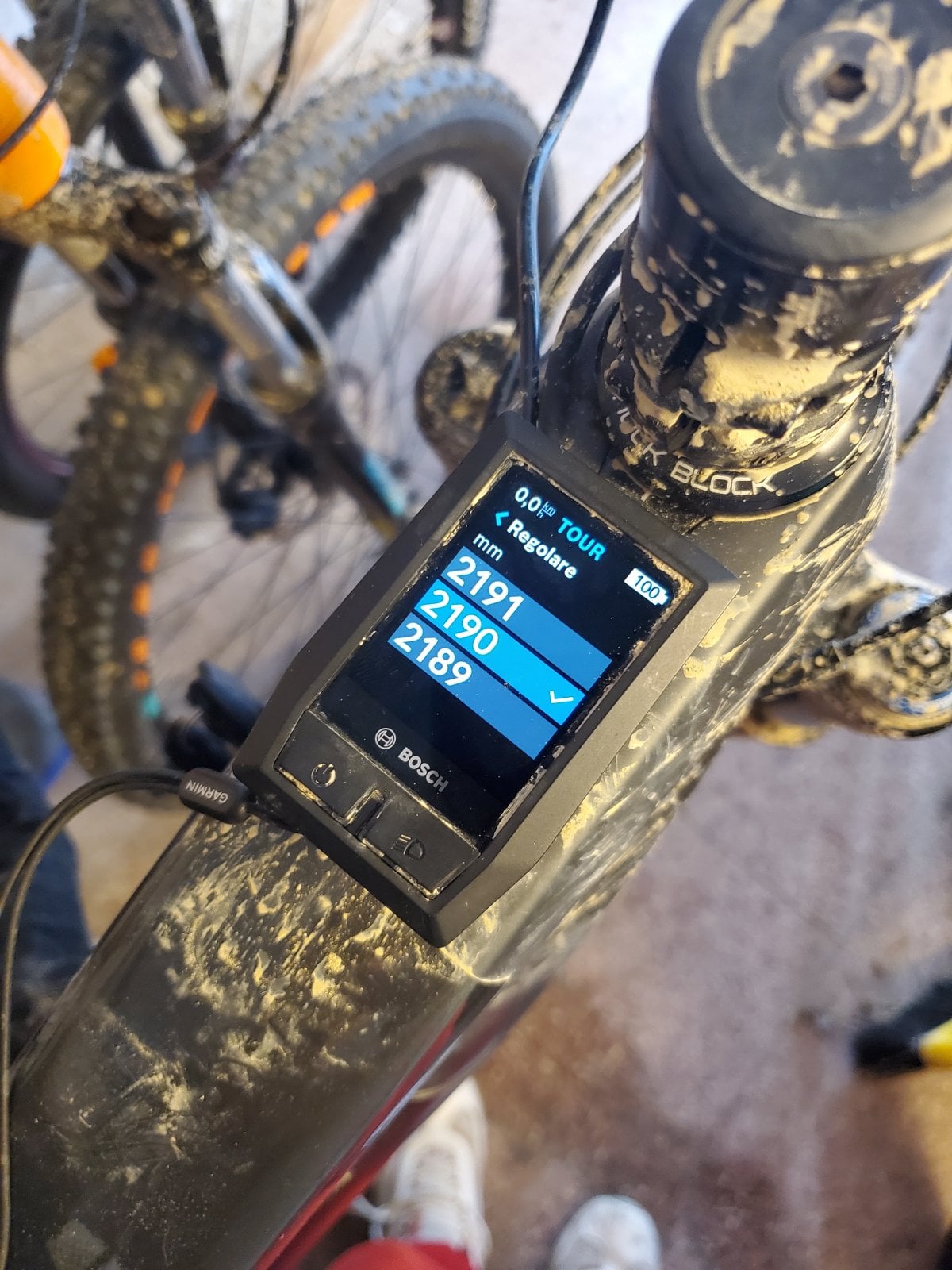

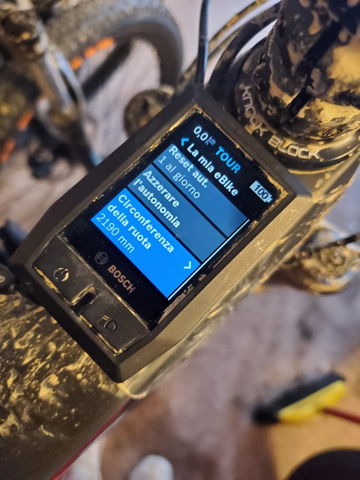

The measure to be entered is in millimeters (here in europe....) and the "development in length of the wheel" fits perfectly into the parameters of the kiox (then i take photo with the exacly measure that i put in kiox.... that i don't remember exactly)

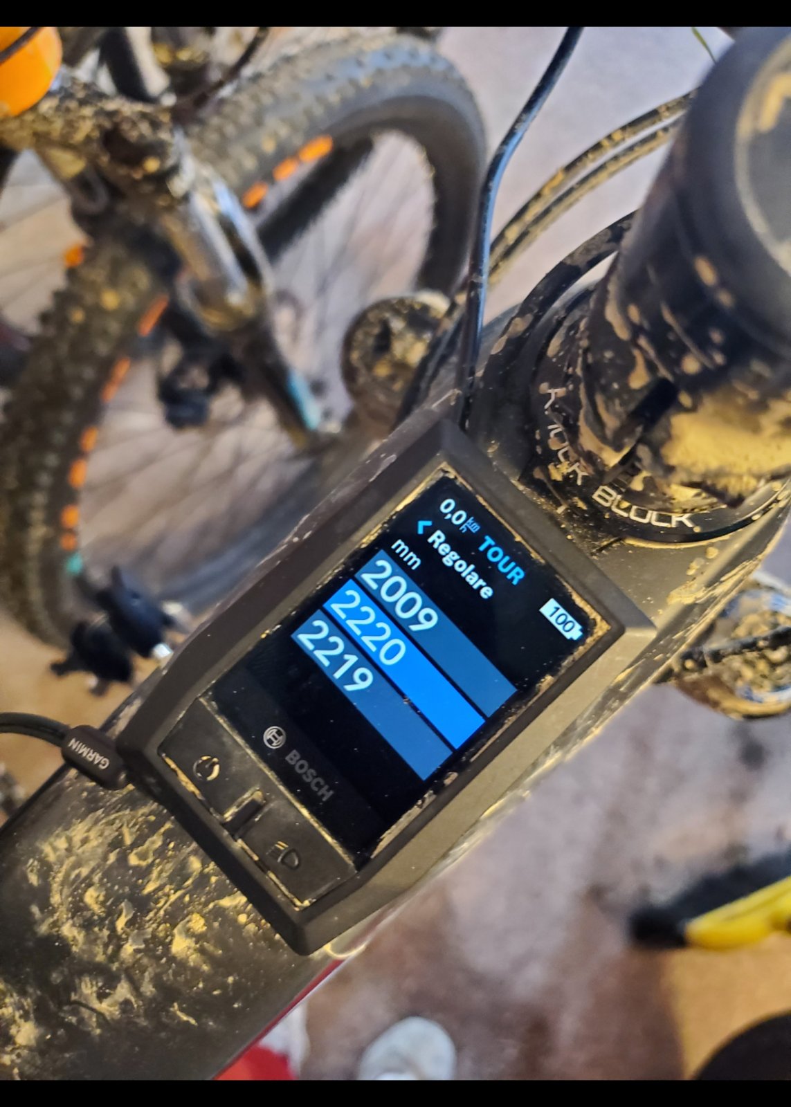

Taken by making a mark on the ground and spinning the wheel .... just to be specific...) the adjustable "pitch" is from 2009 to 2220 .....
Taken while i was on top (due to the crushing due to the weight) and, as you can see, ...i set it to 2190
Controlled the speed (which, i repeat to be the only parameter that the different wheel affects) is perfect!

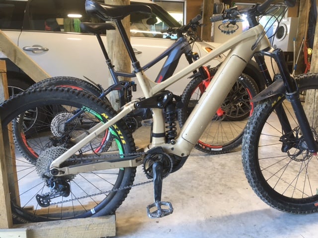

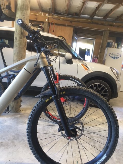

I did bit of a mullet trial today. I used the rear wheel off my Giant trance analogue bike, swapped the brake rotor & magnet & set it up.
I took some measurements while I was doing it in case anyone was interested in the results. There are some comparitive measurements with the wifes Merida E160 -700 that inspired me to mullet mine.
Ground to rear axle- Rail
29.0in 380mm, stock
27.5in 355mm (low position mino link)
27.5in 360mm (high position mino link)
27.5in 360mm - Merida E160 -700
Bottom of pedal to ground -Rail
29.0in 175mm stock
27.5in 155mm (low position mino link)
27.5in 160mm (hih position mino link)
27.5in 165mm - Merida E160-700
Chainstay length ctc 450mm rail, 440mm E160
front to rear axle Rail 1245mm E160 1225mm
By eyeometer the forks looked pretty similar rake
The test ride was over a few different tracks. The 11speed casstte with 12speed shifting was actually not too bad. I timed the shifts ahead of time so was pretty careful not to change under load. I was expecting to have more pedal strikes however tried to ride it as normally as possible to get an accurate comparison.
I could definitely feel the difference riding up. Felt slightly more upright than usual & the tight uphill corners were easier to get around.
1st track was flowy berm with a couple of easy jumps. Noticed straightaway it turned in quicker mid berm if I was over cooking it.
The following tracks were rooty off camber & often dry powder slippery. A few corners into it I settled into the groove & it began to feel very similar to the Merida. More front wheel style riding & the back just followed obediently through ruts & around roots.
During a couple of sketchy drop corners where I thought I may lose the front in the loam I found I could flick the rear round pretty impressively. This may however had been aided by the reasonably worn rear tyre.
The mullet setup inspired in me quite a lot of confidence on the downhills & when I finished at the bottom without the usual adrenaline shakes I knew I was pretty much onto a winner.
The next track was a long twisty climbing track. Only had one corner I couldn't get around but may have come in too hot.
I finished on a long flow bermed track which TBH could've been ridden well on a Raleigh 20 however I let loose & again the flickabilty mid berm saved a few bad line choices.
So in conclusion I'm really pleased with the experiment & I find the Rail mullet setup great. There was prob only one pedal strike which isn't bad, tight uphill corners way easier, more confidence on the downhills with a greater ability to whip the rear around although seldom needed. I felt no loss of stability that is a concern for some, it felt just the same going flat out fast as with the 29in. I think the only concern is a couple of tracks I ride have rock shelfs to drop off. I might have to approach those with a bit more launch technique.
