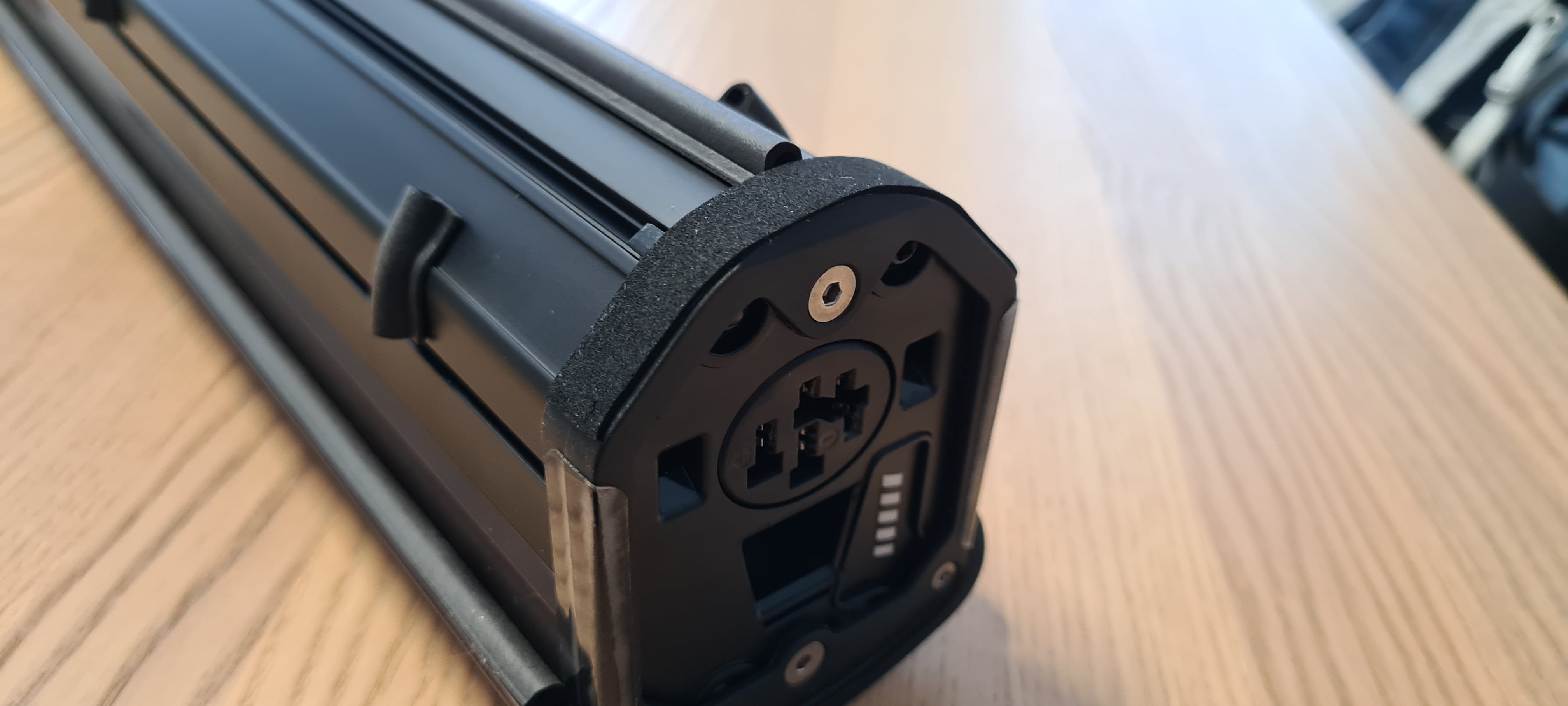

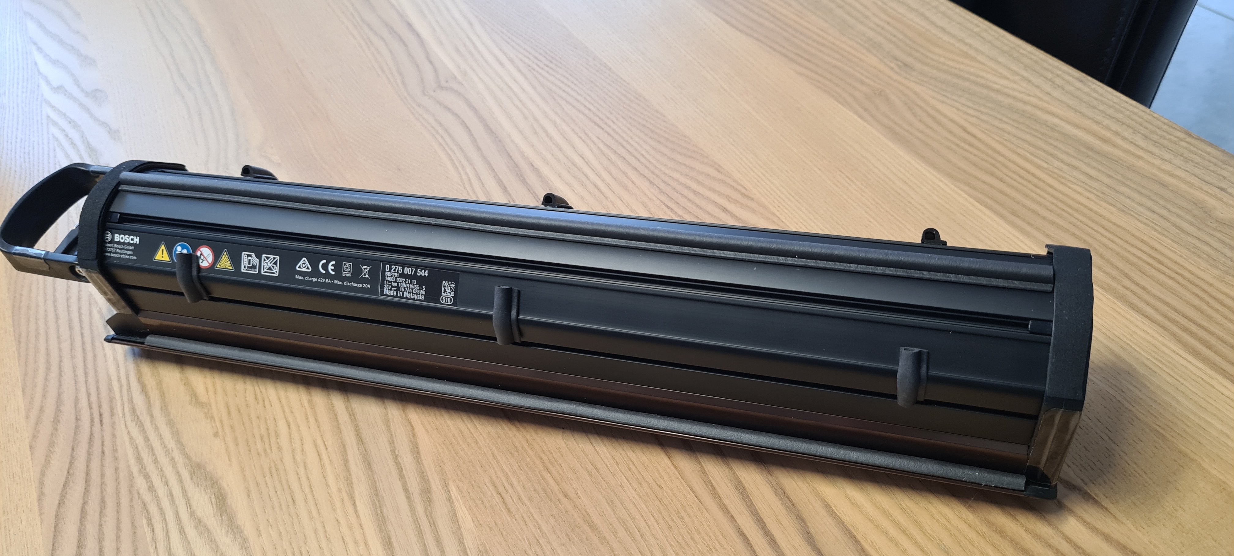

After another long ride yesterday, am still not convinced the battery movement has been cured.

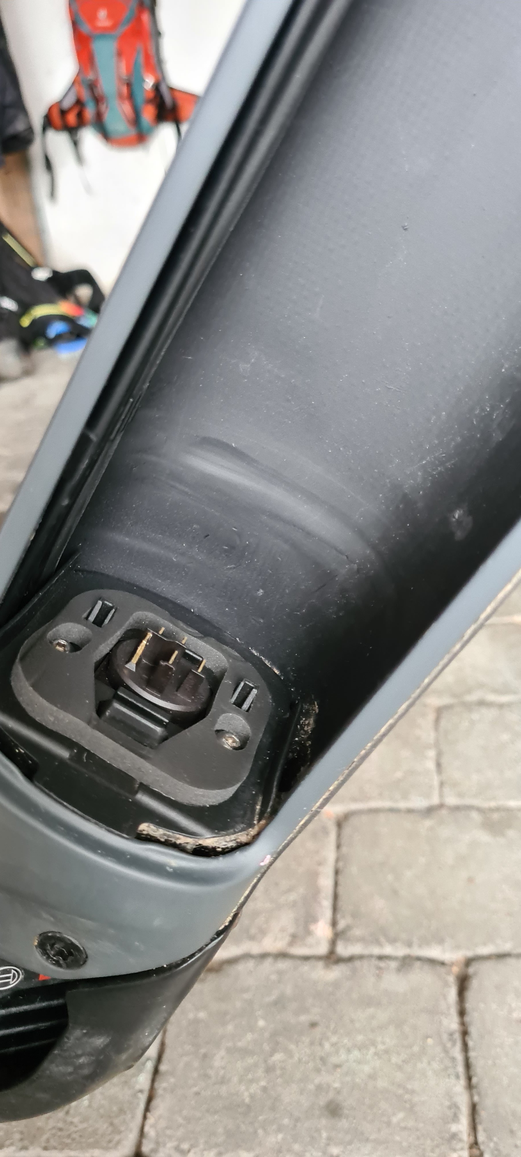

so, I had a closer look today.
Whatever movement is happening has to be longitudinal. You can clearly see from the imprint on the foam that the battery is squeezed into the frame, so I can’t believe any side to side movement is happening.

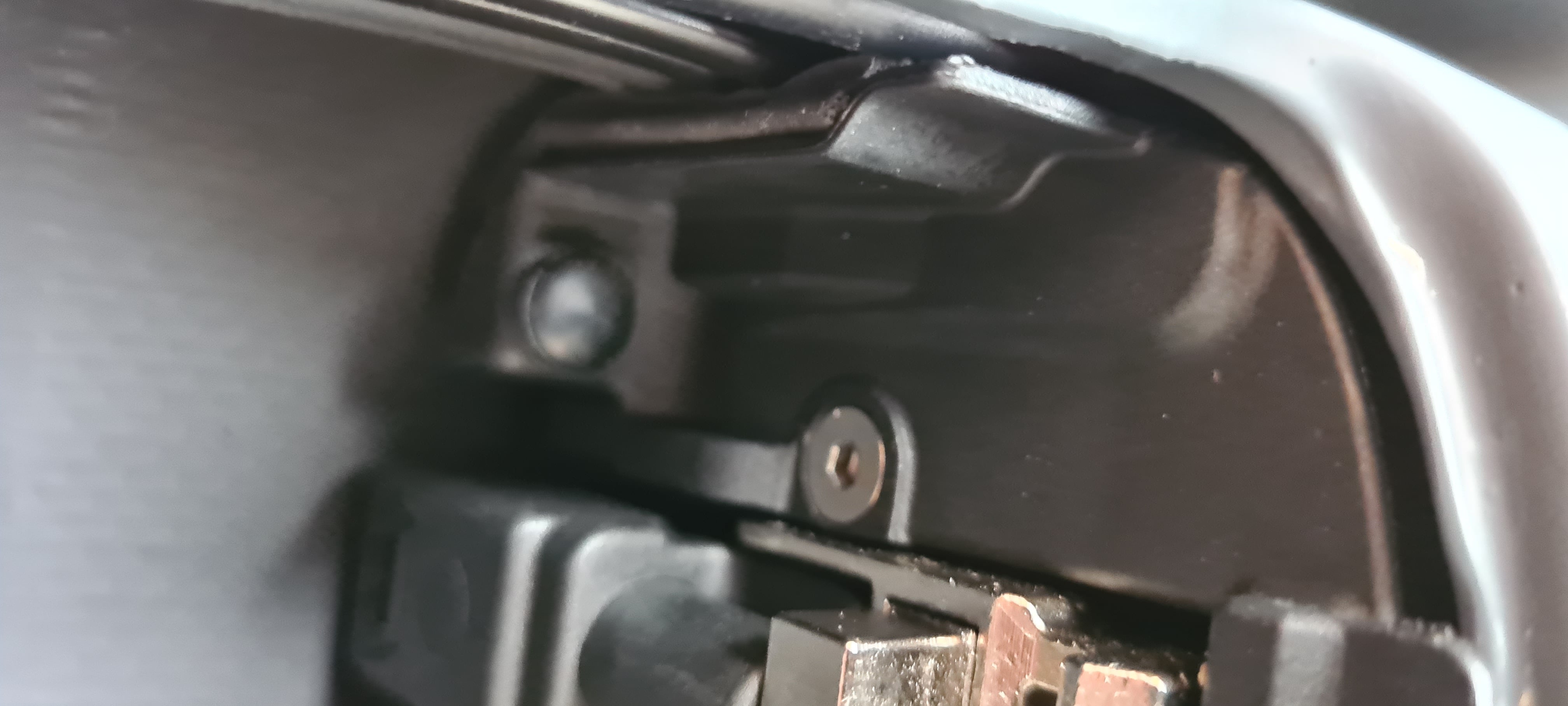

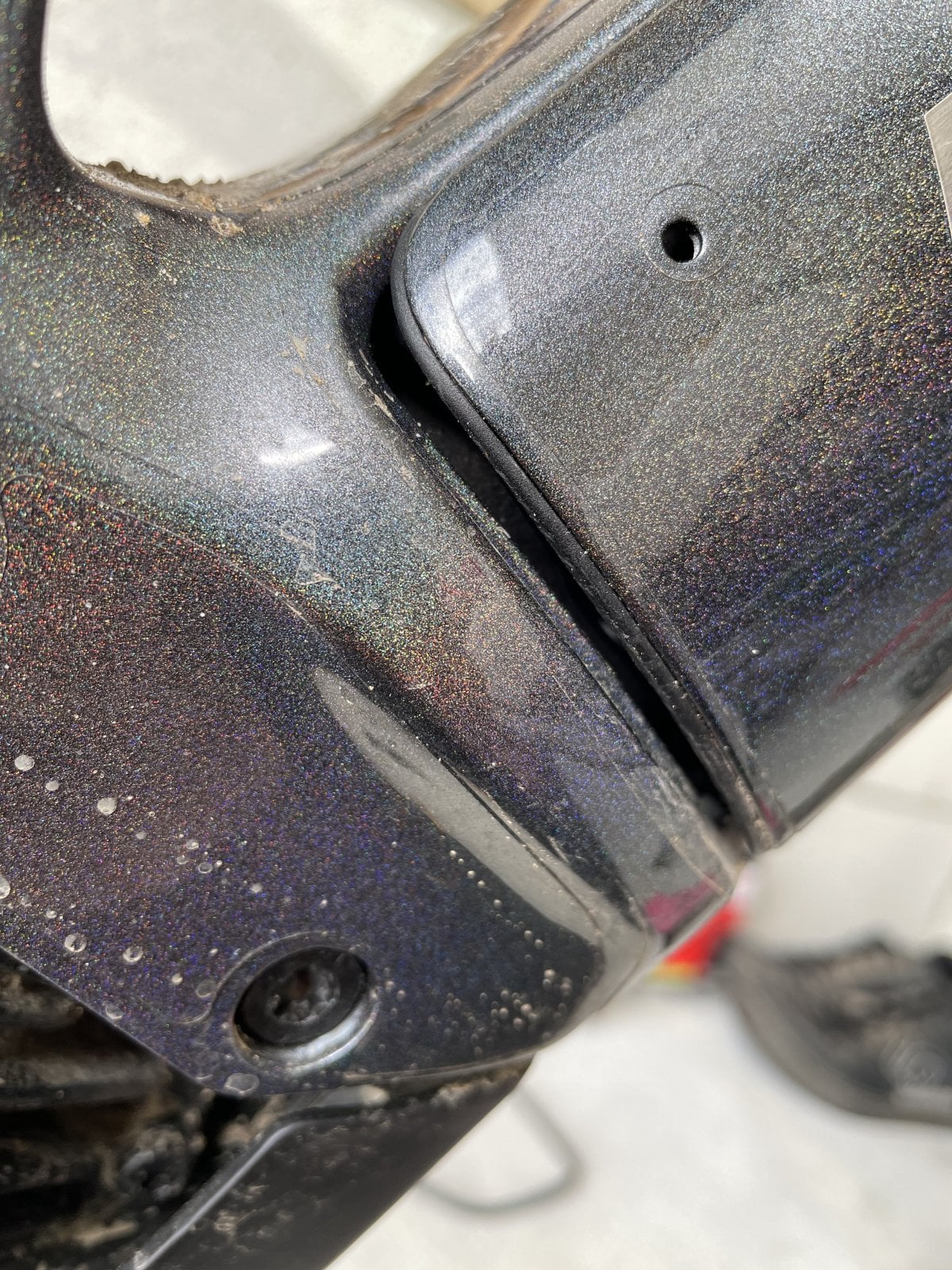

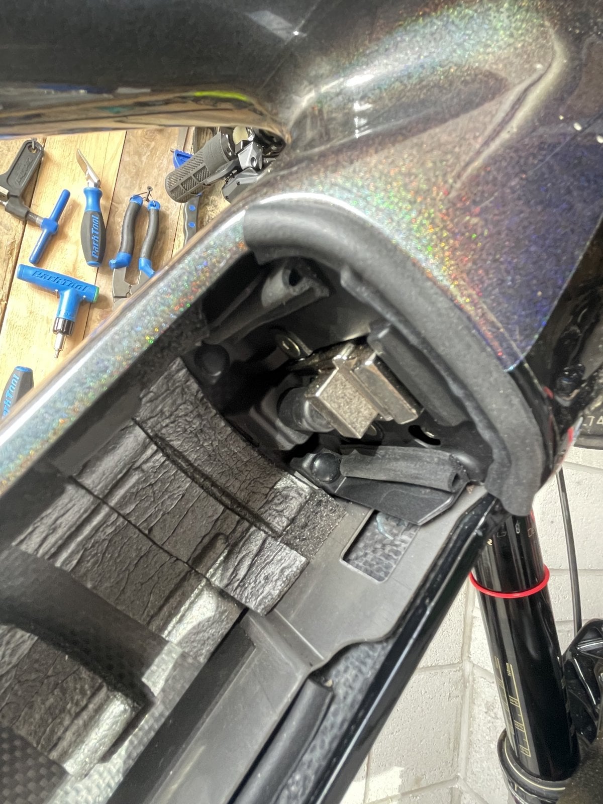

so I looked more closely at the top battery mount and the frame gaps between the battery coverplate and the frame.
there is a significant gap here

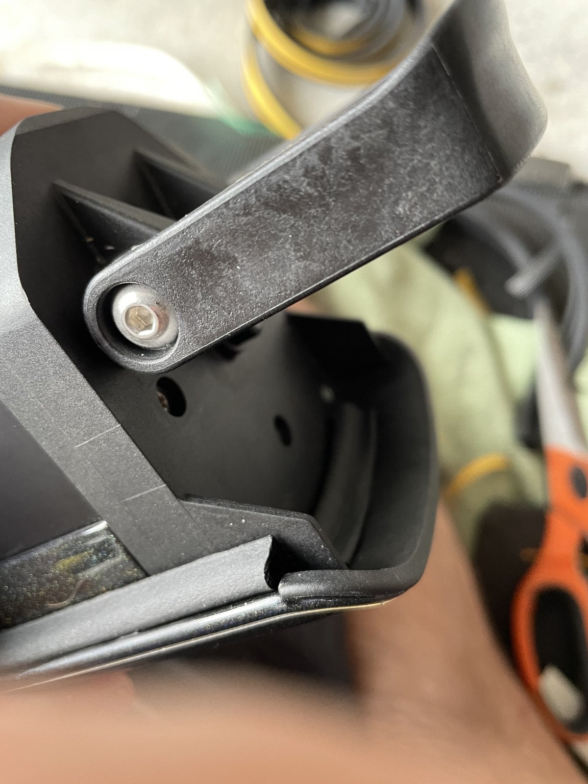

from what I can tell, the only part of the battery that is in contact with the top battery mount is the folding handle. For my bike, I think this gap is not entirely closed when the battery is fitted.

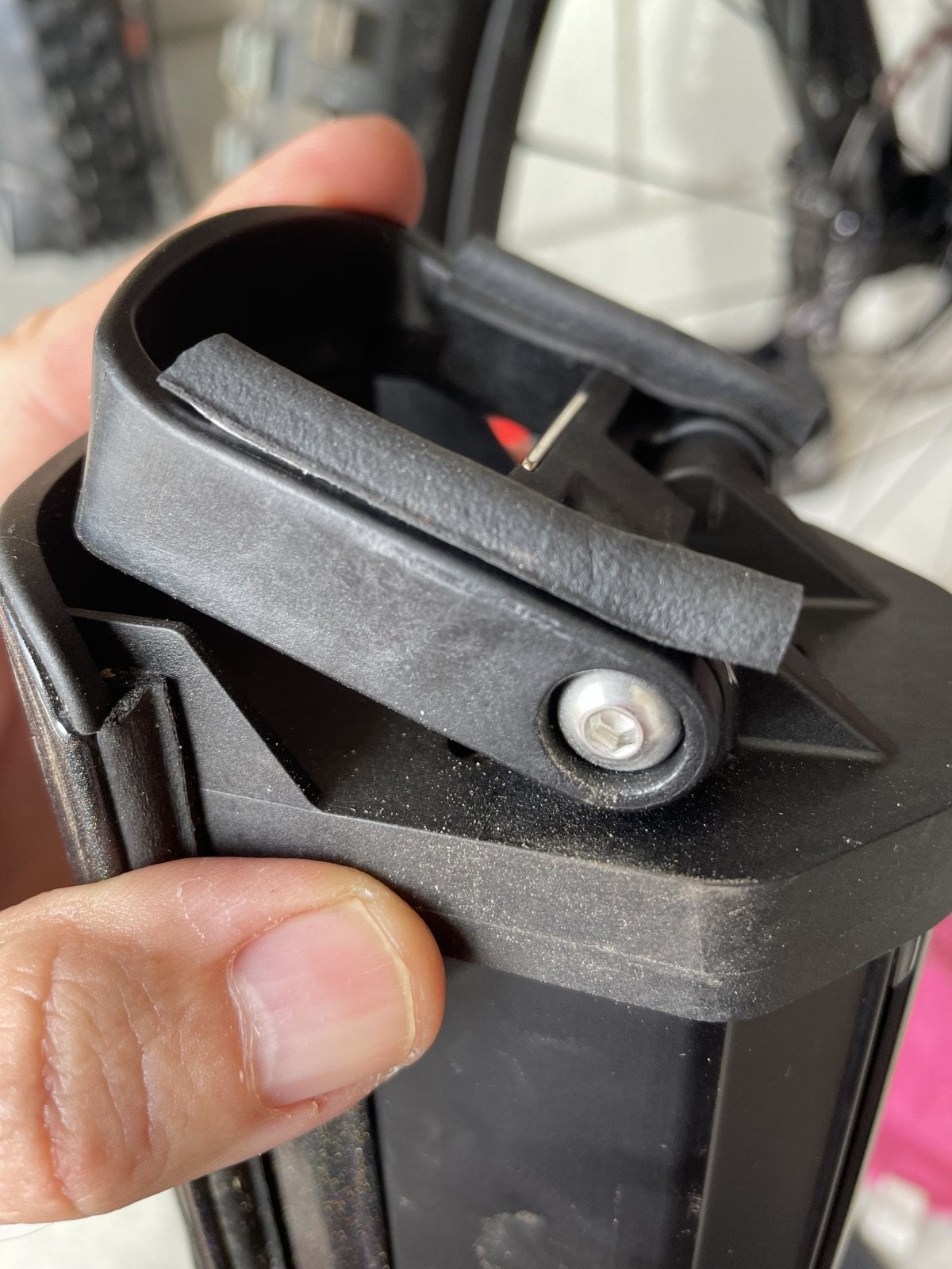

to test, I stuck some rubber p strip to the handle to see if the battery would still fit. It does, indicating there is still a gap that needs filling.
After several trials, I ended up sticking some p strip onto the top mount.
trial test
End result
The battery does go in, but with a bit more resistance and when removed, the p strip is squashed so a good sign of a tighter fitment.
for good measure I also added a strip under the battery handle.

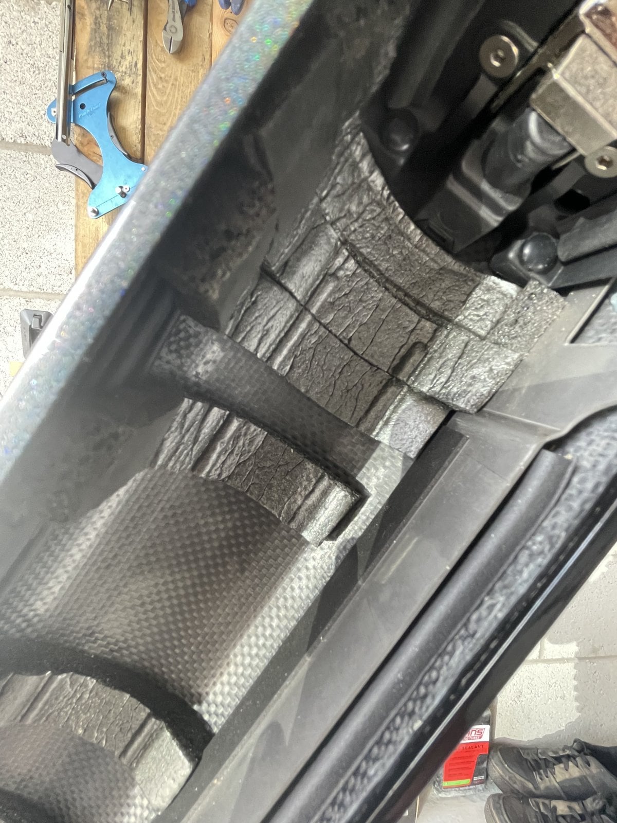

I also then looked at the foam pad from Bosch. It actually fits inside the trim on the lower part of the battery, so you are not really getting padding from the full depth of foam.

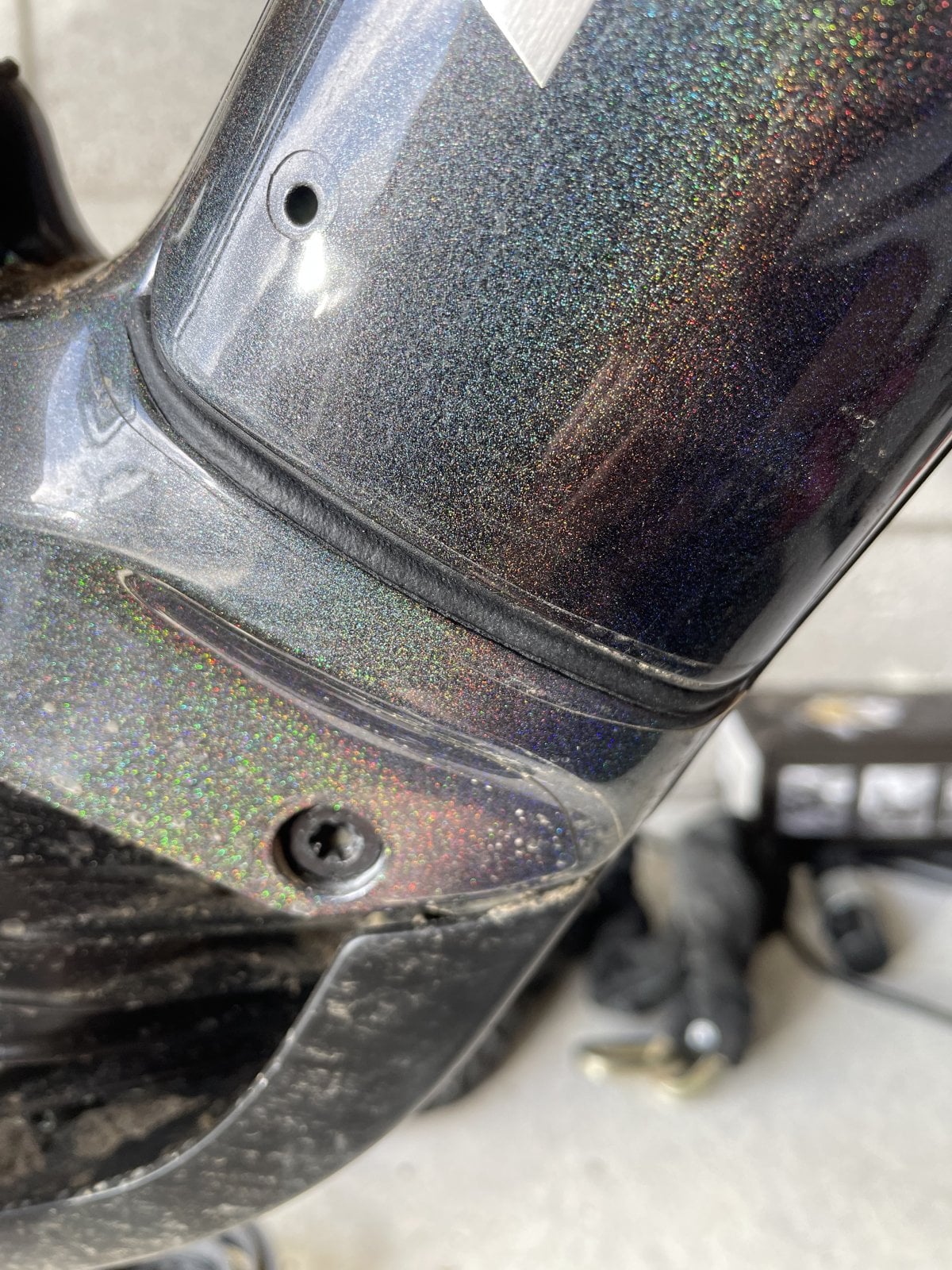

so to add more padding/anti rattle, I’ve added some more P strip to the lower battery plate each side of the Bosch pad. (Forgot to take a pic)
I’ve also used p strip to fill the lower gap.
I’m reasonably confident that I have filled all areas where there could be noisy plastic to plastic rattling. I will find out on my next ride.
