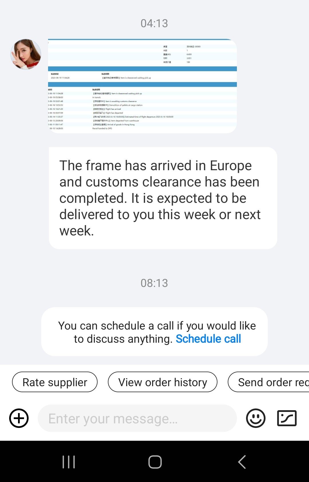

Now, waiting for the frame, ordered the 23rd with custom paint @Ben Rides ;) > Dengfu Sports Equipments Co., Ltd
Info from "Ben Rides" > « Cao Alice » on Alibaba > Dengfu Sports Equipments Co., Ltd
(For information, it is better to communicate with her via ALIBABA than via the forum)
"The frame has already queued up in the painting workshop. As long as the painting is done well and the quality inspection passes, we can ship it to you. Next week at the earliest. The normal schedule is to complete the painting within 2 weeks."

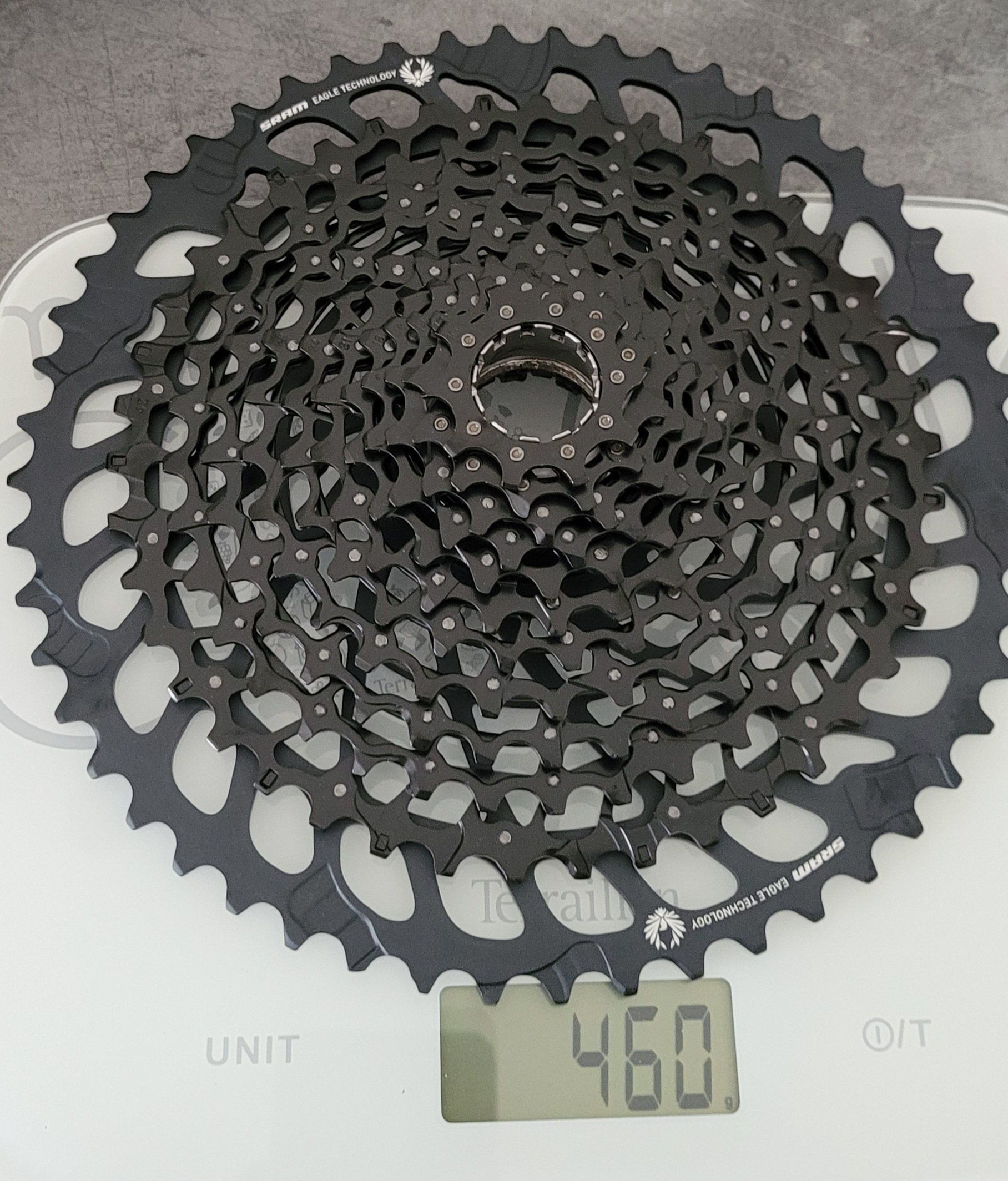

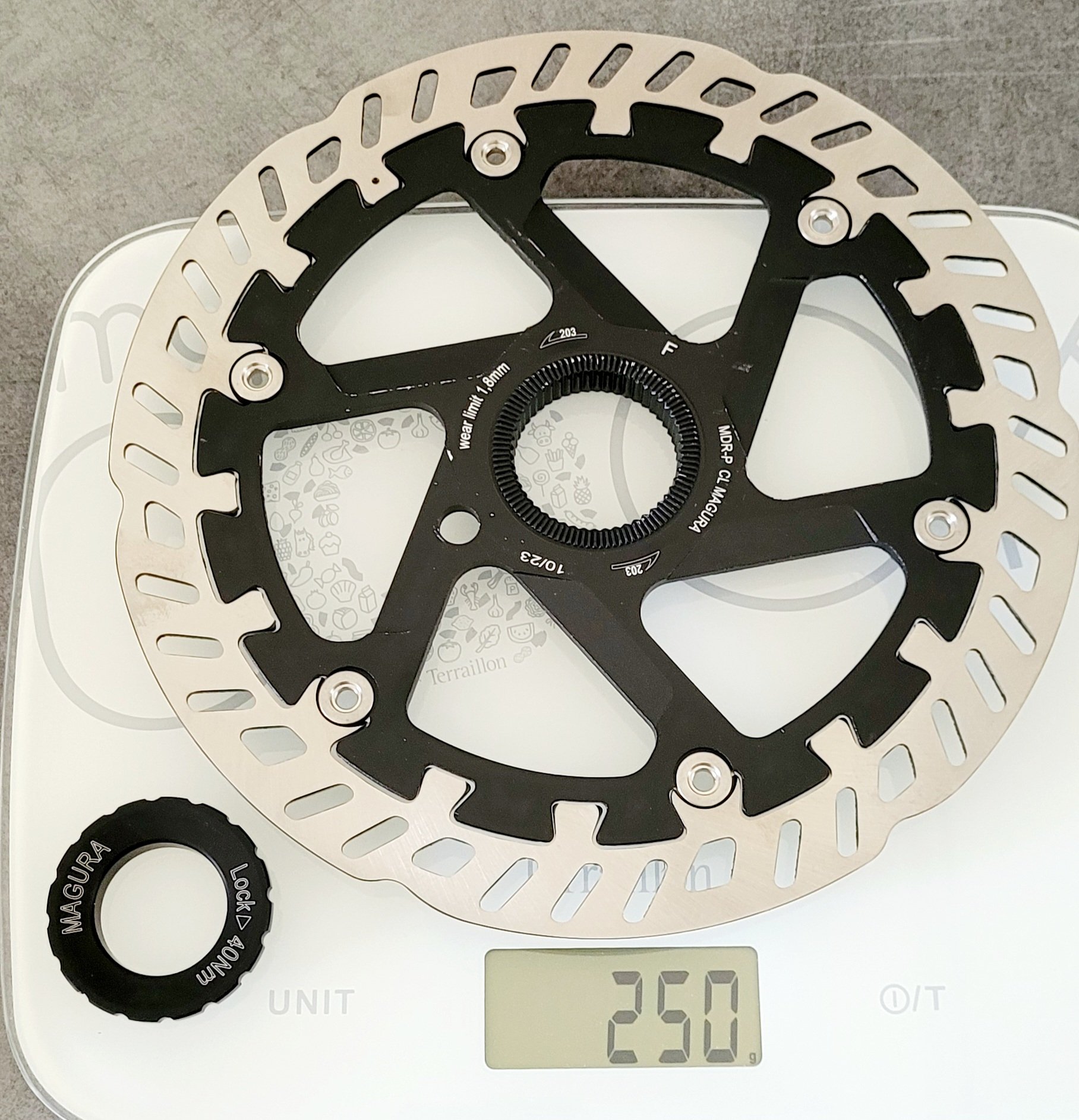

Second delivery: 😋
WEIGHT: 3087 grams
Bad decision on cassette and chain imho. This bike eats the drivetrain for breakfast. Keep an eye on Your chain wear, my chains are lasting appr. 1.300 km only. After 5.000 km on my E10 M510 I‘m on 4th chain and 2nd cassette.
Arrrg!!!😳 Which Sram cassette and chain would you recommend?
For information: To complete the drivetrain set, the chain ring is a "Sram X-Sync 2 X01/XX1 Eagle 104mm 34T"
