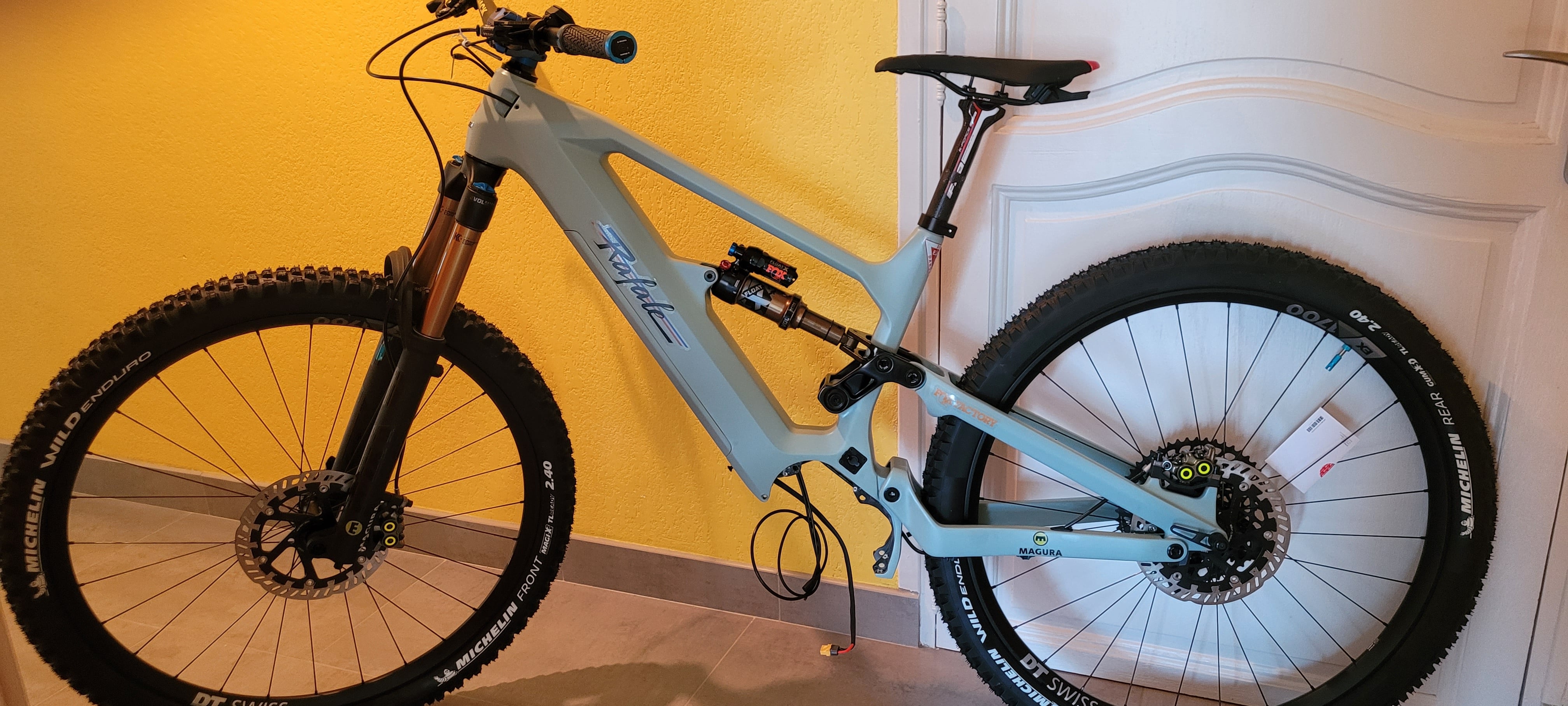

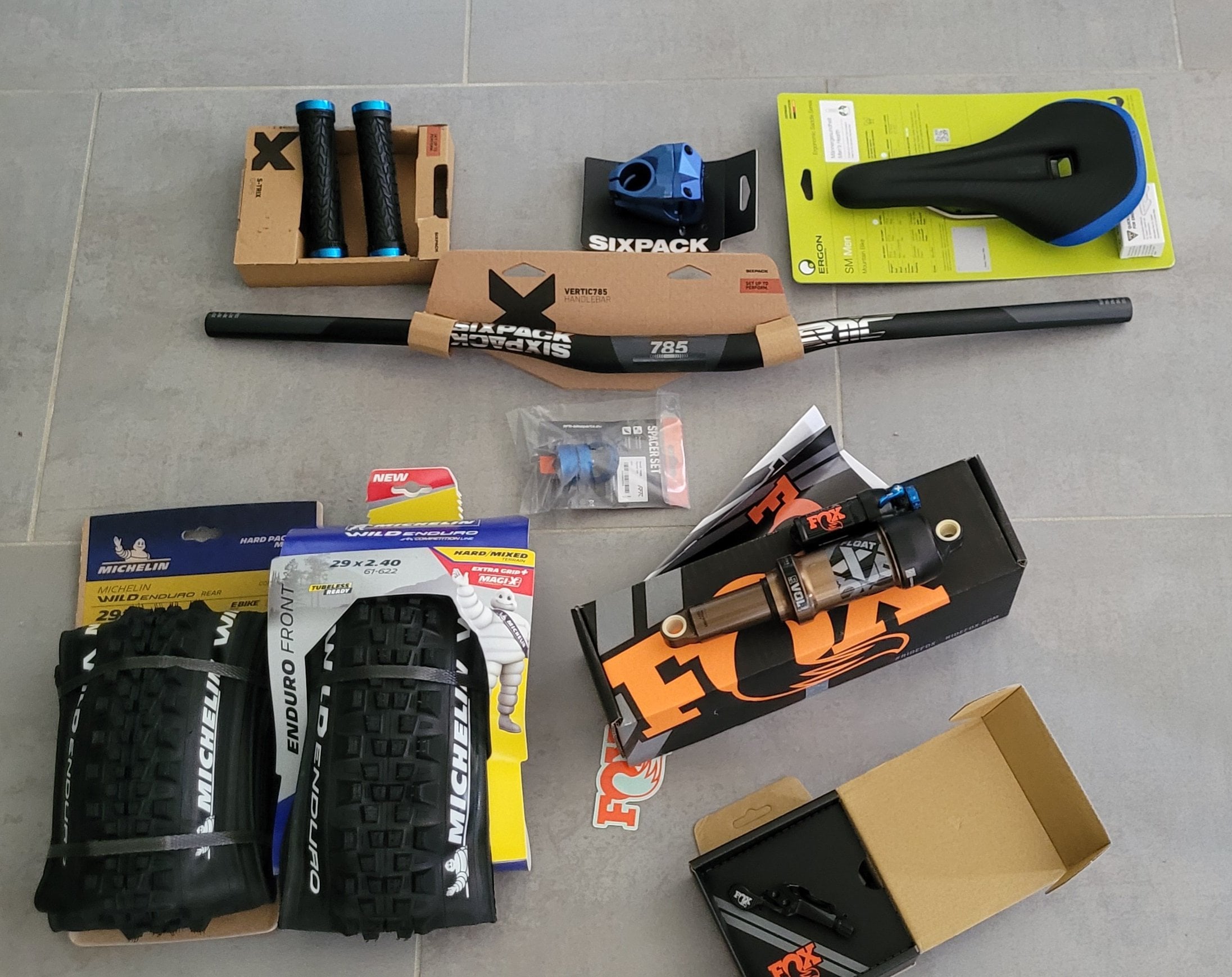

Today delivery:
(Next delivery will be the Dopper post then the battery cells)

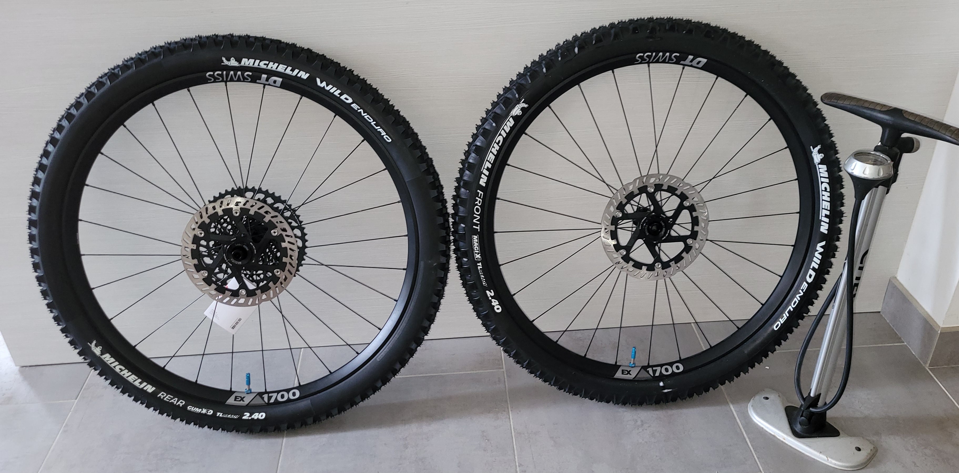

I was concerned by the fact I do not have a air compressor to set the tires on their rims seat.
I used some dish soap and inflated the wheels with a classic hand pump.
The tires seat just below 2 bar, i inflated to 3 kg. I will check tomorow if they leak.
Finally, the most difficult was to mount the tires on the rims :rolleyes: 😀
You need to rotate the tyres to that the logos line up with the ones on the wheels!!
Looks like it's all coming together though - bet you can't wait to have it out on the trails!
I mount the rear first and did'nt mind the logos. I will redo like the front (y)

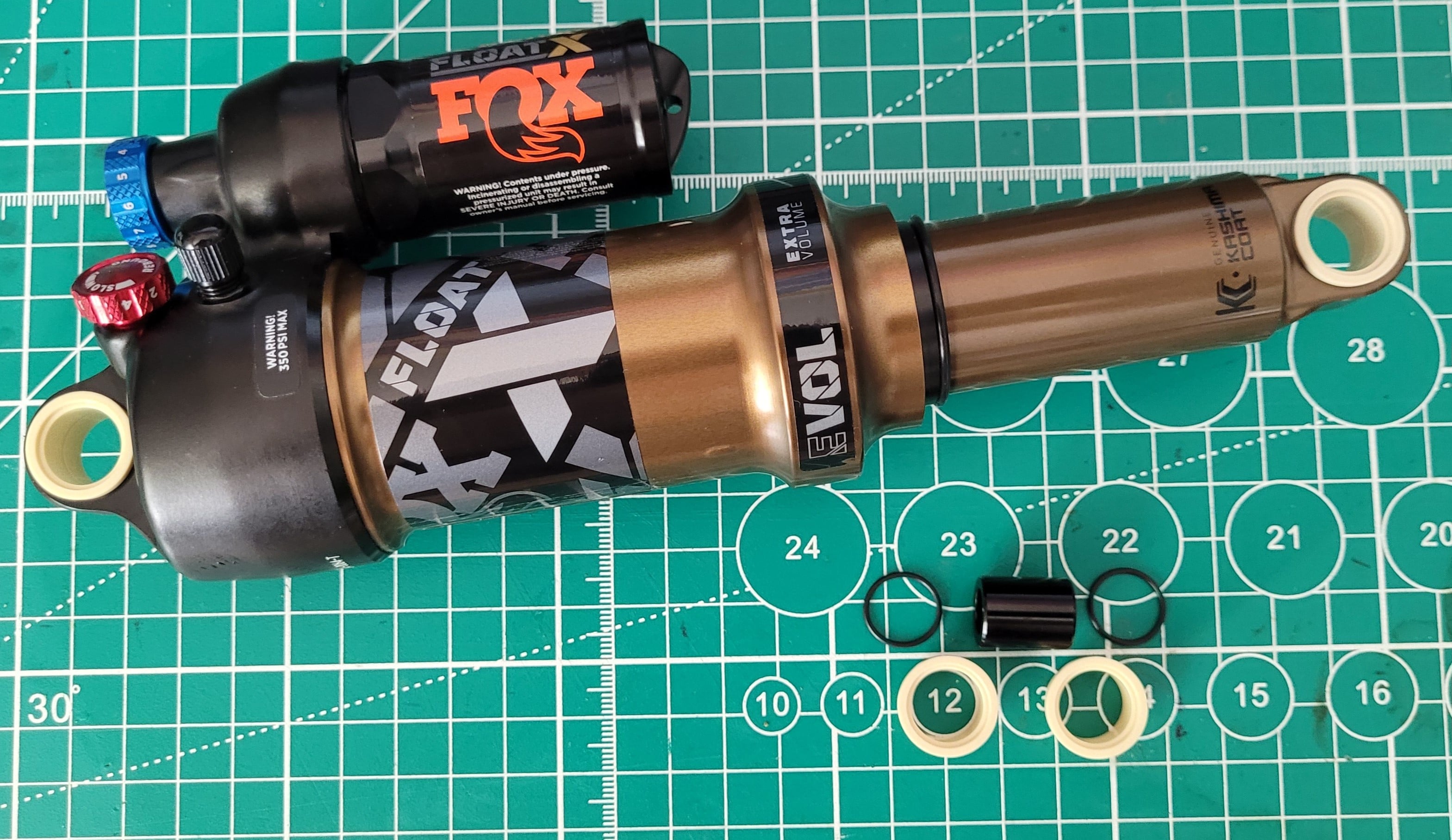

Waiting for some parts, dropper seat post, 32mm spacer, etc. :rolleyes:
I checked the motor fit with the wiring. (y)

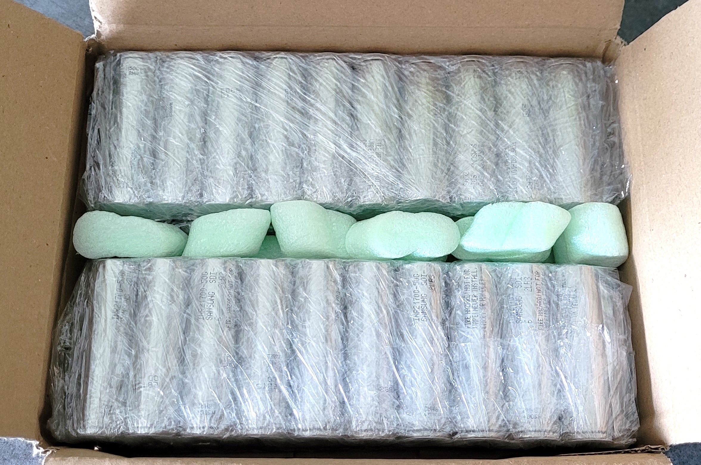

I found these cells for the battery in Netherland and waiting for too:
Manufactured in South Corea, for an abnadonned car project. 😎
Wait and see!

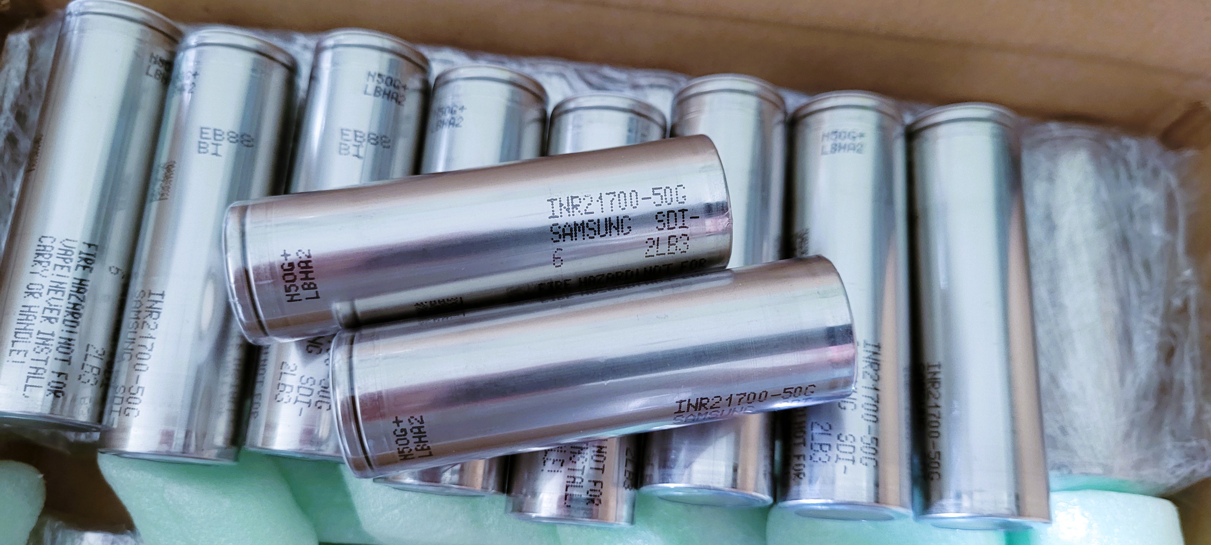

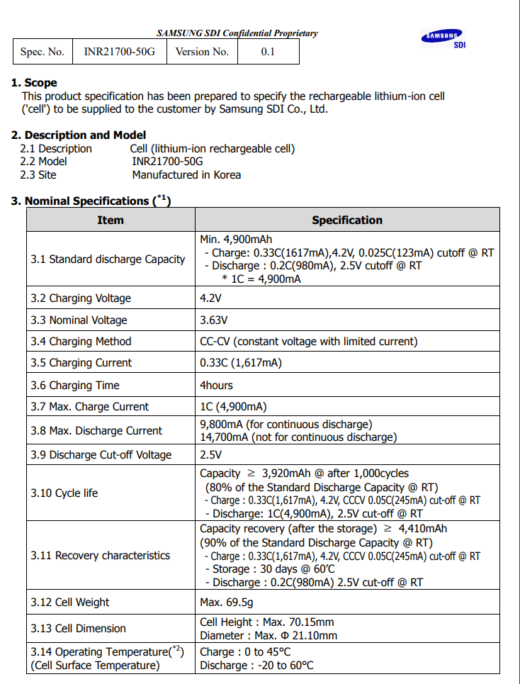

Today deliery:
SAMSUNG INR21700-50G 🤪

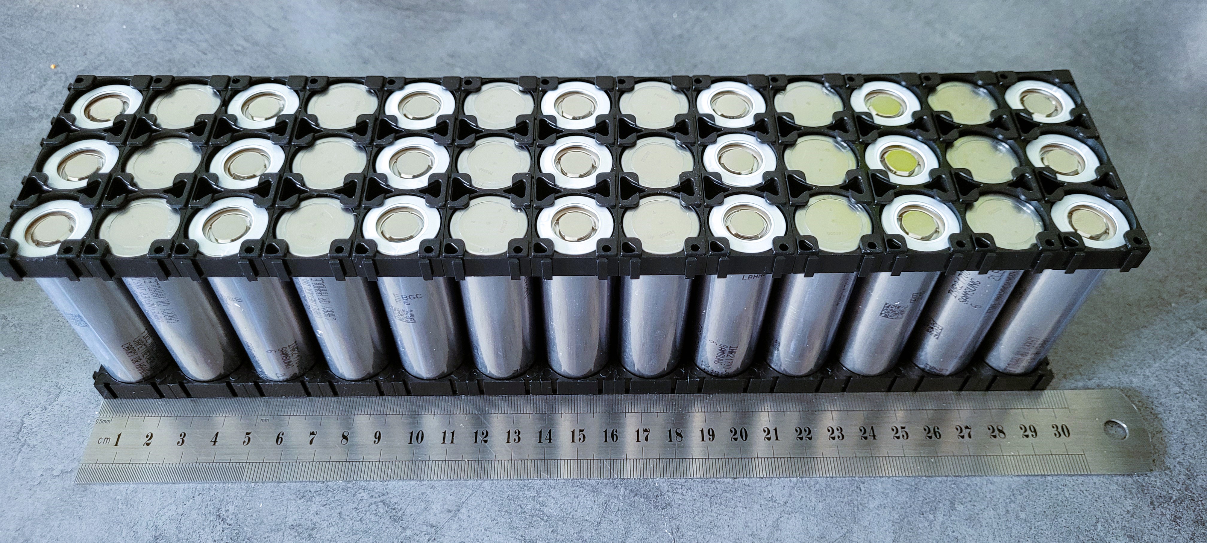

Cells support:
TO BE FOLLOWED... 😉
