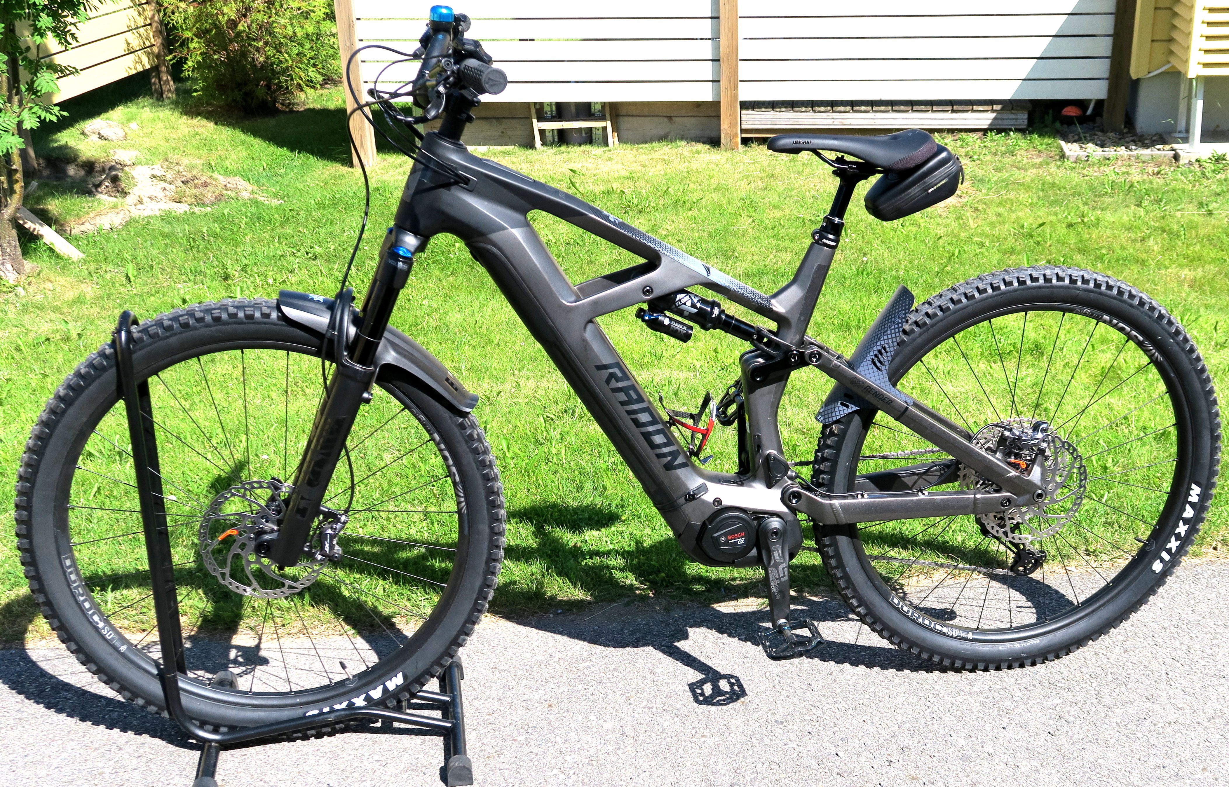

For those wondering how the Deft 9.0 in Moormother colour scheme looks in the wild, here's a shot.
Unboxed, tubeless'd, slapped extra grease on the bearings, and also replaced the brake caliper bolts with m6x40 and m6x35's.
Niille, jotka miettivät, miltä Deft 9.0 Moormotherin värimaailmassa näyttää luonnossa, tässä on kuva.
Purettu laatikosta, tubeless-malli, laitoin laakereihin ylimääräistä rasvaa ja jarrusatulan pultit vaihdettu M6x40- ja M6x35-ruuveihin.
Minulla Render 9.0 2025 sama väri. Päivitetty uudella 50mm,nousevalla tangolla. Fox etu/ taka vaimennin ,molemmista phaseria pienennetty löytyi alku herkkyyttä toimintaan. Continental Kryptotal re rengas 2.6 leveä .Maxis rengas seos takana kuluu nopeasti.Takuu toimii sain uuden XT vaihde vivuston.Pyörä sopii säädettynä nyt ,tuntuu omalta.
Hi. You don't have headset cable routing? Did you do that yourself? Do you know how much the bike weighs?

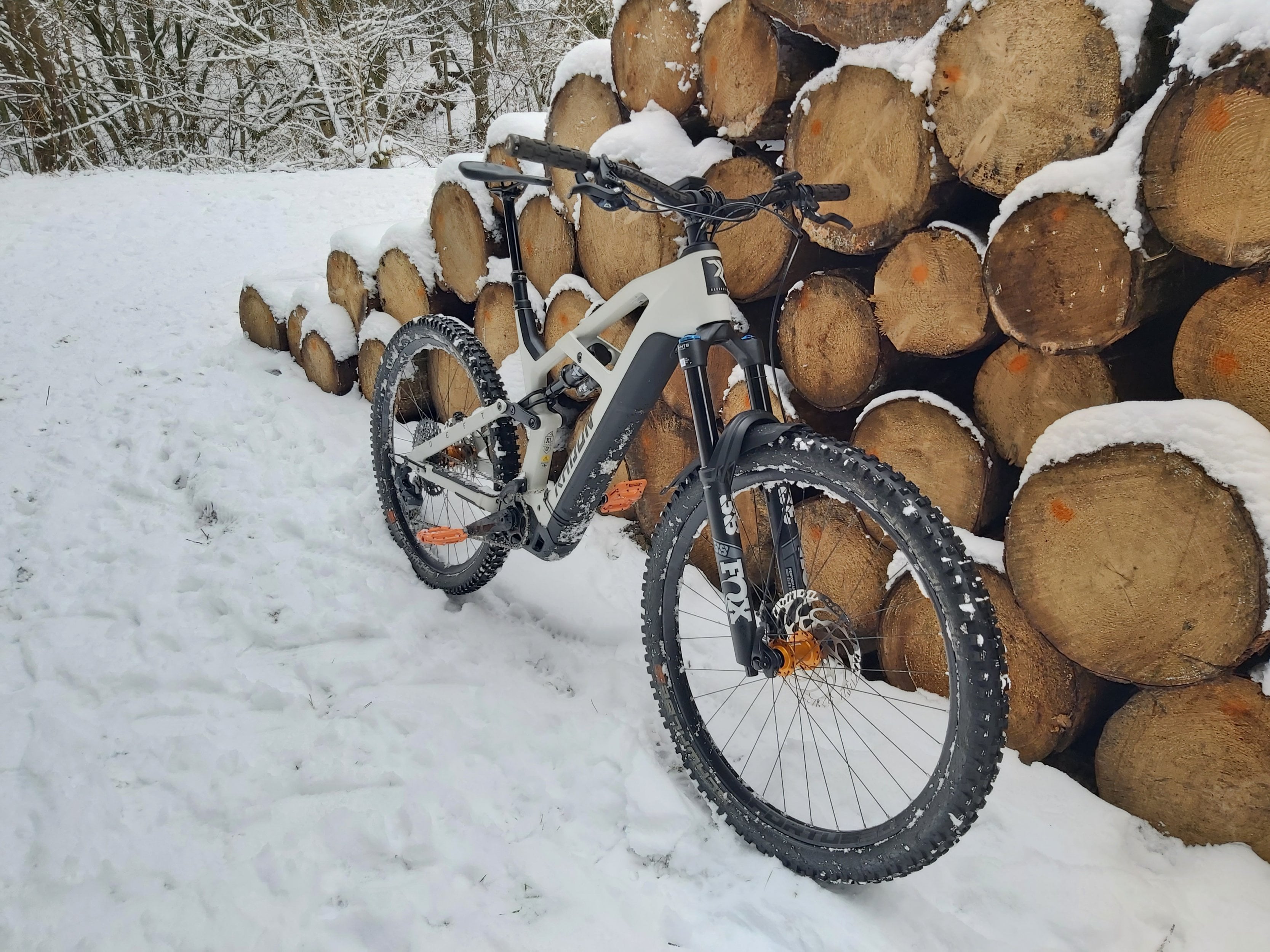

A little over a year has passed since my initial post on my Deft 9.0 750, and decided on throwing a quick status - for what it's worth.
Main change i did very early was to order a new set of wheels. The Ringlé wheels that they use at assembly, were absolutely atrocious! The spokes kept dinging loose, warping the rim, requiring constant retentioning and trueing. I went with a pair of DT Swiss HX 1700's, and there have been zero issues.
Also with the bike itself, there have been no real issues. Once, it developed a creaking sound, and it turned out to be the vertically sitting link between the rear shock and the link arm. A bit of grease eliminated the sound.
What else? Swapped the seat and grips, mainly coz of subjective taste and feel, and acquired a pair of Schwalbe ISP's for winter fun.
To summarize, it's been happy times with the Deft. It's been put through mud, water, dust, jumps, rocks, snow, climbs and descents. Would buy again, but not with the original wheels.
