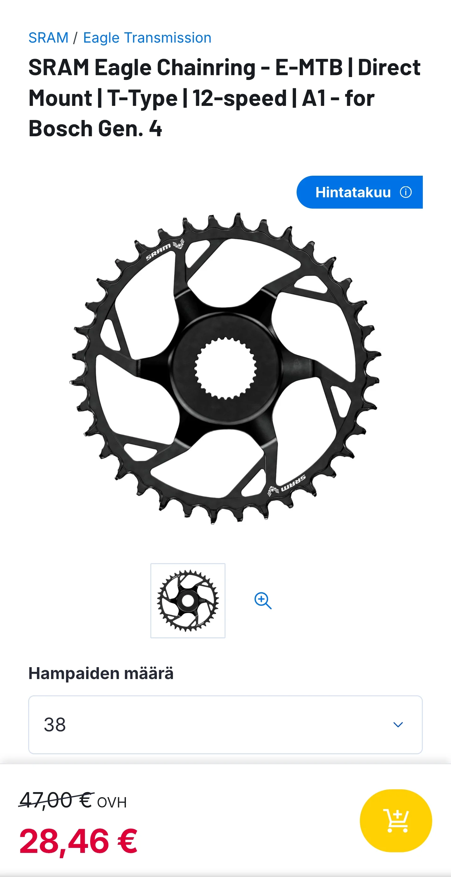

I installed this on my bosch gen5, and there is zero broblems.
